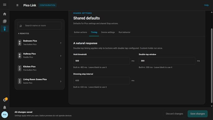

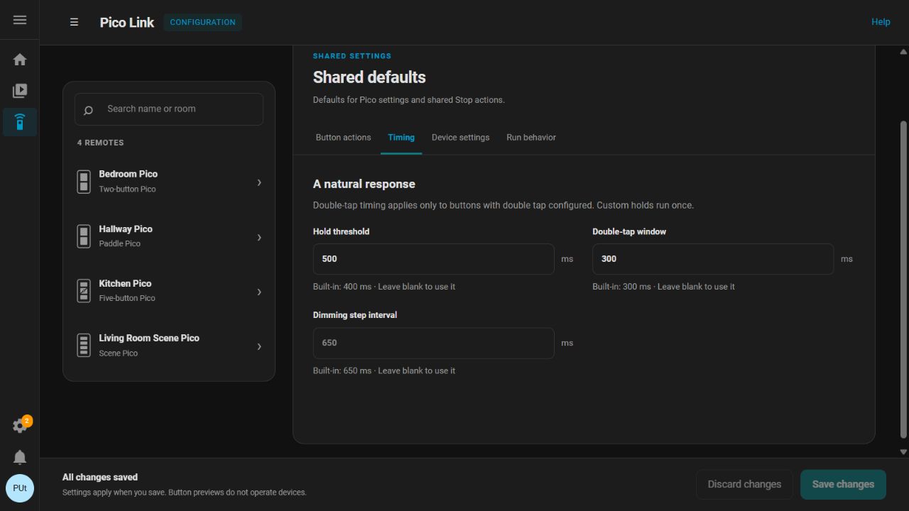

  • Configurable double-tap timing, with a 300 ms default. Only buttons with double-tap actions get the additional single-tap delay.
  • Shared Stop/middle-button actions, with separate defaults for tap, hold, and double tap that each Pico can opt into.

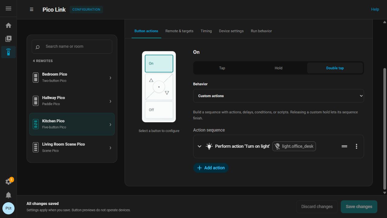

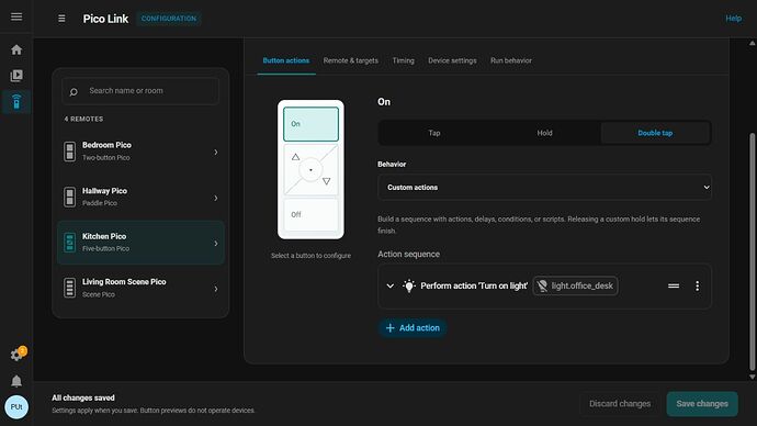

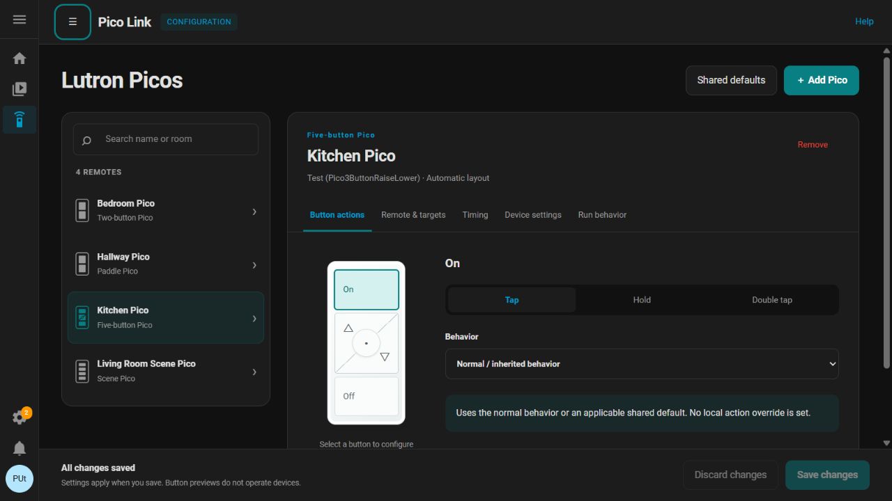

The new UI
The beta adds a dedicated Pico Link workspace inside Home Assistant. It has a searchable remote list, an Add Pico button, shared defaults, and a visual button editor matching each supported Pico layout.
Select a remote, assign what it controls, then select a button and its Tap, Hold, or Double tap gesture. Separate tabs cover timing, device settings, and run behavior.
These screenshots use simulated remotes and sample settings.
Home Assistant’s script engine
The beta also runs custom sequences through Home Assistant’s script engine. Button actions can include conditions, delays, templates, loops, waits, and calls to existing scripts, using Home Assistant’s action editor.
Run behavior is configurable per Pico: single, restart, queued, or parallel. The beta defaults to single, so another custom gesture on that Pico is ignored while its current sequence is running. Choose restart when the newest gesture should take over, or parallel when overlapping sequences are wanted.
Shared defaults let you reuse timing and control settings, while individual Picos can override them. Shared Stop actions remain an explicit choice for each gesture.
