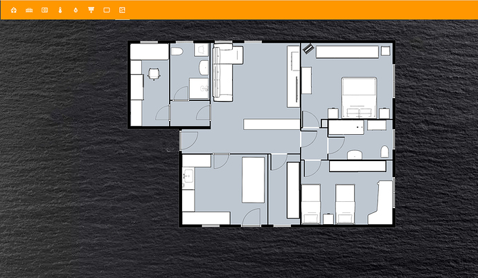

Hi, I would like to put in lovelace a house map with a transparent outline.
I tried to insert it as picture-elements but what I get is what I show below.
I have this:
I want this:

Assuming your png has a transparent background, all you need to do is set the card background to transparent. You can do this with a theme (all card backgrounds will be affected) or with card-mod (individual card background control).
Thanks, this code work perfectly

Last answer is no longer valid and is now:
type: picture-elements
elements: []
image: /local/YourImage.png
card_mod:
  style: |
    ha-card {
      --ha-card-background: rgba(, 0, 0, 0);
Unsurprising considering it was 4 years ago. Thanks for the update though.
Your welcome, used the outcome myself so thought share the update :wink:
