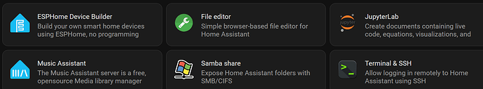

What are the add-ons you have installed?
And I actually just uninstalled some add-ons I am no longer using. Google custom backup addon, Mosquitto, those were there when these messages occurred. I checked all the addon logs but found no activity at the specific times.
