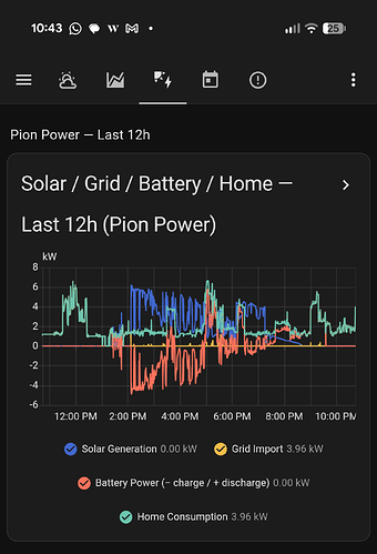

  • Monitoring: battery SOC, PV/grid/load/battery power, daily energy (Energy Dashboard–ready), pulled from the inverter's own signals.
