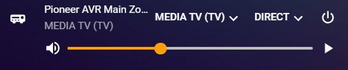

I couldn’t find the sources at first but found them in media_player.pioneer_avr_main_zone along with the sound modes. Did a quick mini-media-player card:
type: custom:mini-media-player
entity: media_player.pioneer_avr_main_zone
group: false
volume_stateless: false
toggle_power: true
sound_mode: full
source: full
hide:
  sound_mode: false
