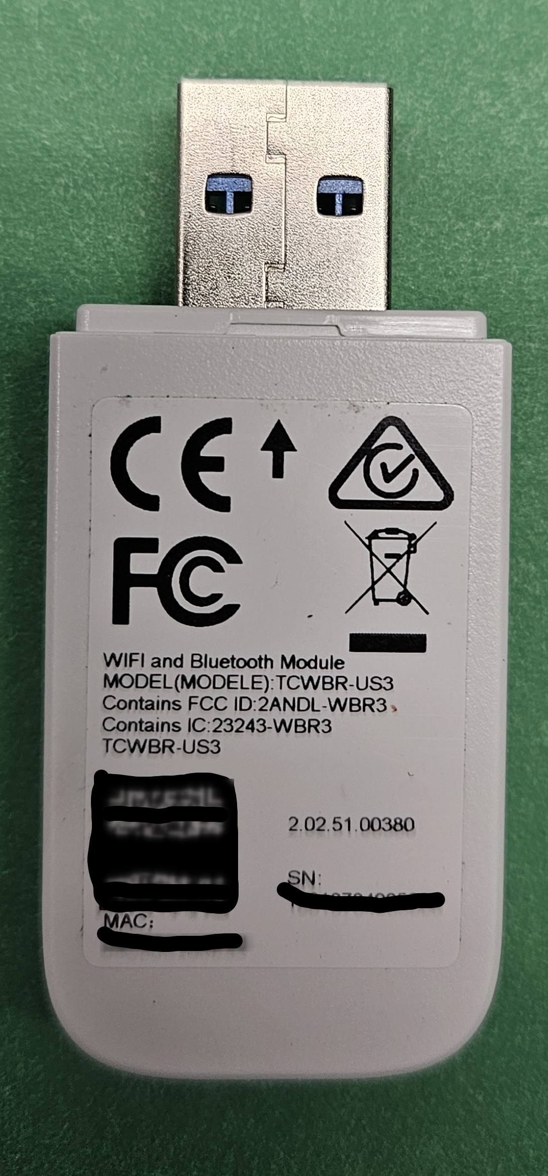

I am going to try to take a look at the logic. My feeling is they did change the protocol. @badfrogg mentioned his came with the TCWBRCU1 dongle (TCWBRCU1 datasheet-Tuya Developer Platform-Tuya Developer)
I am guessing @Refuge also came with this dongle. Mine( and I’m assuming yours?) came with the TCWBR-US3 (TCWBR-US3 Adapter Board Datasheet-Tuya Developer Platform-Tuya Developer)
it seems this change in dongles was pretty recent as the replacement modules for wyt series listed on the pioneer website are still the TCWBRCU1 model.
Wow, that’s crazy. I assumed I had the TCWBRCU1. I haven’t checked what I do have, but I bought it in November 2025 so it’s probably the TCWBR-US3, as you say. I was already extremely lucky I read this forum before plugging the SLWF-01pro into it – because who in their right mind changes the pinout of a USB-A-shaped socket to be dangerously incompatible with a standard USB-A device?!

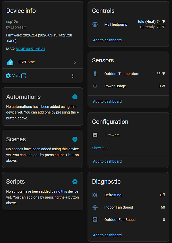

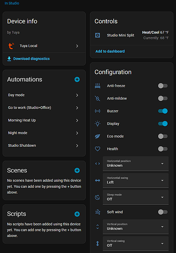

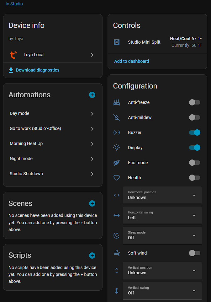

I just got my SLWF-01 flashed and installed and very excited to have it working. I’m just wondering what to add to the Yaml to get all the other options like direct horizontal and vertical louver control as well as Eco, sleep, display and buzzer control, or really all of the control capabilities added. I can see it all listed in mikesmitty’s source code but don’t know how to format it to include in the Yaml.
the attached pictures show the Local Tuya integration with all the options, and the ESP home integration which has very basic control.

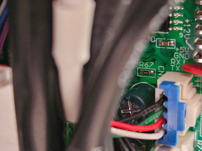

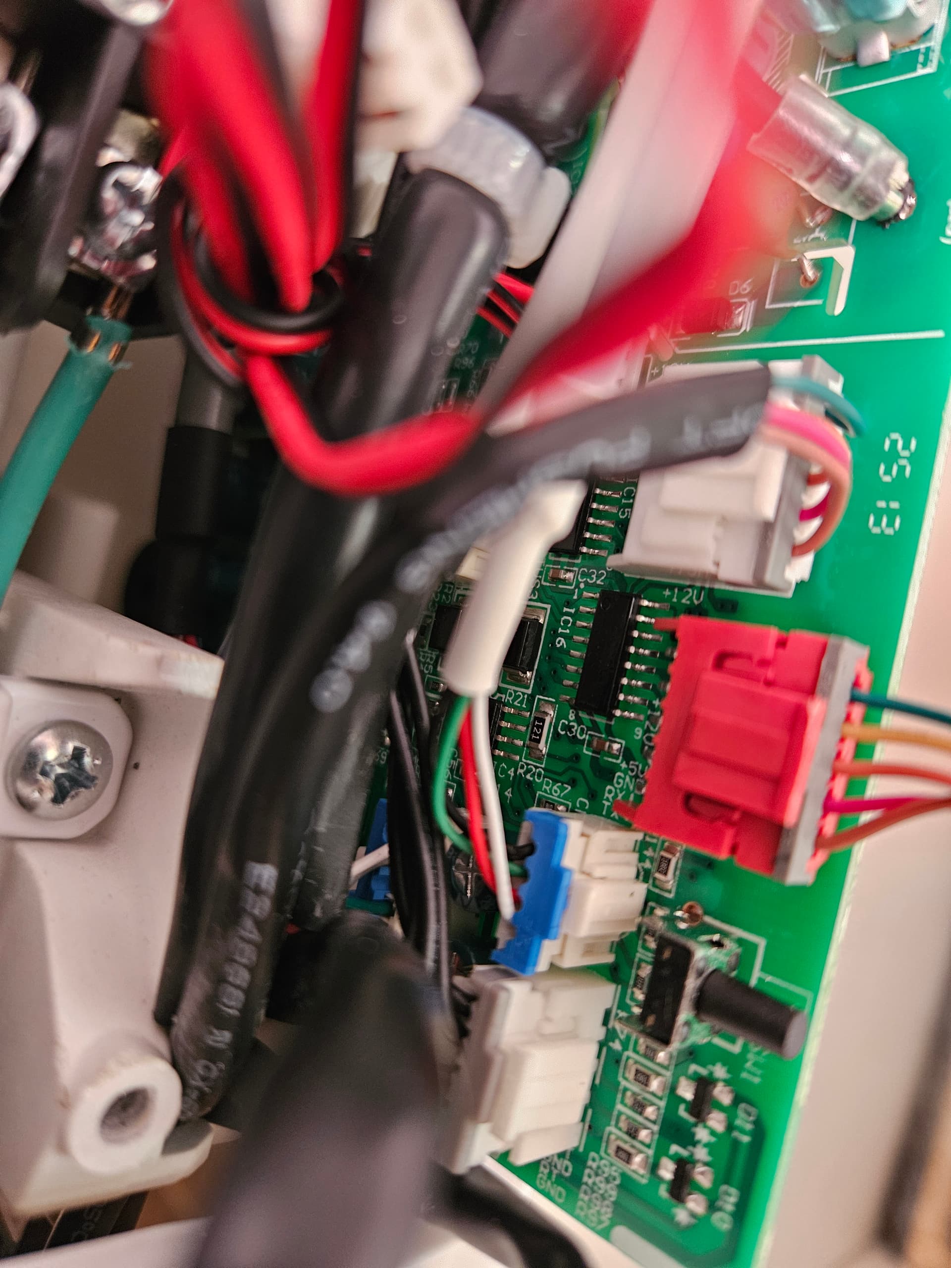

So on my WT009GLSI25HLH, it definitely uses the TCWBR-US3. I have a SLWF-01pro to flash, once I get the wiring pinned right. Can anyone give me a tip to separate the white and blue connector from the PCB board? Is there a catch/latch that I have to push on so I can release it and then re-pin it.
You need to remove the blue plastic cover. It prevents you from pushing in the white handle.
