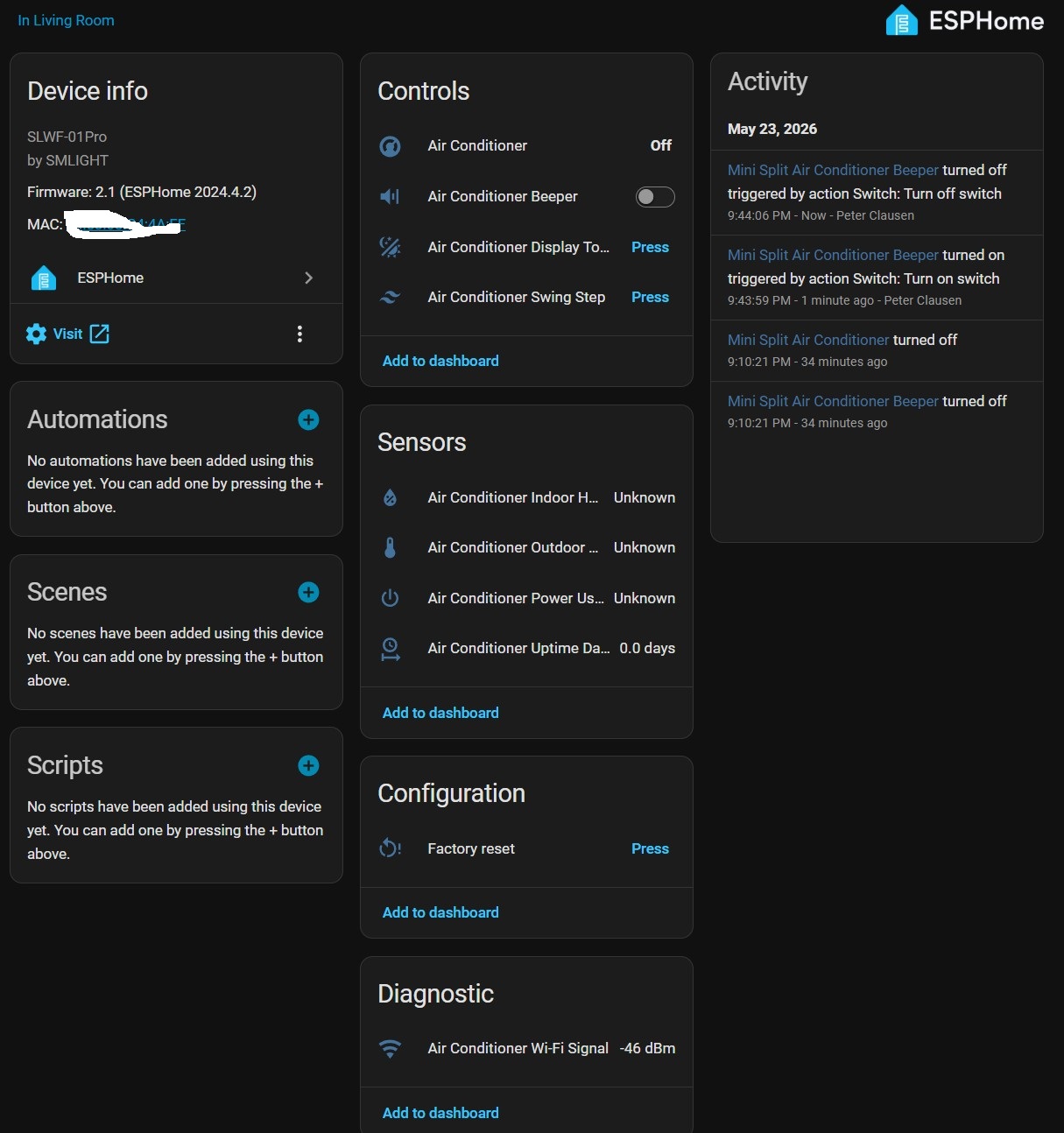

ESPHome discovered it and I see the following:
As you can see, its running ESPHome 2024.4.2.

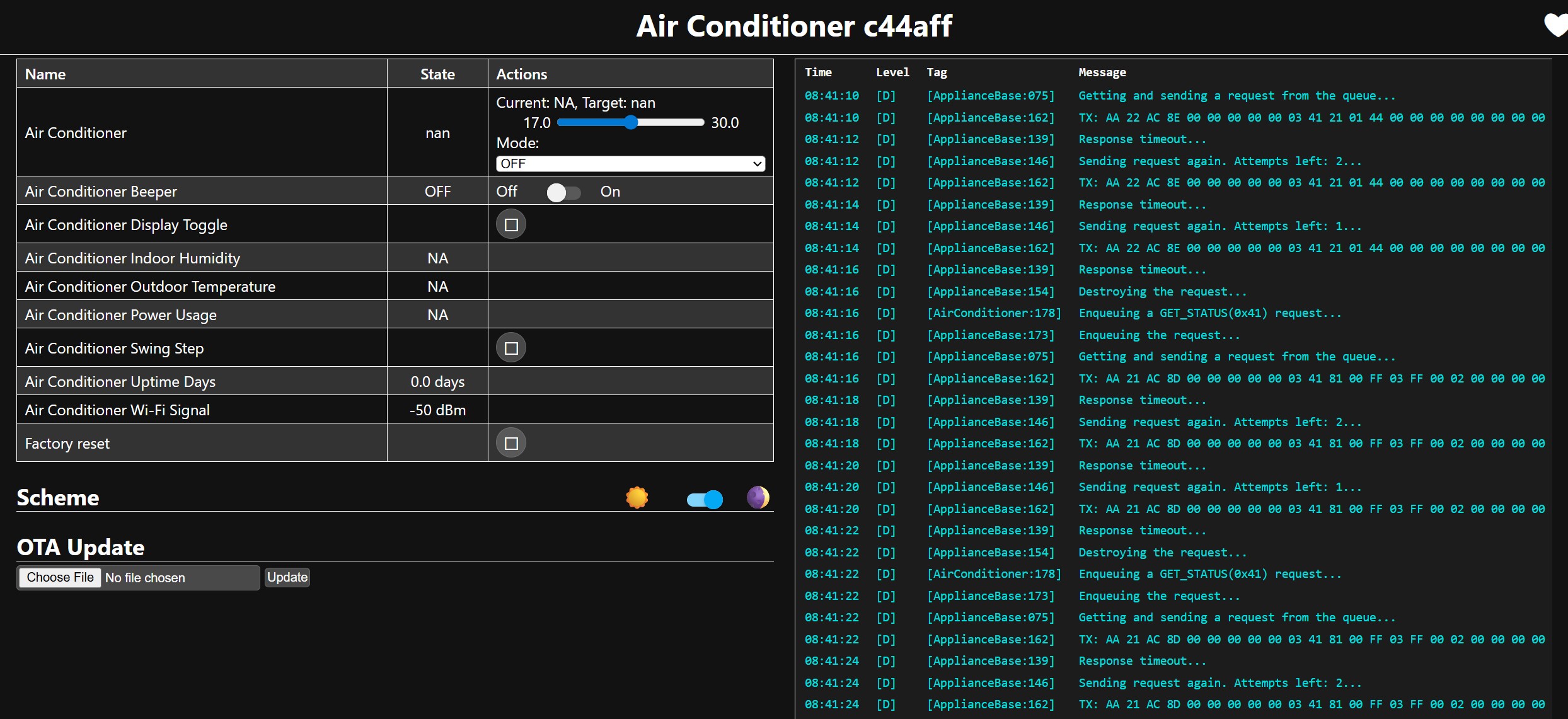

My issue is that none of the controls work. Do I need to update the firmware to get it going? What about a yml file, or is this supposed to just work out of the box?
As far as updating the firmware, looking at the instructions here:
They talk about connecting the SLWF-01Pro to a Type C plug. I'm confused since the dongle has a USB 2.0, same as the old laptop I was planning to use to flash it with.
So do I need a USB 2.0 to USB C cable and use a computer with a USB C port to flash this thing?

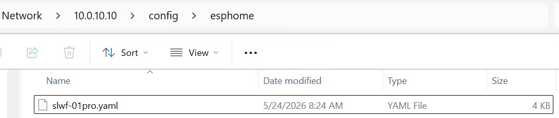

Installed Samba share and then modifed and copied the greenbean yaml file here:
I also realized I can point a browser directly to the dongle and was then able to update the firmware there to version 2.3 (latest I could find online).

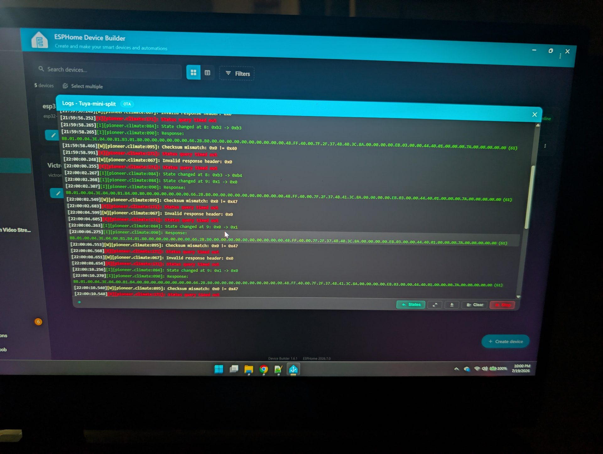

But I still get noting but handshake errors:
Also, ESPHome still shown I'm running the 2.1 firmware. I'll keep digging, this is all new to me, having only just installed HA less than a week ago.

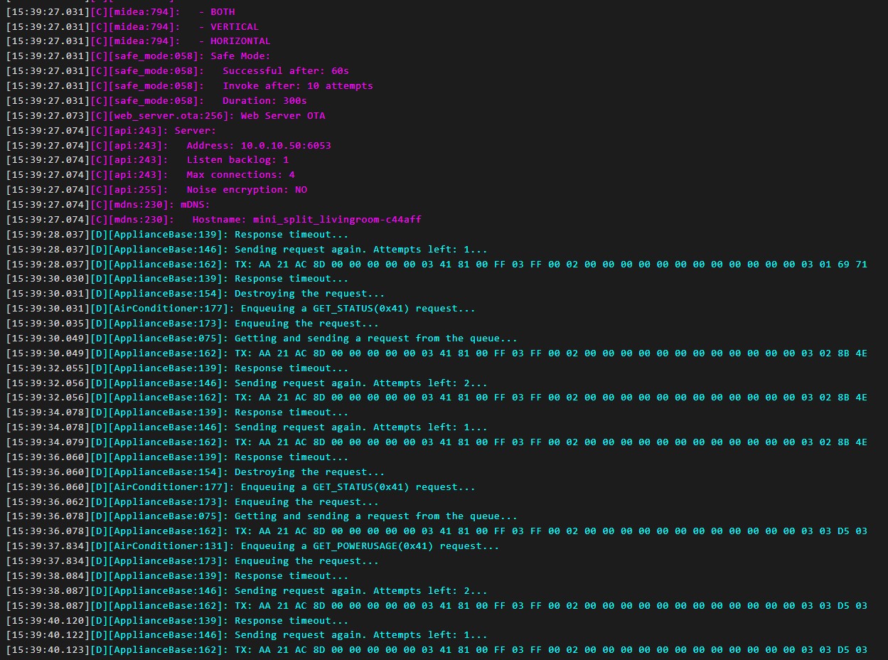

Hooked up the slwp-01pro to my htpc using a c-type cable (didn't realize there's a c-type connector onboard. Was then able to update the firmware to 2.4 and it took and shows as such in HA ESPHome now:
Was also able to tweak the yaml so that it could compile. Had to get rid of the deprecated:
platform: ESP8266
And instead use:
esp8266:
board: esp12e
Also had to add:
use_address: 10.0.10.50 (the static IP I assigned to the dongle)
Still would not communicate, so I changed the baudrate to 115200. But alas, still no connection.

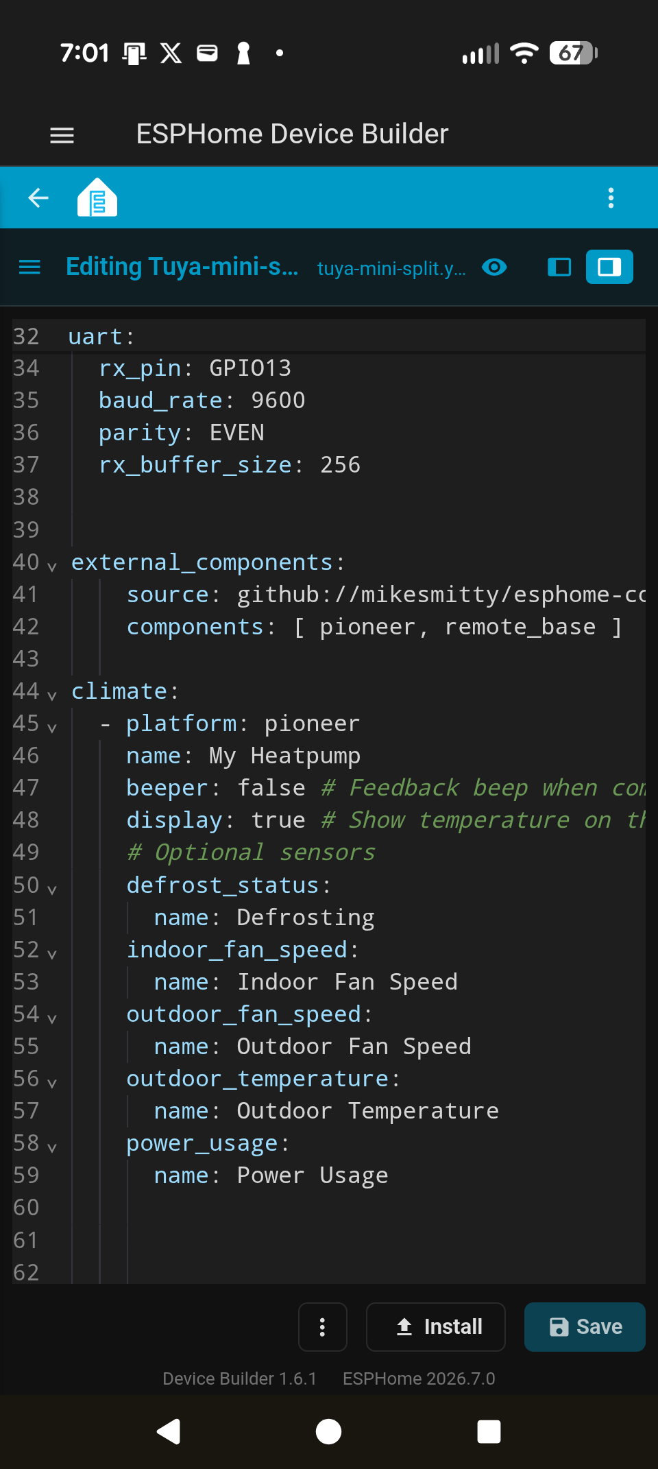

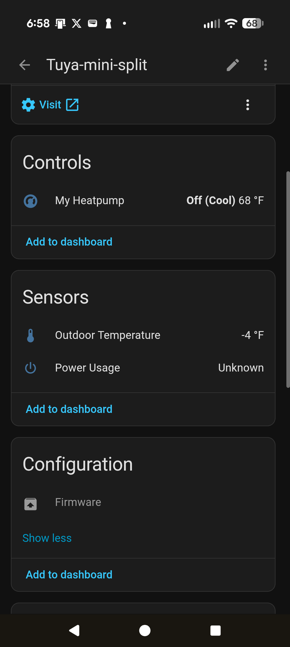

I let my my air conditioner and ESP home sit overnight and I came back to it today to realize the errors have gone away and the system is working and responding to climate controls but it’s not displaying the correct temperature or the status of fan speed along with outdoor temperature is wrong and it’s not showing power usage
I’m using Mike Smitty’s yaml configuration. Is there anything I can change to fix some of the sensors?
This is the yaml that I’m using currently

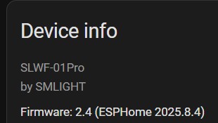

Ok I repinned the usb connector, with the new module I still get:
INFO ESPHome 2026.8.0
INFO Loaded validated config cache for pioneer-minisplit.yaml, skipping validation.
INFO Starting log output from 192.168.1.135 using esphome API
INFO Successfully resolved pioneer-minisplit @ 192.168.1.135 in 0.001s
INFO Successfully connected to pioneer-minisplit @ 192.168.1.135 in 0.023s
INFO Successful handshake with pioneer-minisplit @ 192.168.1.135 in 2.626s

Still get:
[22:30:35.398][I][app:151]: ESPHome version 2026.8.0 compiled on 2026-08-20 22:28:22 -0400
[22:30:35.399][C][logger:223]: Logger:
[22:30:35.399][C][logger:223]:   Max Level: DEBUG
[22:30:35.399][C][logger:223]:   Initial Level: DEBUG
[22:30:35.399][C][logger:230]:   Log Baud Rate: 0
[22:30:35.399][C][logger:230]:   Hardware UART: NONE
[22:30:35.399][C][uart.arduino_esp8266:140]: UART Bus:
[22:30:35.399][C][uart.arduino_esp8266:131]:   TX Pin: GPIO3
[22:30:35.399][C][uart.arduino_esp8266:131]:   RX Pin: GPIO1
[22:30:35.399][C][uart.arduino_esp8266:144]:   RX Buffer Size: 256
[22:30:35.399][C][uart.arduino_esp8266:146]:   Baud Rate: 9600 baud
[22:30:35.399][C][uart.arduino_esp8266:146]:   Data Bits: 8
[22:30:35.399][C][uart.arduino_esp8266:146]:   Parity: EVEN
[22:30:35.399][C][uart.arduino_esp8266:146]:   Stop bits: 1
[22:30:35.399][C][uart.arduino_esp8266:155]:   Using software serial
[22:30:35.399][C][uart.arduino_esp8266:155]:   Wake on data RX: ENABLED
[22:30:35.408][C][pioneer_minisplit:062]: Pioneer Mini Split:
[22:30:35.408][C][pioneer_minisplit:063]:   Protocol: 9600 8E1 (Even parity), XOR checksum
[22:30:35.408][C][captive_portal:142]: Captive Portal:
[22:30:35.460][C][wifi:1565]: WiFi:
[22:30:35.460][C][wifi:1565]:   Connected: YES
[22:30:35.460][C][wifi:1268]:   IP Address: 192.168.1.135
[22:30:35.460][C][wifi:1279]:   SSID: 'OpenWrt2.4'
[22:30:35.460][C][wifi:1279]:   BSSID: C8:9E:43:E2:DB:36
[22:30:35.460][C][wifi:1279]:   Hostname: 'pioneer-minisplit'
[22:30:35.460][C][wifi:1279]:   Signal strength: -44 dB ▂▄▆█
[22:30:35.460][C][wifi:1279]:   Channel: 1
[22:30:35.461][C][esphome.ota:098]: Over-The-Air updates:
[22:30:35.461][C][esphome.ota:098]:   Address: pioneer-minisplit.local:8266
[22:30:35.461][C][esphome.ota:098]:   Version: 2
[22:30:35.461][C][safe_mode:058]: Safe Mode:
[22:30:35.461][C][safe_mode:058]:   Successful after: 60s
[22:30:35.461][C][safe_mode:058]:   Invoke after: 10 attempts
[22:30:35.461][C][safe_mode:058]:   Duration: 300s
[22:30:35.463][C][web_server.ota:256]: Web Server OTA
[22:30:35.480][C][api:271]: Server:
[22:30:35.480][C][api:271]:   Address: pioneer-minisplit.local:6053
[22:30:35.480][C][api:271]:   Listen backlog: 1
[22:30:35.480][C][api:271]:   Max connections: 4
[22:30:35.480][C][api:278]:   Noise encryption: YES
[22:30:35.491][C][mdns:259]: mDNS:
[22:30:35.491][C][mdns:259]:   Hostname: pioneer-minisplit
[22:30:36.029][D][pioneer_minisplit:145]: Sent heartbeat
[22:31:20.952][D][pioneer_minisplit:145]: Sent heartbeat
[22:31:23.812][I][safe_mode:154]: Boot seems successful; resetting boot loop counter
[22:31:23.812][D][pioneer_minisplit:145]: Sent heartbeat
[22:31:39.075][D][pioneer_minisplit:145]: Sent heartbeat
[22:31:41.826][W][pioneer_minisplit:636]: Ignoring command - waiting for initial state sync from HVAC
[22:31:42.125][D][pioneer_minisplit:145]: Sent heartbeat
I’ve tried swapping the rx and tx pins in the yaml but no luck there either.
Maybe I should mention my minisplit actually used the TCWBR-US3, so the tuya control iirc.

[23:02:11.708][D][sniffer:050]: RX: A5 01 01 21 BC 00 00 42 EF FA 0C 0C 00 01 01 00 02 00 00 08 34 00 03 00 00 09 A6 00 05 00 00 0C 00 00 0D 01 00 0E 01 00 11 08 00 12 01 00 DF 00 00 C9 00
[23:02:11.708][E][uart:014]: Reading from UART timed out at byte 0!
[23:02:11.708][D][sniffer:050]: RX: 00 17 00 00 1E 01 02 27 00 00 00 47 01 48 01
[23:02:11.902][D][sniffer:050]: RX: A5 01 01 21 BD 00 00 5B 52 2B 0C 0C 00 22 00 00 25 01 00 27 00 00 2D 00 00 35 00 00 38 00 00 5C 00 00 07 6C 00 39 13 02 03 07 08 09 0B 0C 0D 15 17 1F 21
[23:02:11.902][E][uart:014]: Reading from UART timed out at byte 0!
[23:02:11.902][D][sniffer:050]: RX: 92 12 49 69 09 8A 02 5E 00 00 60 00 00 0A F0 00 64 00 00 00 00 00 65 00 00 00 00 00 72 00 00 00 00 00 73 01 00 74 06
[23:02:12.261][E][uart:014]: Reading from UART timed out at byte 0!
[23:02:12.261][D][sniffer:050]: RX: A5 01 01 21 BE 00 00 2D 4C D5 0C 0C 00 95 00 00 00 00 00 A4 00 00 BD 00 00 00 00 00 BE 00 00 00 00 00 BF 00 00 00 00 00 C0 00 00 00 00
[23:02:12.262][E][uart:014]: Reading from UART timed out at byte 0!
[23:02:12.264][D][sniffer:050]: RX: A5 01 01 21 BF 00 00 17 C1 93 0C 0C 00 FA 00 07 3B 3B 3B 3B 3B 3B 3B
[23:02:12.467][E][uart:014]: Reading from UART timed out at byte 0!
[23:02:12.468][D][sniffer:050]: RX: A5 01 01 21 C0 00 00 17 01 6F 0C 0C 00 FB 00 07 3B 3B 3B 3B 3B 3B 3B
[23:02:12.722][D][sniffer:050]: RX: A5 01 01 21 C1 00 00 44 C9 B3 0C 0C 01 47 00 02 20 01 02 21 00 00 06 40 02 22 00 00 0C 1C 02 23 00 01 3B 02 24 00 02 25 00 00 7B 00 00 84 01 00 8C 00 00
[23:02:12.722][E][uart:014]: Reading from UART timed out at byte 0!
[23:02:12.722][D][sniffer:050]: RX: 00 46 00 A0 00 00 D1 00 00 D4 00 00 D5 00 00 D6 00
[23:02:12.941][E][uart:014]: Reading from UART timed out at byte 0!
[23:02:12.941][D][sniffer:050]: RX: A5 01 01 21 C2 00 00 12 2C 7D 0C 0C 00 D7 00 00 00 00
[23:02:18.035][E][uart:014]: Reading from UART timed out at byte 0!
[23:02:18.041][D][sniffer:050]: RX: A5 01 F5 00 05 00 10 00 00 A1 02 00 01 AA D0 DB 5A
[23:02:18.240][E][uart:014]: Reading from UART timed out at byte 0!
[23:02:18.240][D][sniffer:050]: RX: A5 01 F6 00 05 00 10 00 00 A1 01 00 01 3C AD E7 5A
[23:02:18.492][E][uart:014]: Reading from UART timed out at byte 0!
[23:02:18.493][D][sniffer:050]: RX: A5 01 F5 00 05 20 10 00 00 A1 02 00 01 AA 77 27 5A
[23:02:18.650][E][uart:014]: Reading from UART timed out at byte 0!
[23:02:18.654][D][sniffer:050]: RX: A5 01 F6 00 05 20 10 00 00 A1 01 00 01 3C 0A 1B 5A
[23:02:18.855][E][uart:014]: Reading from UART timed out at byte 0!
[23:02:18.855][D][sniffer:050]: RX: A5 01 F7 00 05 00 10 00 00 A1 04 00 01 F0 0A 17 5A

It looks like there might be an issue with decoding the messages on Mike Smitty’s code. I’m not sure how to troubleshoot this if there is something obviously wrong with my setup. I am using a SLWF-01PRO. Here is my log:
INFO ESPHome 2026.8.2
INFO Loaded validated config cache for mini-split.yaml, skipping validation.
INFO Starting log output from 10.0.20.47 using esphome API
INFO Successfully resolved pioneerwyt-ac @ 10.0.20.47 in 0.000s
INFO Successfully connected to pioneerwyt-ac @ 10.0.20.47 in 11.195s
INFO Successful handshake with pioneerwyt-ac @ 10.0.20.47 in 0.044s
[21:11:26.868][I][app:151]: ESPHome version 2026.8.2 compiled on 2026-09-15 21:09:41 -0700
[21:11:26.868][C][logger:223]: Logger:
[21:11:26.868][C][logger:223]:   Max Level: DEBUG
[21:11:26.868][C][logger:223]:   Initial Level: DEBUG
[21:11:26.868][C][logger:230]:   Log Baud Rate: 115200
[21:11:26.868][C][logger:230]:   Hardware UART: UART0
[21:11:26.934][C][uart.arduino_esp8266:140]: UART Bus:
[21:11:26.934][C][uart.arduino_esp8266:131]:   TX Pin: GPIO12
[21:11:26.934][C][uart.arduino_esp8266:131]:   RX Pin: GPIO14
[21:11:26.935][C][uart.arduino_esp8266:144]:   RX Buffer Size: 256
[21:11:26.935][C][uart.arduino_esp8266:146]:   Baud Rate: 9600 baud
[21:11:26.935][C][uart.arduino_esp8266:146]:   Data Bits: 8
[21:11:26.935][C][uart.arduino_esp8266:146]:   Parity: EVEN
[21:11:26.935][C][uart.arduino_esp8266:146]:   Stop bits: 1
[21:11:26.935][C][uart.arduino_esp8266:155]:   Using software serial
[21:11:26.935][C][uart.arduino_esp8266:155]:   Wake on data RX: ENABLED
[21:11:26.958][C][pioneer.climate:458]: WytClimate 'My Heatpump'
[21:11:26.966][C][captive_portal:142]: Captive Portal:
[21:11:27.017][C][wifi:1565]: WiFi:
[21:11:27.017][C][wifi:1565]:   Local MAC: *****
[21:11:27.017][C][wifi:1565]:   Connected: YES
[21:11:27.018][C][wifi:1268]:   IP Address: 10.0.20.47
[21:11:27.018][C][wifi:1279]:   SSID: '****'
[21:11:27.018][C][wifi:1279]:   BSSID: ****
[21:11:27.018][C][wifi:1279]:   Hostname: 'pioneerwyt-ac'
[21:11:27.018][C][wifi:1279]:   Signal strength: -69 dB ▂▄▆█
[21:11:27.018][C][wifi:1279]:   Channel: 6
[21:11:27.018][C][wifi:1279]:   Subnet: 255.255.255.0
[21:11:27.018][C][wifi:1279]:   Gateway: 10.0.20.1
[21:11:27.018][C][wifi:1279]:   DNS1: 10.0.20.1
[21:11:27.018][C][wifi:1279]:   DNS2: 0.0.0.0
[21:11:27.019][C][web_server:418]: Web Server:
[21:11:27.019][C][web_server:418]:   Address: pioneerwyt-ac.local:80
[21:11:27.020][C][esphome.ota:098]: Over-The-Air updates:
[21:11:27.020][C][esphome.ota:098]:   Address: pioneerwyt-ac.local:8266
[21:11:27.020][C][esphome.ota:098]:   Version: 2
[21:11:27.035][C][safe_mode:058]: Safe Mode:
[21:11:27.035][C][safe_mode:058]:   Successful after: 60s
[21:11:27.035][C][safe_mode:058]:   Invoke after: 10 attempts
[21:11:27.035][C][safe_mode:058]:   Duration: 300s
[21:11:27.036][C][web_server.ota:256]: Web Server OTA
[21:11:27.045][C][api:271]: Server:
[21:11:27.045][C][api:271]:   Address: pioneerwyt-ac.local:6053
[21:11:27.045][C][api:271]:   Listen backlog: 1
[21:11:27.045][C][api:271]:   Max connections: 4
[21:11:27.068][C][api:283]:   Noise encryption: NO
[21:11:27.078][C][mdns:259]: mDNS:
[21:11:27.078][C][mdns:259]:   Hostname: pioneerwyt-ac
[21:11:27.166][D][uart_debug:157]: >>> "\xBB\x00\x01\x04\x02\x01\x00\xBD"
[21:11:27.294][W][pioneer.climate:067]: Invalid response header: 0x9e
[21:11:27.295][E][pioneer.climate:171]: Status query timed out
[21:11:27.295][D][uart_debug:157]: <<< "\x9Ef\x00\x00`\xF8x\x00\x00\x00x\x80\x00\x00\x00\x00\x00\x00\x00\x00\x80\x98\x00\x00`\x00\x00\x00\x00\x00\x00\x00\x00\x00\x80\x98\x86\x18\x00\x80`\x98\x86x\x00\x00\x00\x00\x00\x00`\x18\x00\x00`\x18\x1E\x80\x80\x00\x00\x98\x1E\x00\x00\x00\x00\x00\x00\x00\x00\x00`\xE0x"
[21:11:29.184][D][uart_debug:157]: >>> "\xBB\x00\x01\x04\x02\x01\x00\xBD"
[21:11:29.184][W][pioneer.climate:095]: Checksum mismatch: 0x0 != 0xec
[21:11:29.185][E][pioneer.climate:171]: Status query timed out
[21:11:29.578][D][uart_debug:157]: <<< "\xBB\x01\x00\x04>\x04\x00 \x84\x00\xE0\x00\x00\x00\x00\x00\x00x\x030\x00\x00\x00\x00\x00\x00\x00\x00\x00\x00x\xFFB\x00\x00())\x00\x00\x80\x00\x00\x00\x00t\x00\x00\x00D@\b\b\x00\x00z\x00\x00\x00\x00\x00"
[21:11:30.138][D][api:255]: Accept 10.0.20.2
[21:11:30.139][D][api.connection:2593]: Home Assistant 2026.9.2 (10.0.20.2): connected
[21:11:31.176][D][uart_debug:157]: >>> "\xBB\x00\x01\x04\x02\x01\x00\xBD"
[21:11:31.176][W][pioneer.climate:067]: Invalid response header: 0x0
[21:11:31.177][E][pioneer.climate:171]: Status query timed out
[21:11:31.602][D][uart_debug:157]: <<< "\x00\x00\x00\x000\x10\xCC\xBB\x01\x00\x04>\x04\x00 \x84\x00\xE0\x00\x00\x00\x00\x00\x00x\x030\x00\x00\x00\x00\x00\x00\x00\x00\x00\x00x\xFFB\x00\x00())\x00\x00\x80\x00\x00\x00\x00t\x00\x00\x00D@\b\b\x00\x00z\x00\x00\x00\x00\x00\x00\x00\x00\x000\x10\xCC"
[21:11:33.178][D][uart_debug:157]: >>> "\xBB\x00\x01\x04\x02\x01\x00\xBD"
[21:11:33.178][W][pioneer.climate:095]: Checksum mismatch: 0x0 != 0xec
[21:11:33.198][E][pioneer.climate:171]: Status query timed out
[21:11:33.653][D][uart_debug:157]: <<< "\xBB\x01\x00\x04>\x04\x00 \x84\x00\xE0\x00\x00\x00\x00\x00\x00x\x030\x00\x00\x00\x00\x00\x00\x00\x00\x00\x00x\xFFB\x00\x00())\x00\x00\x80\x00\x00\x00\x00t\x00\x00\x00D@\b\b\x00\x00z\x00\x00\x00\x00\x00"
[21:11:35.166][D][uart_debug:157]: >>> "\xBB\x00\x01\x04\x02\x01\x00\xBD"
[21:11:35.186][W][pioneer.climate:067]: Invalid response header: 0x0
[21:11:35.186][E][pioneer.climate:171]: Status query timed out
[21:11:35.296][D][uart_debug:157]: <<< "\x00\x00\x00\x000\x10\xCC\xBB\x01\x00\x04>\x04\x00 \x84\x00\xE0\x00\x00\x00\x00\x00\x00x\x030\x00\x00\x00\x00\x00\x00\x00\x00\x00\x00x\xFFB\x00\x00())\x00\x00\x80\x00\x00\x00\x00t\x00\x00\x00D@\b\b\x00\x00z\x00\x00\x00\x00\x00\x00\x00\x00\x000\x10\xCC"
[21:11:37.192][D][uart_debug:157]: >>> "\xBB\x00\x01\x04\x02\x01\x00\xBD"
[21:11:37.192][W][pioneer.climate:095]: Checksum mismatch: 0x0 != 0xec
[21:11:37.192][E][pioneer.climate:171]: Status query timed out
[21:11:37.702][D][uart_debug:157]: <<< "\xBB\x01\x00\x04>\x04\x00 \x84\x00\xE0\x00\x00\x00\x00\x00\x00x\x030\x00\x00\x00\x00\x00\x00\x00\x00\x00\x00x\xFFB\x00\x00())\x00\x00\x80\x00\x00\x00\x00t\x00\x00\x00D@\b\b\x00\x00z\x00\x00\x00\x00\x00"
[21:11:39.188][D][uart_debug:157]: >>> "\xBB\x00\x01\x04\x02\x01\x00\xBD"
[21:11:39.188][W][pioneer.climate:067]: Invalid response header: 0x0
[21:11:39.192][E][pioneer.climate:171]: Status query timed out
[21:11:39.731][D][uart_debug:157]: <<< "\x00\x00\x00\x000\x10\xCC\xBB\x01\x00\x04>\x04\x00 \x84\x00\xE0\x00\x00\x00\x00\x00\x00x\x030\x00\x00\x00\x00\x00\x00\x00\x00\x00\x00x\xFFB\x00\x00())\x00\x00\x80\x00\x00\x00\x00t\x00\x00\x00D@\b\b\x00\x00z\x00\x00\x00\x00\x00\x00\x00\x00\x000\x10\xCC"
[21:11:41.169][D][uart_debug:157]: >>> "\xBB\x00\x01\x04\x02\x01\x00\xBD"
[21:11:41.185][W][pioneer.climate:095]: Checksum mismatch: 0x0 != 0xec
[21:11:41.185][E][pioneer.climate:171]: Status query timed out
and here is the configuration I’m using:
esphome:
  friendly_name: PioneerWYT_AC
esp8266:
  board: esp12e
external_components:
  source: github://mikesmitty/esphome-components@main
  components: [ pioneer, remote_base ]
climate:
  - platform: pioneer
    beeper: true # Feedback beep when commands are sent
    display: true # Show temperature on the LED display
    # Optional sensors
    defrost_status:
    indoor_fan_speed:
      name: Indoor Fan Speed
    outdoor_fan_speed:
      name: Outdoor Fan Speed
    outdoor_temperature:
      name: Outdoor Temperature
    power_usage:
uart:
  tx_pin:
    number: 12
    inverted: false
  rx_pin: 14 # Hardware-dependent
  baud_rate: 9600
  parity: EVEN
  rx_buffer_size: 256B
  debug:
    direction: BOTH
    dummy_receiver: false
    after:
      delimiter: \n
    sequence:
      - lambda: "UARTDebug::log_string(direction, bytes);"
  data_bits: 8
  stop_bits: 1
# Enable logging
logger:
# Enable Home Assistant API
api:
ota:
  - platform: esphome
wifi:
  ssid: !secret wifi_ssid
  ap:
    ssid: "Pioneerwyt-Ac"
captive_portal:
web_server:
  port: 80
