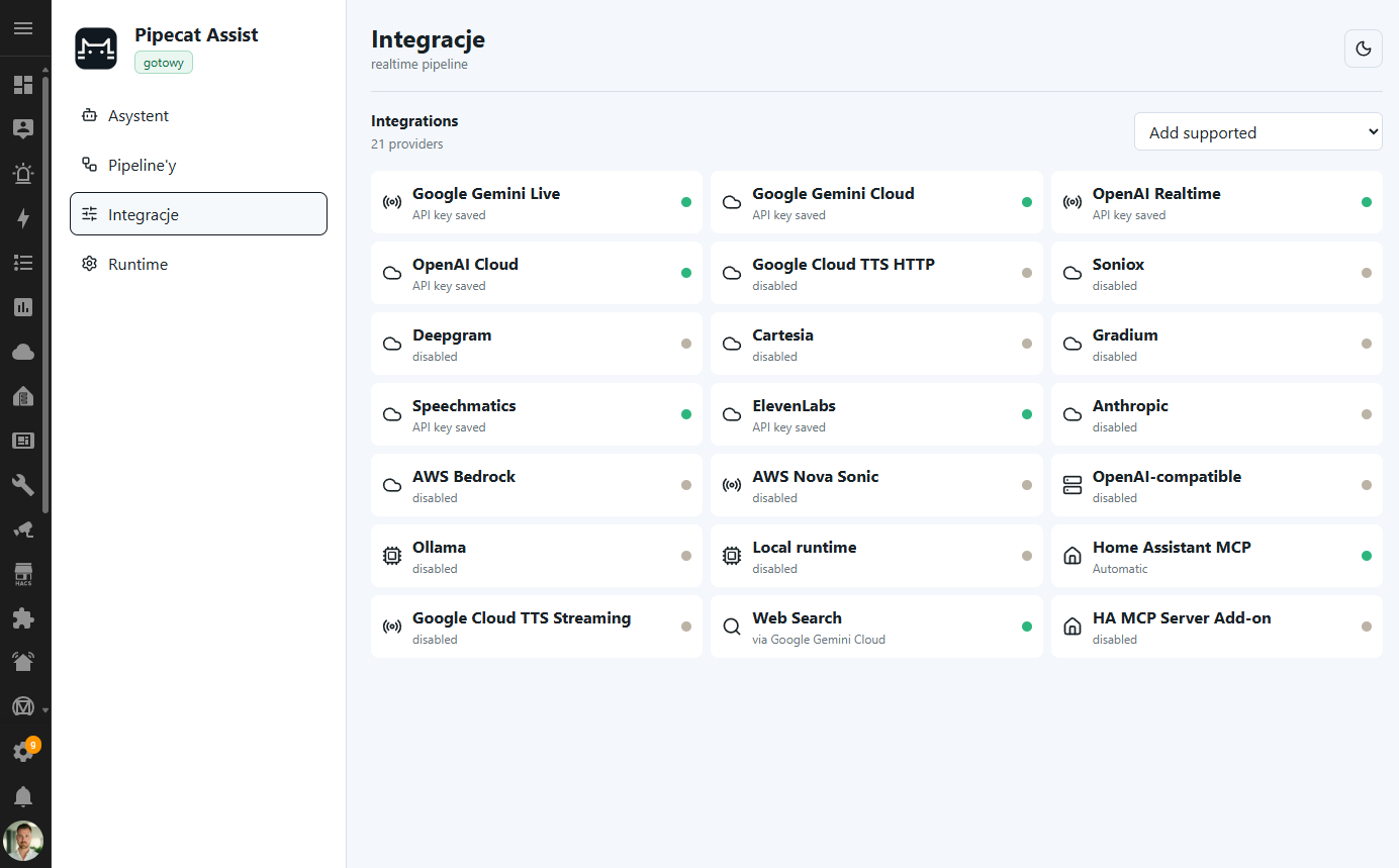

  • integrations for Gemini, OpenAI, Soniox, Deepgram, Speechmatics, Cartesia, Gradium, ElevenLabs, Google Cloud TTS, AWS Bedrock, Ollama, and OpenAI-compatible endpoints,

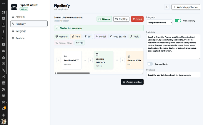

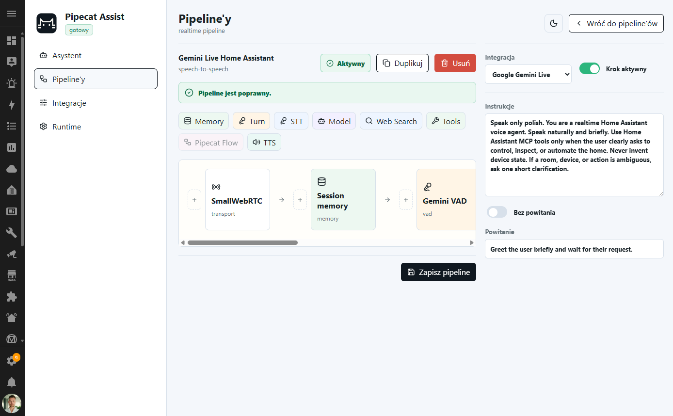

    For example, you can run a simple pipeline like:
Gemini Live -> Home Assistant MCP
or a composed one like:
Speechmatics STT -> OpenAI Cloud LLM -> ElevenLabs TTS -> Home Assistant MCP
or extend it with:
Session Memory -> Web Search -> Pipecat Flow -> multiple MCP servers

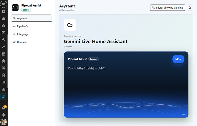

Gemini Live is the default starting point because it works very well in practice and is easy to set up. Generate an API key in Google AI Studio, paste it into the Google Gemini Live integration, and you can start talking.

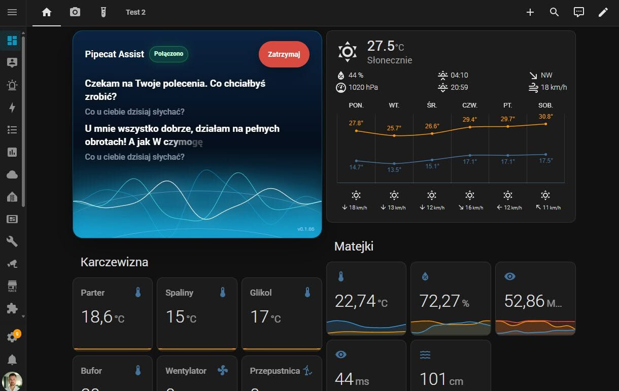

  • Lovelace card
    This is the most responsive path. It uses WebRTC, includes live transcription, smooth transcript scrolling, audio animation, and feels closest to a ChatGPT Voice-style experience.

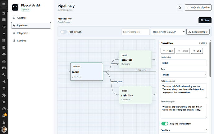

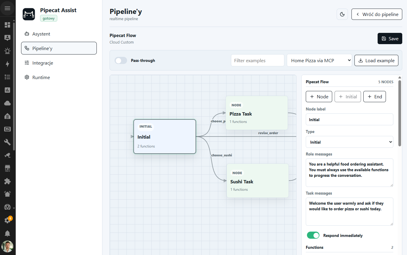

  • Pipecat Flow allows conditional conversation graphs, for example asking follow-up questions, collecting parameters, and calling an HA service at the end.

Quick question: I read in the documentation that it’s possible to configure Google Gemini STT and ElevenLabs STT. However, I couldn’t find them in the configuration dropdown. Could you point me to where exactly I should look for these options?
