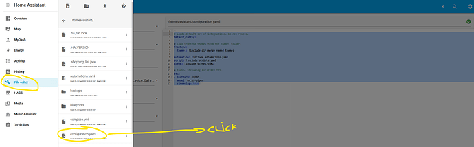

Step 3 - Open file editor and from the HomeAssistant root find configuration.yaml, click on it and an editor pane will appear to the right. See picture below.
Step 4 - Add the content from line 13 onwards , the rest was already there. Don’t edit anything else. Don’t worry about it looking like a short configuration.yaml, that’s normal.
Enable Streaming for PIPER TTS
tts:
  • platform: piper
    model: en_US-piper
    streaming: true
If you get it right there’s a green tick on the top right as an indicator. Click the adjacent save button and restart the whole HAOS so all the scripts/addons get a fresh boot. If you test a longer query, e.g. “How do I stroke a cat” or “Tell me a short story” you should get a response generated much faster than previous attempts. If your LLM isn’t loaded the first attempt will have to wait for it to load so you might want to set it to be held in memory with -1 on the ollama keepalive option.
