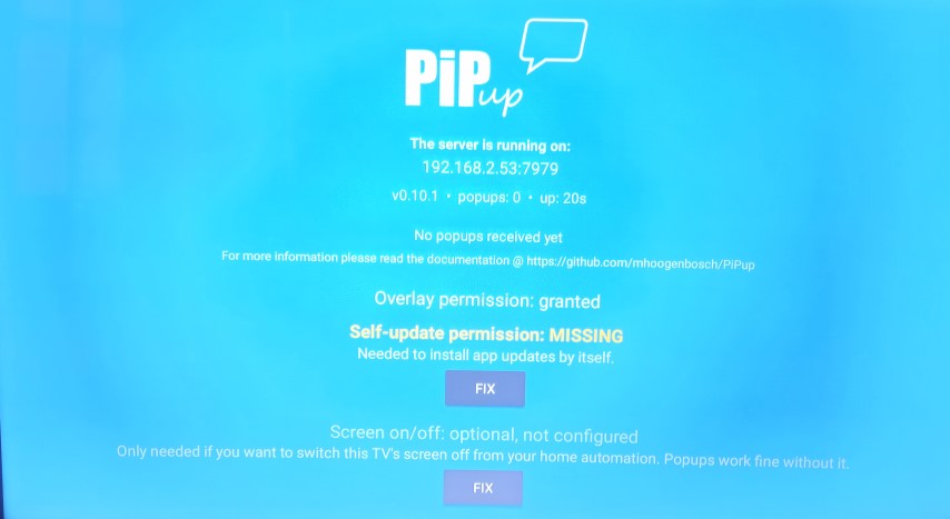

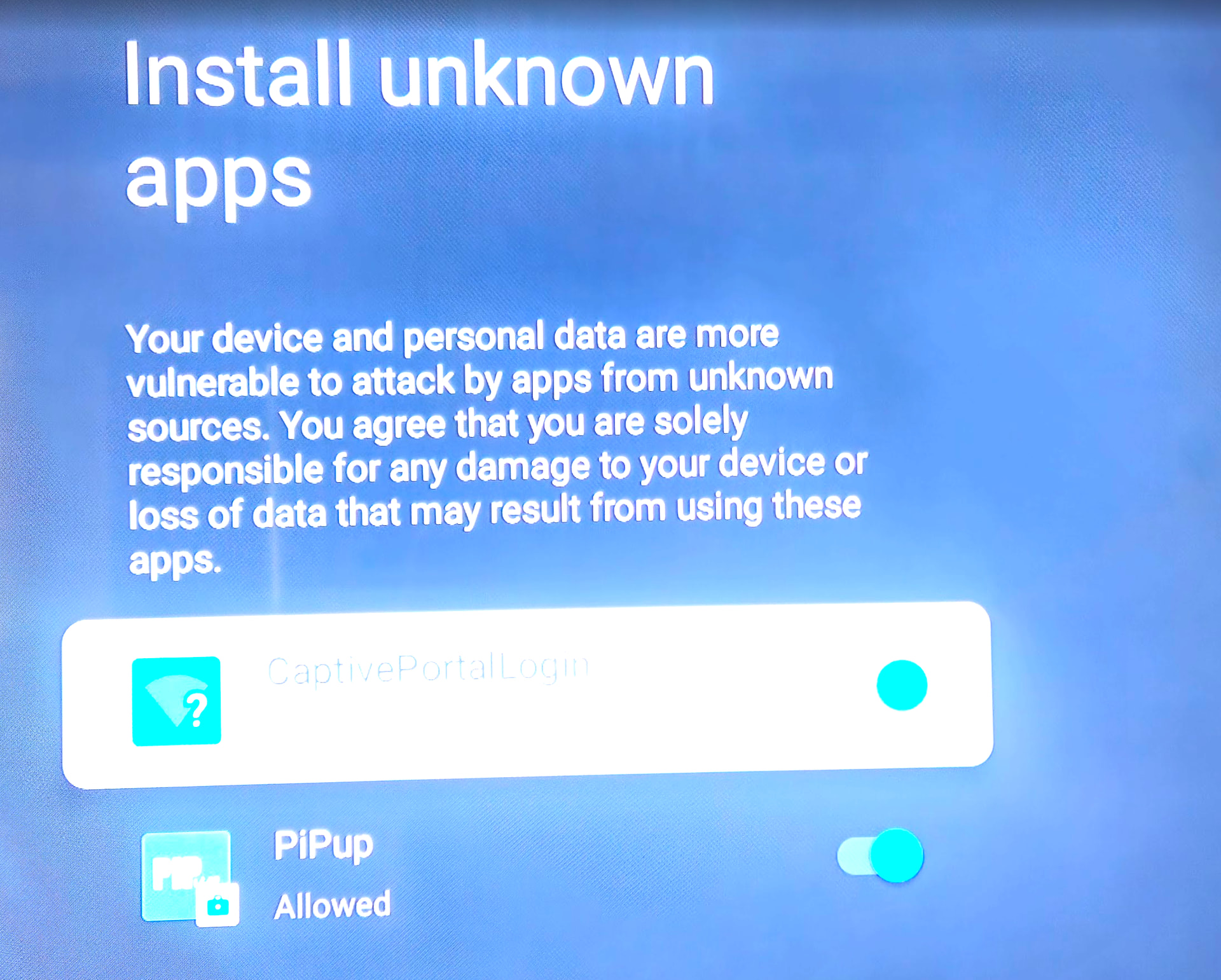

update to today’s APK & Integrations. I get the error on screen on both TVs get Self-Update error. Permissions look fine and the
I creaded a new version with a few extra checks, could you try and install that and check? Then if it still shows missing flip the switch to off and back to on, it should correct itself. If this doesn’t work, please post the diagnostics information in a Github issue. (http://192.168.2.53:7979/permissions/diagnose)
Also just created a new version which handles updates a bit better.

{"sdk":30,"device":{"model":"Smart TV Pro","manufacturer":"TCL","android":"11"},"permissions":{"overlay":true,"installPackages":false,"autoStart":false,"deviceAdmin":null,"accessibility":false,"complete":true,"fixable":{"overlay":true,"install":true,"admin":true,"accessibility":false}},"opModes":{"installPackages":"errored","overlay":"allowed"},"installCheckError":null,"user":"UserHandle{0}","targetSdk":34,"backgroundLaunchExempt":true,"activityVisible":false,"deviceAdminSupported":false,"screens":{"overlay":{"granted":true,"action":"android.settings.action.MANAGE_OVERLAY_PERMISSION","resolvedActivity":"com.android.tv.settings.device.apps.specialaccess.SystemAlertActivity","placeholder":false,"fixable":true,"adb":"adb shell appops set nl.rogro82.pipup SYSTEM_ALERT_WINDOW allow"},"install":{"granted":false,"action":"android.settings.MANAGE_UNKNOWN_APP_SOURCES","resolvedActivity":"com.android.tv.settings.device.apps.specialaccess.ExternalSourcesActivity","placeholder":false,"fixable":true,"adb":"adb shell appops set nl.rogro82.pipup REQUEST_INSTALL_PACKAGES allow"},"admin":{"granted":null,"action":"android.app.action.ADD_DEVICE_ADMIN","resolvedActivity":"com.android.tv.settings.deviceadmin.DeviceAdminAdd","placeholder":false,"fixable":true,"adb":"adb shell dpm set-active-admin nl.rogro82.pipup/.AdminReceiver"},"accessibility":{"granted":false,"action":"android.settings.ACCESSIBILITY_SETTINGS","resolvedActivity":"com.google.android.tv.frameworkpackagestubs.Stubs$SettingsStub","placeholder":true,"fixable":false,"adb":"adb shell settings put secure enabled_accessibility_services <huidige waarde>:nl.rogro82.pipup/nl.rogro82.pipup.PiPupAccessibilityService"}},"lastFix":{"what":"install","ok":true,"activity":"com.android.tv.settings.device.apps.specialaccess.ExternalSourcesActivity","error":null,"secondsAgo":395},"version":"0.11.0"}
Thanks — that diagnose output pins it down exactly, and the good news is that PiPup itself is working fine on your TV as you already mentioned.
What’s actually wrong
Only one thing is off: the *self-update* permission. Everything else is fine, `overlay: true` and `complete: true` mean popups work. But look at this line:
"opModes": { "installPackages": "errored", "overlay": "allowed" }
`errored` is not “not set yet”, it’s an app-op that your TV has put into an explicitly blocked state. That’s why `installPackages` is `false`, and why the Fix button didn’t help: your `lastFix` shows the button did open the “Install unknown apps” screen (`ok: true`, a real screen, no placeholder), but the toggle wouldn’t stick.
This is a TCL device restriction, not a PiPup bug. Several manufacturers lock “Install unknown apps” for sideloaded apps at the system level (Samsung’s “Auto Blocker” is the best-known example). The permission screen exists, but flipping the switch doesn’t take.
Why it can’t be fixed from the app or from Home Assistant
Granting this permission requires shell/system privileges (`appops`), which no normal app has, and Home Assistant runs off-device, so it can only ask the app to open the screen, not grant anything. So neither a button on the TV nor a button in HA can push past the `errored` state. Only adb can.
What to do
You have two options, and neither blocks using PiPup:
1. Grant it once over adb (this overrides the errored state directly):
After that, `installPackages` flips to `true` and the in-app / Home Assistant update button works.
2. Skip self-update entirely and just sideload new versions by hand (e.g. via the Downloader app) when you want to update. Everything else in PiPup keeps working without this permission — it is only needed so the app can install its *own* updates.
Also worth a look: check whether your TCL has a global “unknown sources / security” blocker somewhere in its settings (analogous to Samsung’s Auto Blocker) — if so, turning that off may let the toggle stick without adb.
(Side note: the fact that your report shows `opModes`, `lastFix` and the resolved activity is thanks to the new `/permissions/diagnose` endpoint — exactly what it’s there for. Thanks for sending it, it made this a two-minute diagnosis.)

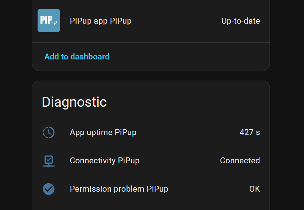

Its working much better with the latest fixes. This morning was the first time it properly 'started the APK install from HA’s UI. It turned on the TVs and prompted the user to install the APK… maybe we can get it to silent install?

I’ve added an instruction how to do this mhoogenbosch/ha-pipup: Home Assistant integration for PiPup (fork): show camera streams and notifications on Android TV for as long as you want

  • TCL Google TV owners: if PiPup keeps dropping offline on your set, the installers now enable PiPup’s (dormant) accessibility service by default — that turns out to be the one state TCL’s app-killer leaves alone. One owner went from disconnects every few hours to rock solid with that single change.
Update the app on your TVs (it can do that itself from HA) and the integration via HACS. Full details and Dutch versions in the release notes. Keep the reports coming — nearly everything above started as one.

The TV now tells you when the integration is behind (0.21.0 / 1.18.0)
The app’s status screen shows which ha-pipup version is talking to it, which one is recommended (always the latest release, fetched automatically) and the minimum it needs — one glance tells you if the HA side needs an update. The integration announces itself on every request, so this fills in by itself.

Older devices (Android < 7.1.1, e.g. some Xiaomi projectors) couldn’t self-update: they’re missing the root certificate GitHub’s download servers use. The app now bundles that one public root — and 0.21.1 fixes the subtle part: the download goes through a redirect, and the first fix never reached that hop. One last manual install via adb, and from the next release the in-app Install button should work there too. Full detective story in issue #41.
