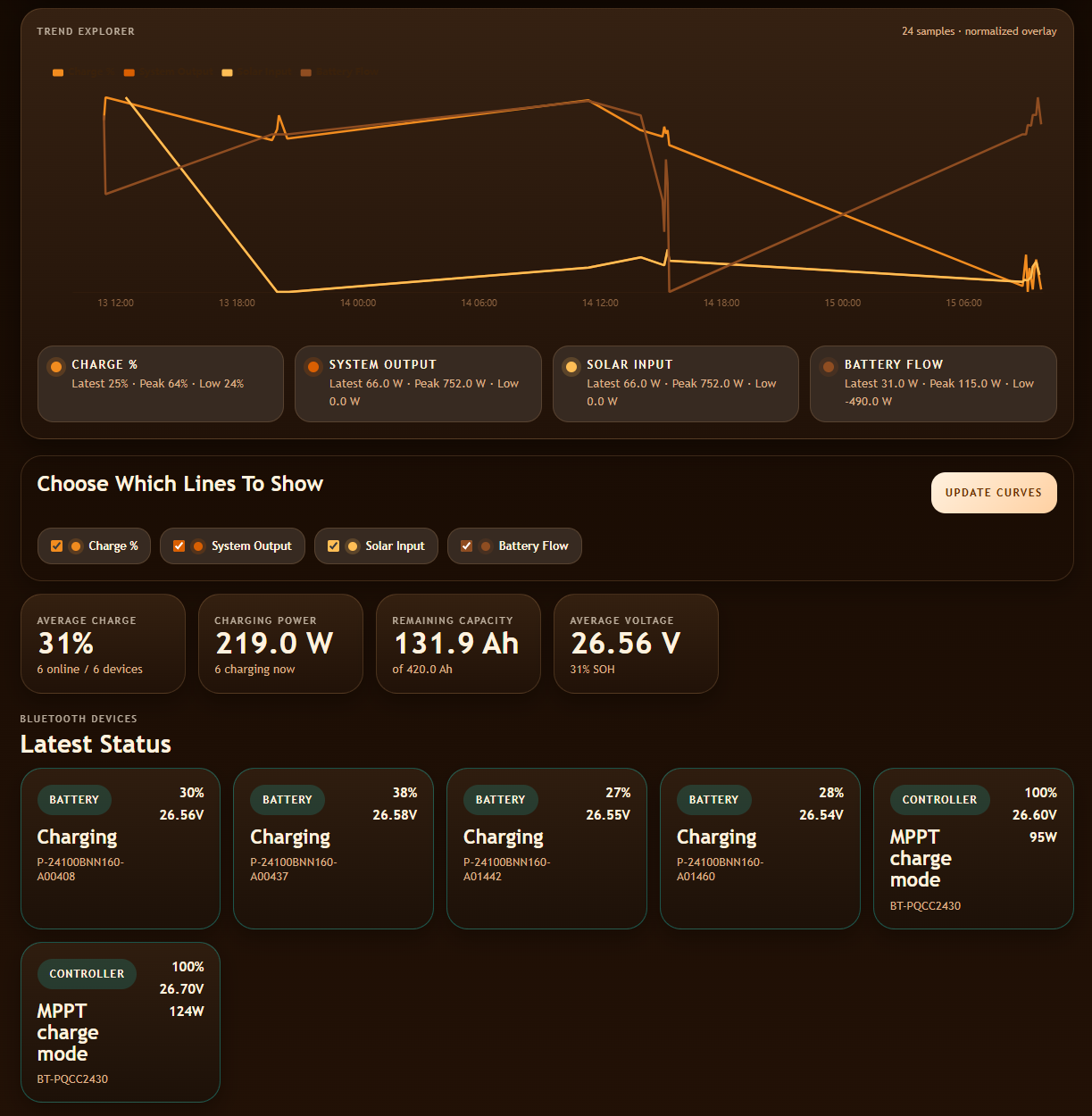

The Fun Part:
  • AI using a git-available bluetooth library to poll data from the batteries
  • AI finds the batteries and charge controllers on the air-interface

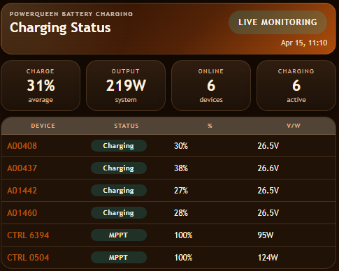

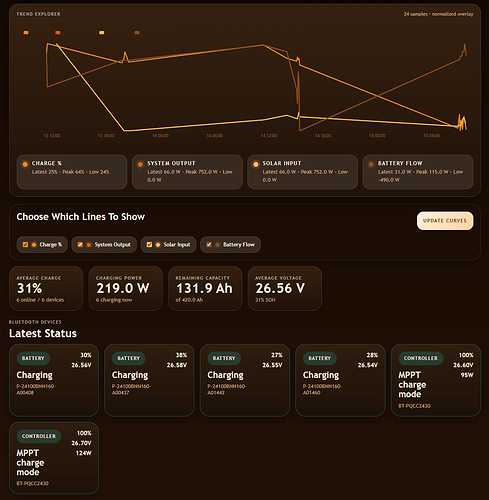

  • AI creating a minimum viable kiosk-dashboard on the physical display
  • Me finding out, that the pi-bluetooth modul is buggy and ordering a usb-dongle
  • AI finding out the charge-controller bluetooth is just a bluetooth modbus gateway
  • Me requested the powerqueen RS485 document from support
  • Me refining the dashboard
  • AI creating a web-dashboard

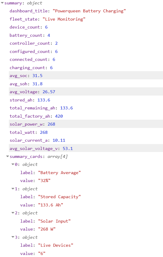

  • AI adding a json-API

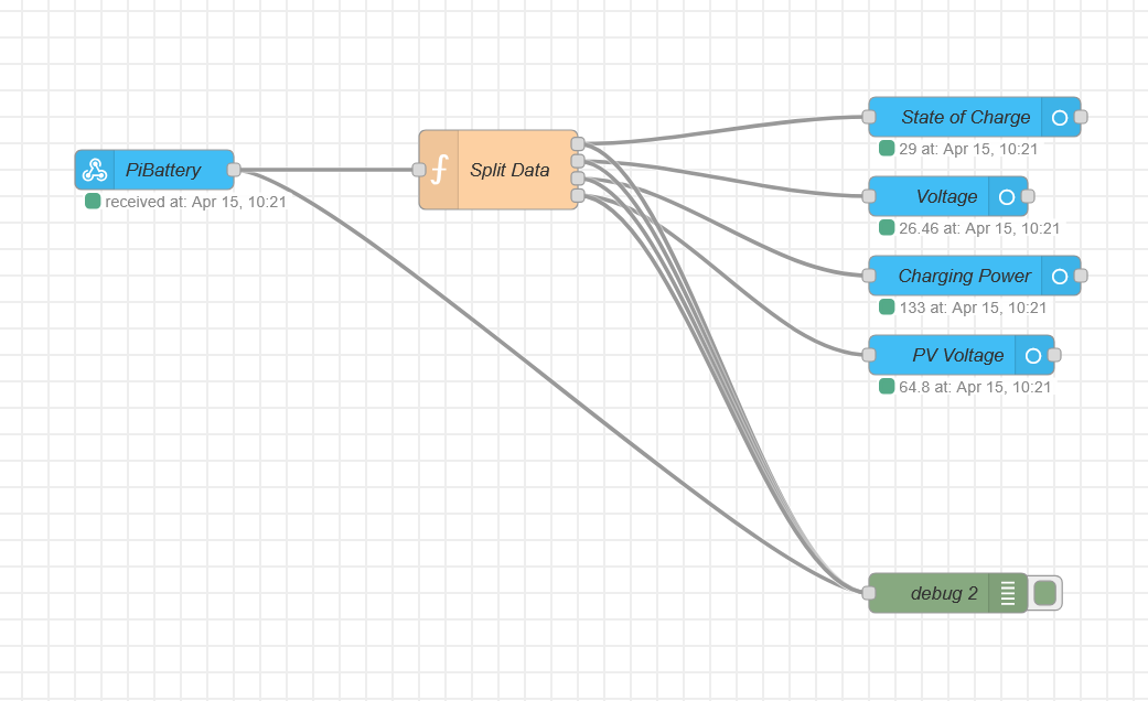

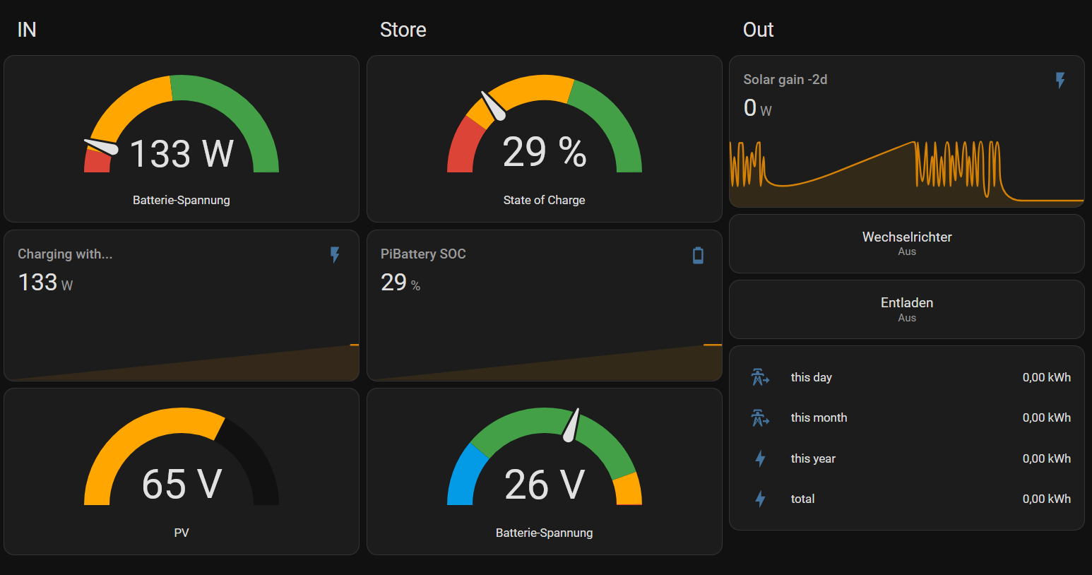

  • AI adding a webhook-call with the json-data to HA
  • AI creating a minimum node-red flow with a to create HA-Entities
  • Me importing the flow and setting up a dashboard

the metrics-panel for the charge controller now shows PV-Voltage also
the 100% State of Charge on the Chargecontroller is confusing but represents that the current voltage could be nearly 100% SOC on a LIFEPO-Battery and the Charge-Controller does not see Energy going out.
Since the Charge-Controller DC-Out is capable of 30A output (26V= @30A ~700W) i consider connecting the inverters directly there… then the controller also can calculate state of charge knowing how much energy went in and out.

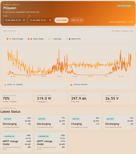

after a few iterations, this is what the dash now looks like
Now:
  • has a configuration-file
  • changed the graph library
  • has sql-lite DB
  • sends data to a node-red-webhook
  • also offers an api to request data from the PiQueen

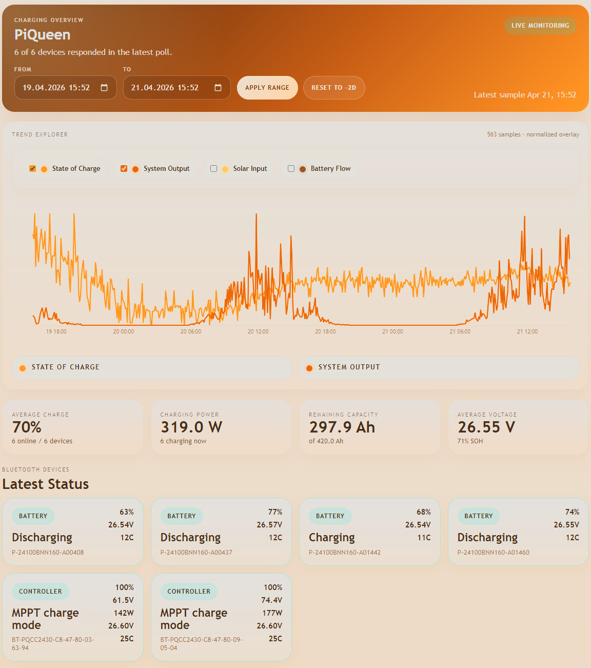

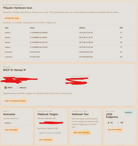

i added an admin-dash

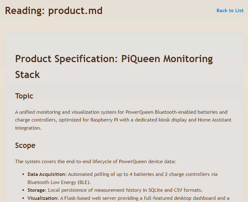

and inline-doc-reader
spoke to powerqueen today. they agreed to me creating this as a github-project with some specific limitations on the “writing” side .
We are looking good.

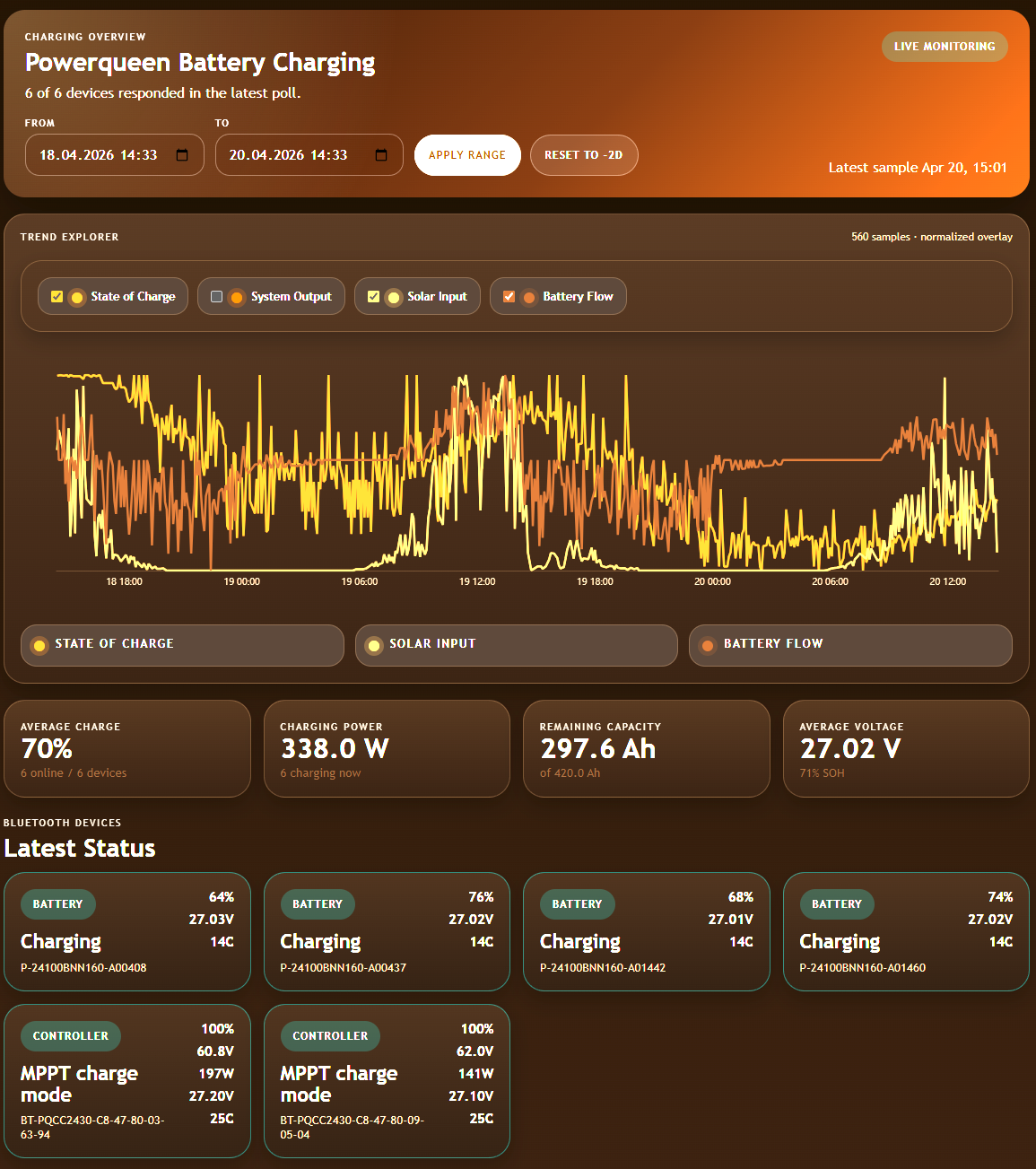

Description
The provided Software
  • Approved by Powerqueen
  • uses bluetooth to scan the immediate surround for blue tooth-enabled BMS and chargecontrollers by Powerqueen
  • reads data every 5 minutes and stores it in a database
  • offers a web-dashboard, showing the current data and a history-graph
  • offers a kiosk-dashboard for a waveshare display on a raspberry-pi
  • gives you an admin-dash for configuration
    – network-settings
    – up to two webhooks to send the data to
    – on/off for api-access to read the data from the box
  • does not “write” to the hardware
