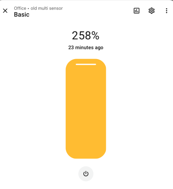

The reinterview process is problematic because almost entirely, the problematic devices are battery powered. But it has been a couple days now and I think every device has reported in at some point, but still I have motion sensors that think they are lights.
I just experimented and pulled an OLD multi sensor out of mothballs to see if it would work, and with new batteries it included and started reporting, but like my other PIRs, HA seems to think it is a light:
Even though it also reports Luminance, temp, humidity.
This is an Aeon Labs DS805-ZWUS.

Well, that’s something I guess. Not the full picture. The Any sensor doesn’t do what you need?
55k lines for a single device!? (My entire configuration diagnostic for 33 nodes is only 100K lines). Generally large files are better off posted to a pastebin site.
The Basic entity just exists when Z-Wave JS doesn’t map the Basic CC support it to something else like Binary CC or Notification CC. If any of those sensors work you can just disable the light entity. Or report an issue to Z-Wave JS so it gets fixed permanently.
I downloaded the diagnostic for the device, and it included the entire diagnostic for all of HA.
The Any sensor MIGHT do what I need, if I knew what triggered or didn’t trigger it. Will a change in temp trigger it? I’ve yet to see Any turned off since I spun that sensor back up.
