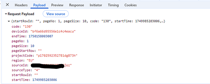

I am struggling to establish an entity for the associated device, I have queried Tuya development platform and believe I have got the right DPID for the “energy_forword_a” data point. I can see a value both in Tuya and HA (device logs) but when I come to setting up the device it stills shows as unavailable. These are the parameters I used to set up the device, manually setting what I believe to be the correct DPID by following the debug options within Tuya
Tuya reports a value that roughly corresponds to the tuyalocal device debug file suggesting that both Tuya Platfrom and Tuya Local are recieving the correct value against the query, however I cannot seem to get it to work as an entity/report

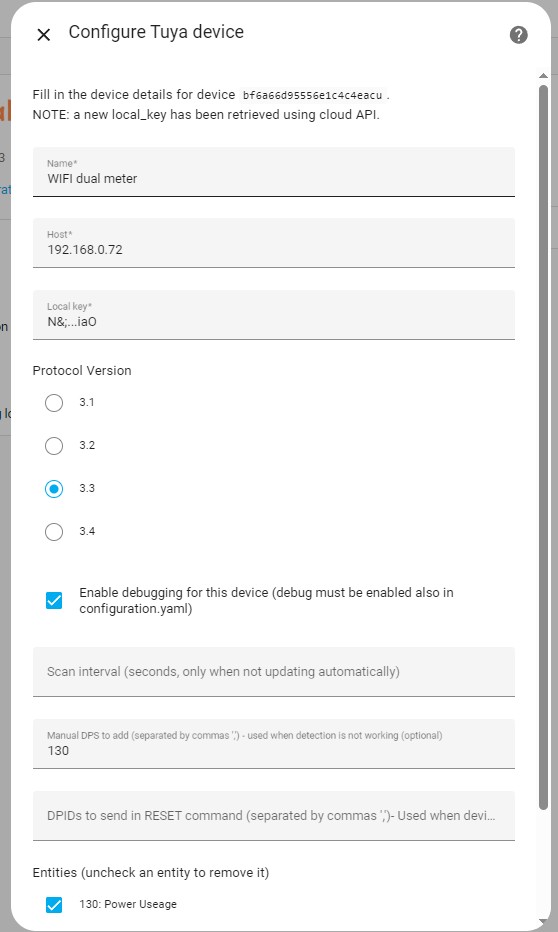

I have set the entity up, when prompted, as a sensor and by the default suggestion of switch but still get “not available” when reporting back on both the entity and device.
Any suggestions?

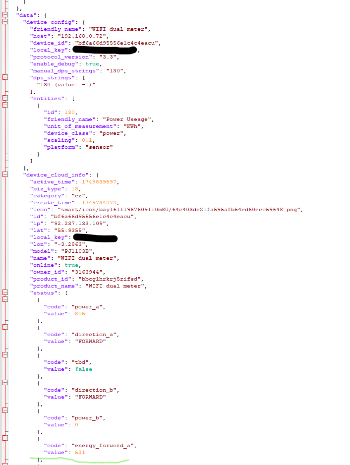

Tuya output showing the correct DPID?
Tuya Local Parameters showing a value against the variable I wish to monitor although DPID (130) not necesarily reconciled?
