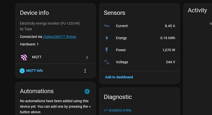

I installed a PJ1203 clamp energy meter a while ago. We’re getting a 49 deg c day tomorrow, and I’ve been looking at current to see if my air conditioners are anywhere near capacity. I have verified the amps accuracy with a clamp multimeter, and voltage is good as I have a few other smart things measuring the same. What gets me is the power (watts) on the dashboard. How can it come up with a number like that, when the maths (volts x amps = watts) does not add up? Am I reading it wrong?

I’m after real power consumed - trying to do math for solar & batteries. I change the “power calibration” ratio in Z2M for the clamp, but no change in W is displayed. Why can’t I have W = V x I ?
