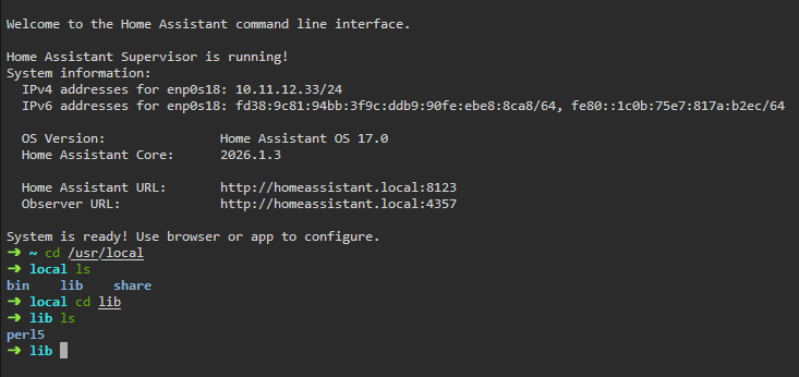

This is really bad. Please correct me if I’m wrong, I did a ‘find -name pypjlink’ from root, but didn’t find it anywhere, it was previously placed under /usr/local/lib/python3.13/site-packages/pypjlink/

Yeah, but where is the library for it, it’s not in that folder?
Not sure where you did your find from, nor what installation method you use, but the library is definitely in the HA docker images
triton:/config# ls /usr/local/lib/python3.13/site-packages/pypjlink*

That is very interesting, this is a HA Core install and it is not there!
This is an HAOS install, not Core (which is pure python).
Be it be SSH’ing to the Terminal addon or to HAOS itself, you won’t find the python libraries there, only inside the HA docker container itself.

Because you used a “Core” installation, pure python, through pip. That’s the only way you could have seen them on the host.
All the other installation methods use docker containers for HA.

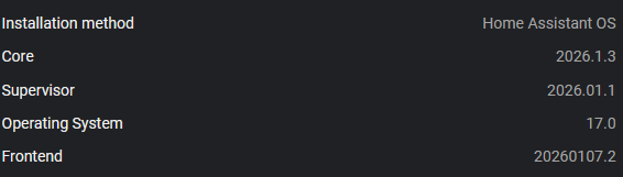

This is an installation done through the usual proxmox script. My point was to focus on the issue, and not that I used the wrong word, despite what it showed in the image.
So, no I haven’t done any unusual installation, it’s a simple VM in proxmox with HAOS.
