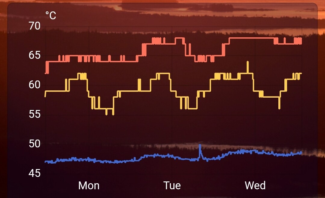

I also turn off the 5.8ghz wifi on my downstairs router overnight. The yellow trace. I tend to leave 5.8ghz off on the upstairs same type router . The orange trace. The blue trace is a third router that boasts a big heat sink.
