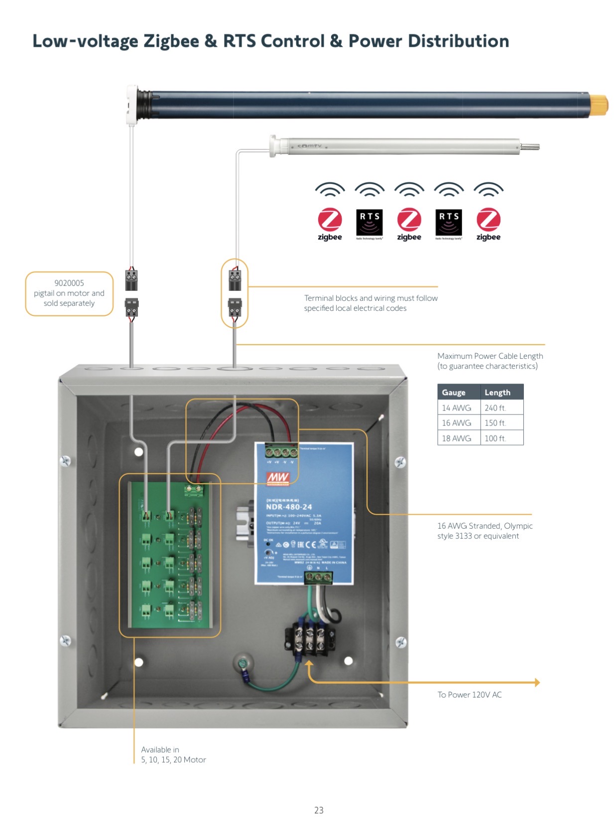

For motorization, low voltage is pretty straight forward. You will have a homerun 16/2 wire. You will have a power panel that it connects into (a large transformer, Somfy does offer a 20 motor panel). Now if you go POE you could have one cable but would need to get a network POE switch that would accomedate all the motors.
Thanks, can you let me know what you mean by 1 cable for POE? is it possible to mount shades in parallel? I thought each blind would need an individual CAT 6 going from switch to blind.
1 cat5e POE cable per motor that would get home run back to the network switch. You can do cat6 but it’s overkill. You can save money by doing cat5e. Personally, I have Somfy Zigbee connected into Home Assistant. Was a lot easier than trying to make an integration for everything to work. I setup my Zigbee motors to the TaHoma Switch, connected them to HA via HomeKit (don’t need any iOS devices) and bam. I’ve attached some diagrams.
