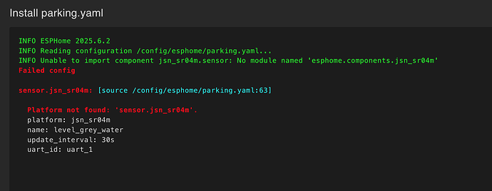

Platform not found "jsn_sr04m"
Hi
I can’t find the error.
Platform not found " platform: “jsn_sr04m”
Please help.

Hi
Doesn’t look like jsn_sr04m is a valid package and you need to use jsn_sr04t. The following has a bit of info.
PS I’m not familiar with these but always worth checking the ESPHome official documentation.
I use the ultrasonic platform like this:
sensor:
 - platform: ultrasonic
   trigger_pin: GPIO13
   echo_pin: GPIO12
   name: 'Garage Distance Meter'
   update_interval: 5s
   accuracy_decimals: 1
   unit_of_measurement: cm
   pulse_time: 25us
   filters:
    - filter_out: nan
    - delta : 0.02
    - lambda: return (x * 100);
There’s some additional info in this thread as well:
Can’t get JSN-SR04T distance sensor to work - ESPHome - Home Assistant Community
Thanks
I change jsn_sr04m on jsn_sr04t and its ok
