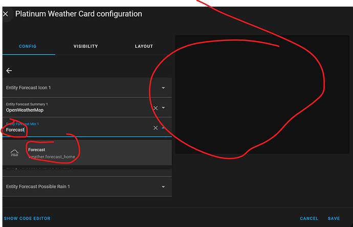

Curious if I’m missing something. I’m using the Environment Canada integration. Everything is working except the daily section. I see the forecast sensor has hourly and daily data. When I select the sensor in the configuration gui it blanks the card.
Try with tommyjlong/platinum-weather-card: This is a fully customisable weather card for Home Assistant with a graphical configuration.. It’s a fork of original Platinum Card, but fixed to work with current format of weather providers.

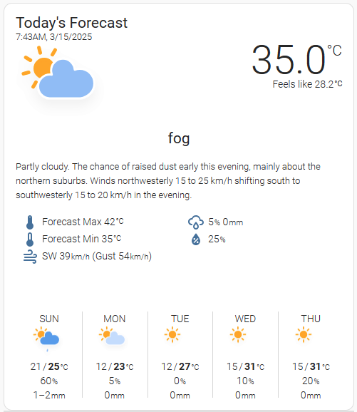

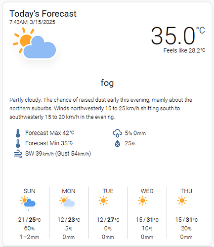

Not sure what I’m doing wrong here, but I’m not seeing any forecasts
That picture doesn’t show if you have configured any entities in the integration to actually display the weather forecast? If you haven’t - read docs if you have - post configuration

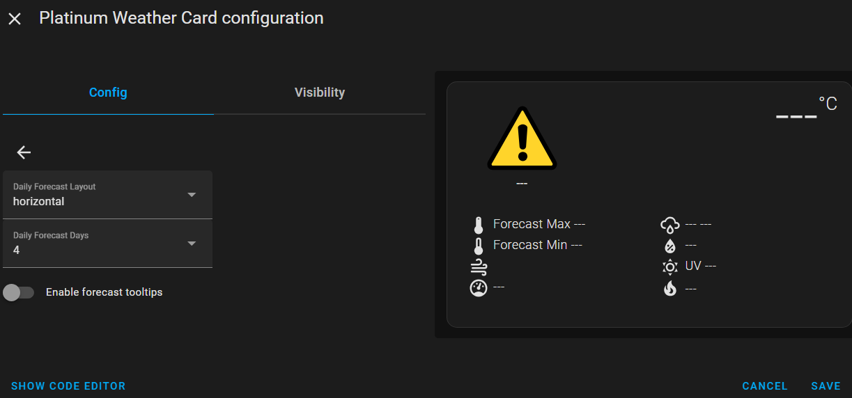

Hi, I’m curious to know, if anyone has managed to get the Daily Forecast Section showing as a Horizontal stack with the daily detailed description (that you see in the vertical stack option). This seems to get dropped if you use the cards default Horizontal stack option.
For the PWC card, in YAML add the line option_tooltips: true (I don’t think this is in the GUI editor) and this should show the detailed description when you hover over a particular day
