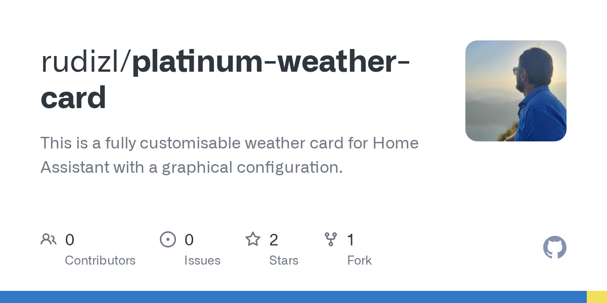

rudizl has made a fork (of my fork) of the platinum weather card (discussed here) and will be maintaining it on his repository. He has already started making fixes and features adds:
The original author, Makin-Things, has offered to hand this over (but I think TBD).

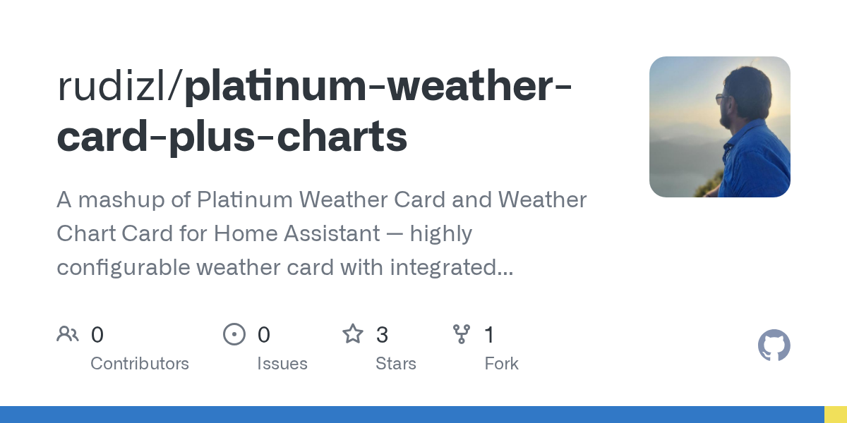

Hey folks, quick update if you're using Platinum Weather Card
The card has been renamed to Platinum Weather Card Plus Charts and moved to a new repo — it made sense to have it in one place, since it's a mashup of Platinum Weather Card and Weather Chart Card, both of which haven't seen active development in a while.
Here's what's in the current release (v2.0.1):
:thermometer: Charts section — temperature lines (max/min) + precipitation bars rendered directly below the daily forecast, each toggleable independently from the editor
:computer_mouse: Hover tooltips — hover over any day in the forecast strip or the chart and you get a popup with weather description, max/min (color-coded), precipitation, and wind. Same content in both places
:artist_palette: Icon packs — built-in animated SVG, Meteocons Fill/Line (MIT, loaded from CDN), amCharts Weather Icons, or a custom path
:globe_showing_europe_africa: Locale dropdown — BG, DE, EN, ES, FR and 8 more languages, picked from the editor
:wrench: HA 2026.5/2026.6 compatible — no broken switches or inputs
Install via HACS as a custom repository:
And the best part — a PR has been submitted to the official HACS default store, so if it gets approved you'll be able to install it directly without adding a custom repo. Processing takes months, but at least it's in the queue :sweat_smile:
If anything breaks or you have ideas, drop a comment here or open an issue on GitHub.
