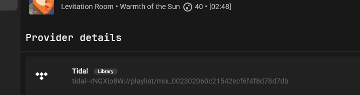

Ok, I figured it out. The trick is not to use the URL from the browser, but to look up the “provider details” in Music Assistant (is this a new feature?) on the very bottom of the mix and copy that link. There it will be a URL containing “playlist” instead of “mix” which can actually be played by Music Assistant.

    media_content_id: tidal://playlist/mix_002972859ce56d8663a2b3c3603707
    media_content_type: playlist
