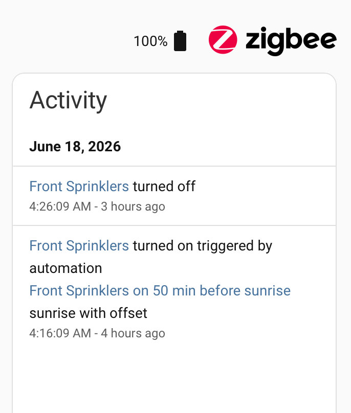

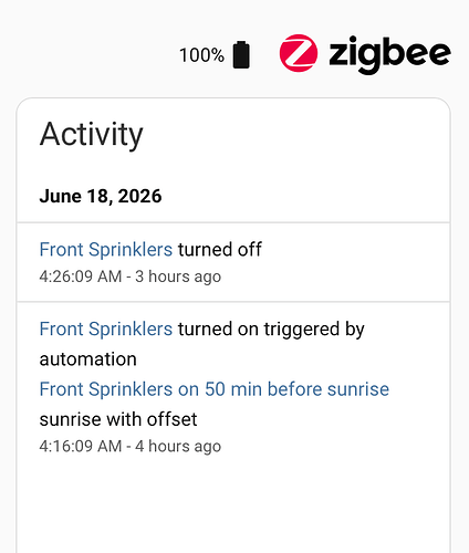

So for some reason, the switch is turning off after 10 minutes even though I have the delay for 50 minutes. Haven't moved to Z2M yet so trying to figure out why this is happening.
Long version: Sonoff SWV water valve - auto-turn-off
Short version: Check for firmware updates
Thank you.
For anyone else who gets the Sonoff Zigbee Hydro One, here is my recommendation for setting up:
First use the eWeLink app on your phone and connect to the Sonoff over BLE. Update firmware and change the default watering duration from 10 minutes to your preferred.
Then press the button for 5 seconds to enter pairing and add to ZHE.
I also added the ZHA quirk by downloading the file and uploading via HA file editor. That gave me more info than just switch and battery.
