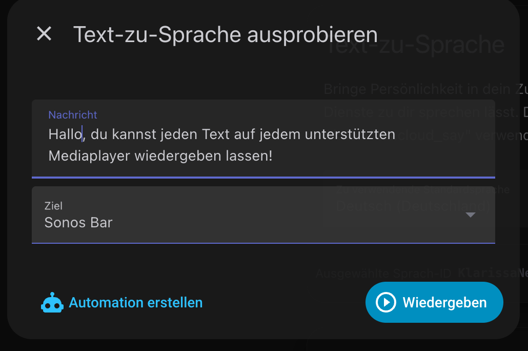

Following setup: Voice PE, using a voice from elevenlabs.io. Sorry I’m only allowed one pic and the other one seems more important. Anyway, this works well, via a pair of old speakers AUX’d to Voice PE.
But then, I have a top of the line Sonos system. Which is perfectly usable in the Cloud settings:
I can’t, for the life of me, not figure out how to route whatever Voice PE says to the Sonos system. I don’t want to play music, no Plex, no nothing. I just want whatever HA has to say to me via the Sonos system. Which setting am I not finding? Thanks a bunch & I fully realize the answer will be super embarassing for me :wink:
