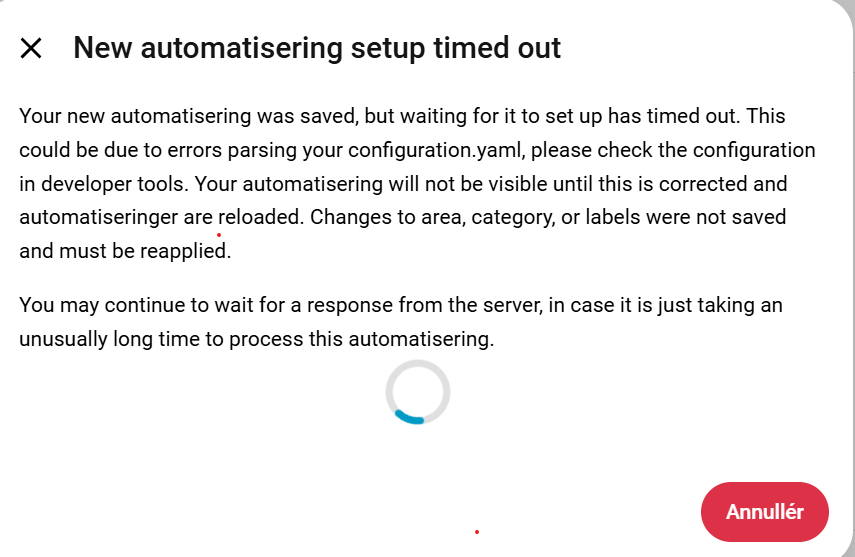

Although i get this error message, when i save the automation, and automation does not run
Have you done as the error message says? Seems there is something wrong in your configuration.yaml
that is my conclusion as well.

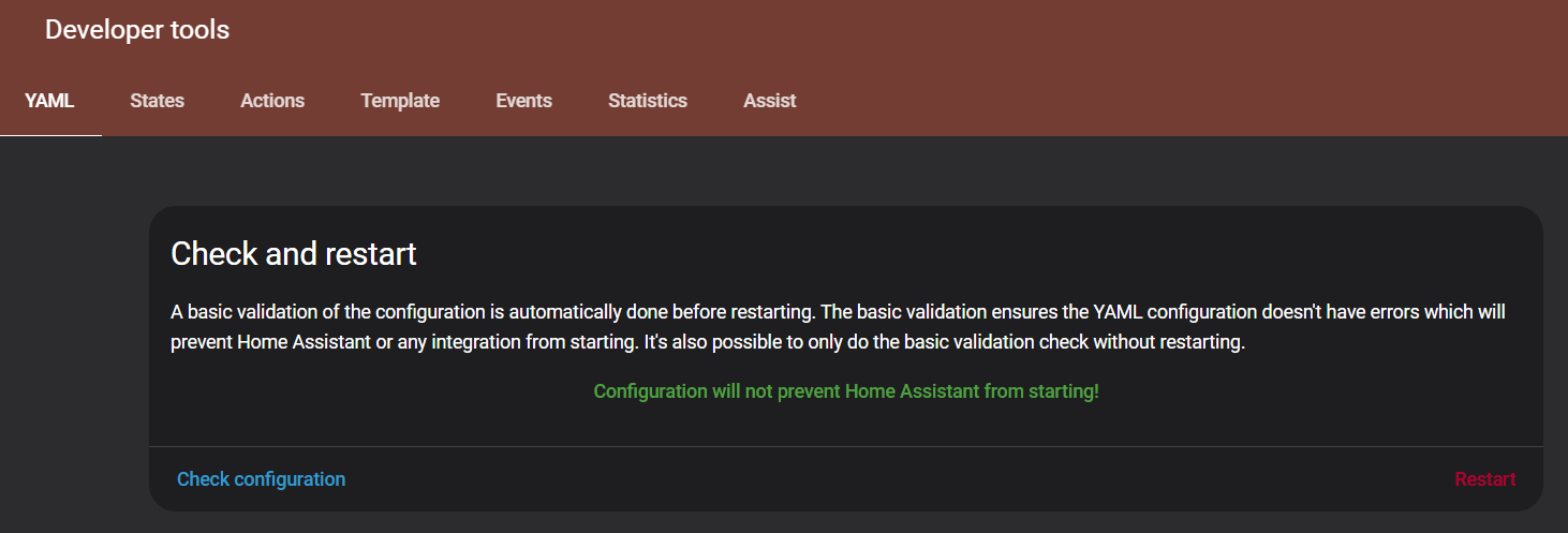

in Developer tools you can click check configuration like this, if you get anything other than the green text paste it in here in this thread as preformatted text, redact any sensitive information if you have it in the file
nothing but green

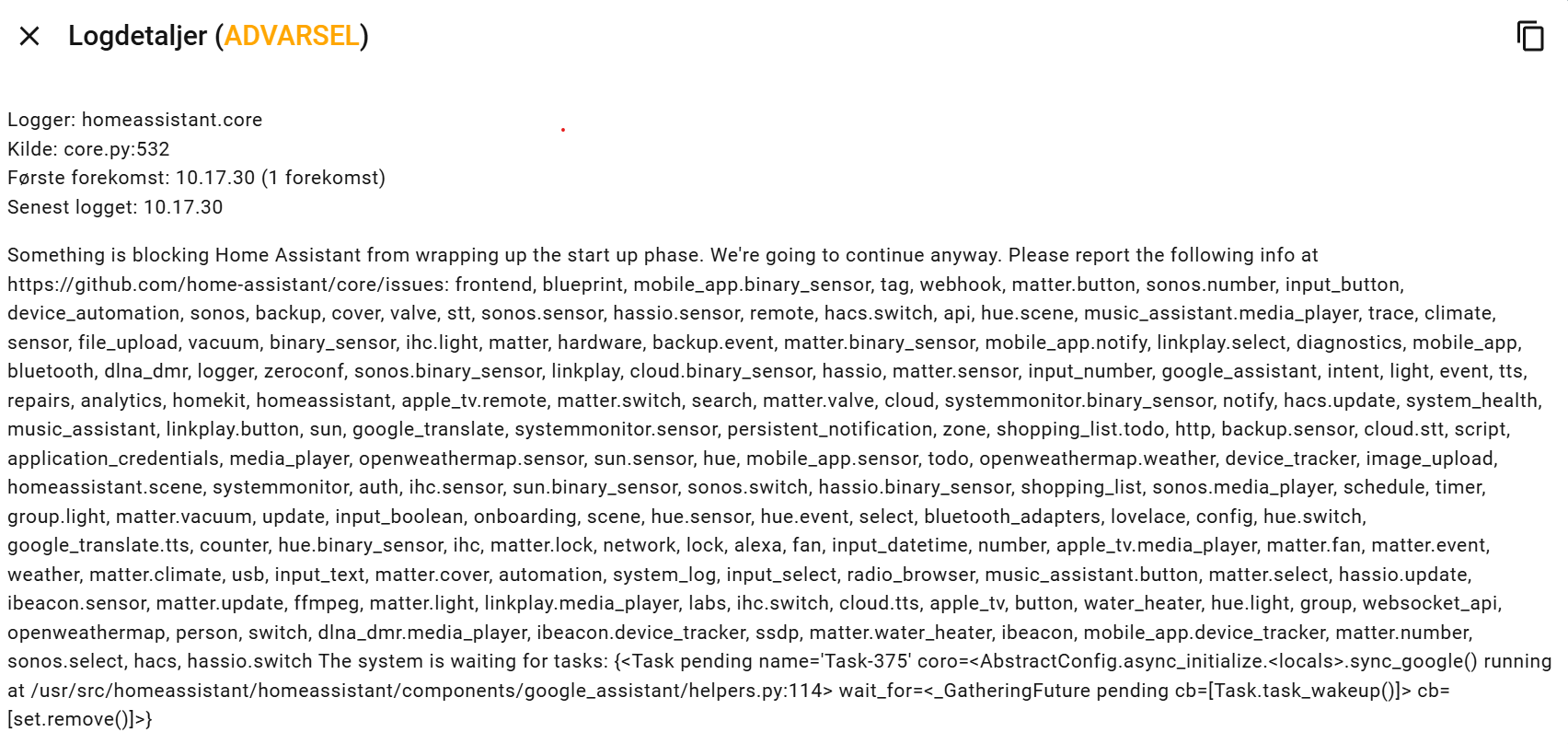

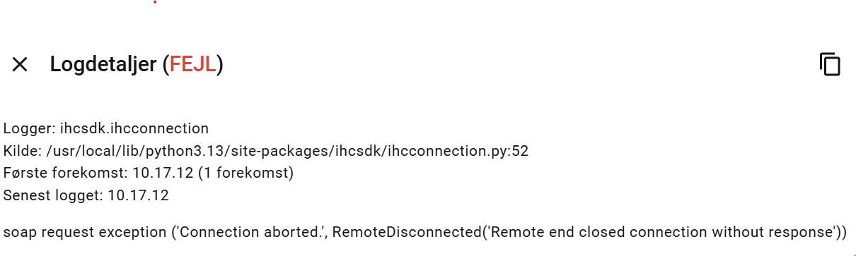

i looking i the logs to find any kind of clue.
I see this, but not sure about it
and this. But it seems to be a long time “issues” with the IHC integration, but everything seems to work even with error message.
