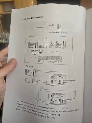

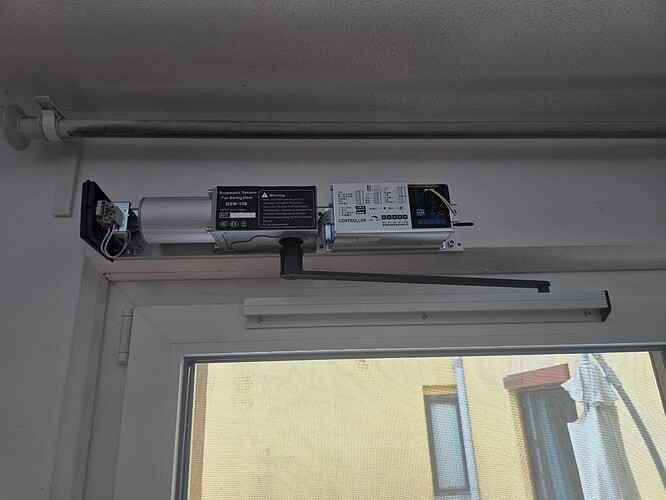

Now it works really well - opens my door as indicated in 3-7 seconds depending on the setting, and manual opening/closing still works with a little bit more power too - BUT it’s not yet in home assistant. However there are loads of ports so I guess it must be quite easy to add some tuya device, or shelly? to make this thing smart. So I will attach in another post the instructions regarding the electronics and hope someone can help me out what to do. There is also a 24v backup battery option and that is supposed to be configurable if in case of no power the door stays open or closed - so I guess at worst cutting power and supplying instead 24v could be used for automations.
I will upload the pictures of the electrical wiring in my next post.
That’s how it looks installed before adding the covers.

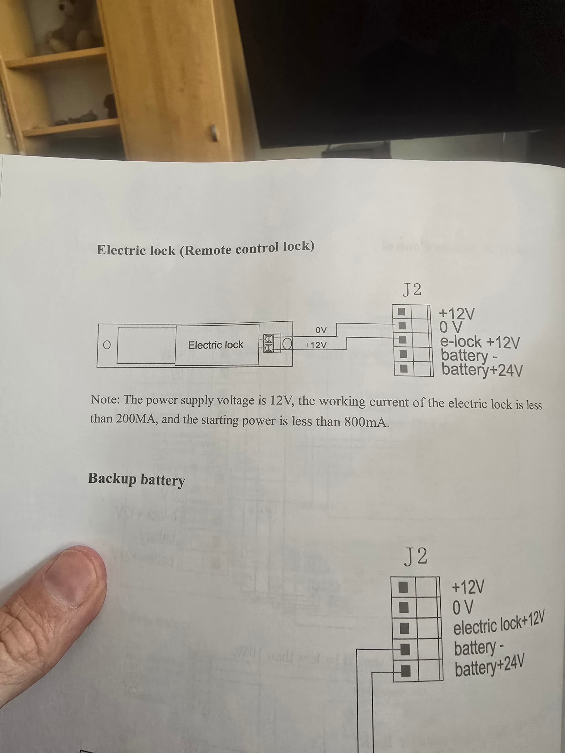

I wonder if there is 12v supply on the pins already, or if I need to add a 12v power supply to the switch? I have no electrical testing kit but I do have a 12v pass through tuya device for door bells already at home that I could try if I know how to wire…

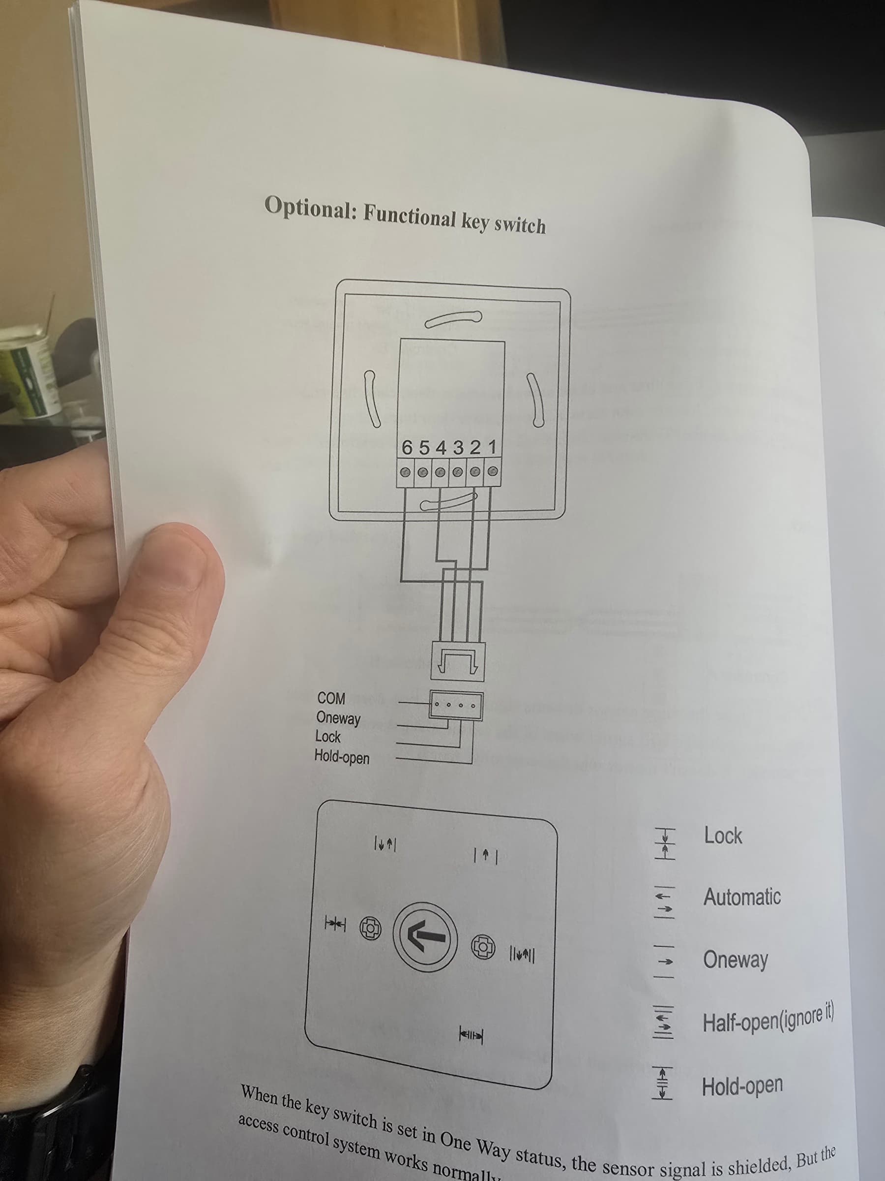

Okay, I found out. I need to connect a zigbee/wifi dry swith relay to J5.
If I then connect COM and 4 Hold open - it will be open. As soon as I drop the connection it will close.
If I connect COM with Lock - then the door cannot be pushed open - except by ripping out the screws, that would be the worst against burglars as with sufficient force the screws clearly don’t hold up in my case as the wall is just drywall were I screw it in. I still don’t know what action happens on oneway.
Kinda annoying there is no curtain swittch type of action - so cannot set it to any place between open and closed.

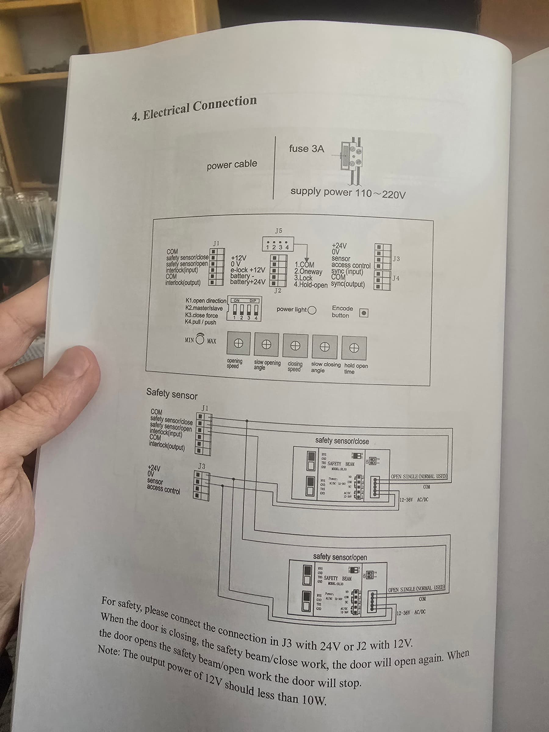

I tried shorting J1
Com with safey sensor open / safey sensor close and nothing happened. I may have fried it by stupidly connecting safey sensor open/close with the +12v misunderstanding a bit how it works.
The problem is that even the chinese instructions aren’t clear at all. I asked a friend who is Chinese native and it didn’t really help us out (I can speak fluently but not read and my chinese on electrical stuff is really bad)
Okay - well I still don’t know how to change the state of the relay upon manual door use.

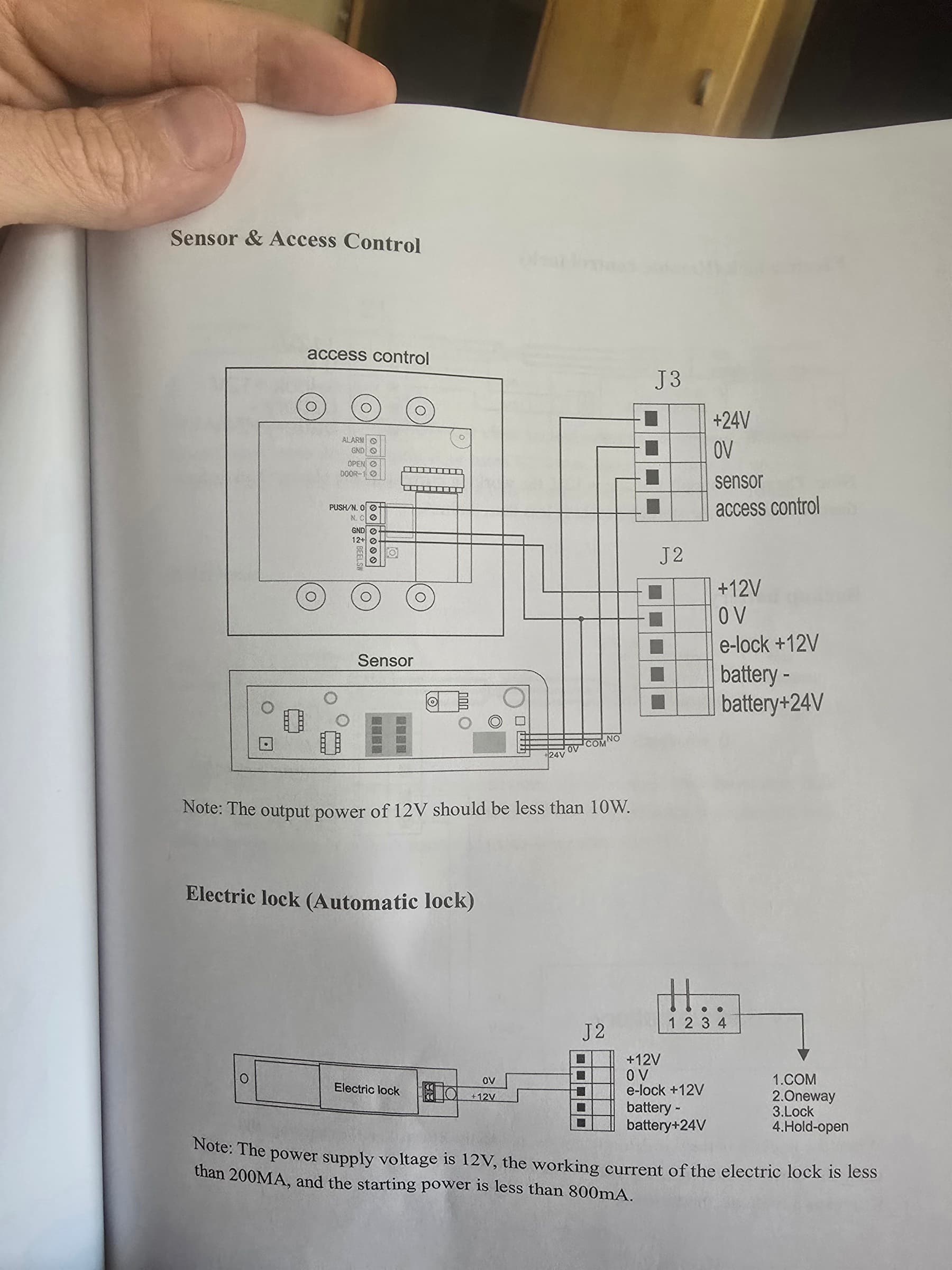

I don’t know if there is any of the connectors that could throw the switch on a shelly/tuya dry relay device.
I tried J3 access control. But it does not work. I guess if I don’t find out the only solution would be another third party sensor that monitors the state of the door.

So I guess the only solution would be some additional sensor to monitor the door position or adding an sensor to the motor supply electric cable.
What I know by now is that the +12v and +24v supply DC power. So they are not for connecting an external power supply but can supply power to other devices. There is an ac-DC converter power supply somewhere in the dsw-100n.
What I still haven’t found a solution for is also how I could increase the closing power for the last slow motion part.
