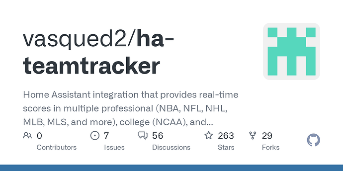

Have you used the Team Tracker custom integration?
It works quite well; I use it to trigger an automation (including a notification with the TV station and game time) 30 minutes prior to the game as well as scoring and win/lose automations. Completely unnecessary, but that applies to a lot of HA things.
