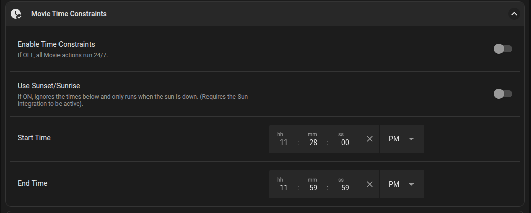

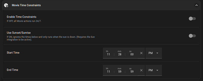

I have not had time to fully test this in my Dev Environment, it very much is bleeding edge.
Added seperate time constraints for movie, music, and television actions, and included additional requirements for the Sun integration. The time constraints need to be enabled for it to obey them, otherwise the actions run 24/7. The Sunset/Sunrise is using the state of ‘below_horizon’ from sun.sun
Once I have time to run it through my Dev Environment and test for as many situations as possible I will look to upload it to production.
so bleeding edge that I have discovered a logic issue with times that go over the midnight hour… That is now been addressed in Beta 5.1, which has just been comitted to GitHub.

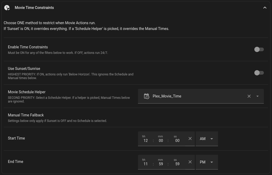

@kncowans, I have done some further testing and have updated the release version of the blueprint. I am not seeing a problem with the changes.
I have mimic’d the same time constraint options for Movies, Music and TV.
The constraint for the media type must be enabled, to start off with. if they are not then all options are ignored and the actions run 24/7
If sunset/sunrise is enabled then the automation will obey this, ignoring Helper and Manual Time Fallback options.
If sunset/sunrise is not enabled and the helper is set, it ignore the Manual Time Fallback options.
If sunset/sunrise and the helper is not set then it will use the manual time fallback settings.
please go to settings > automations & scenes > blueprints
find the Plex Webhook Handler RELEASE and click on the three dots on the right hand side and select the option to re-import the blueprint, it will jump the version up to v0.5.2
I have done mine and all looks to be intact.
