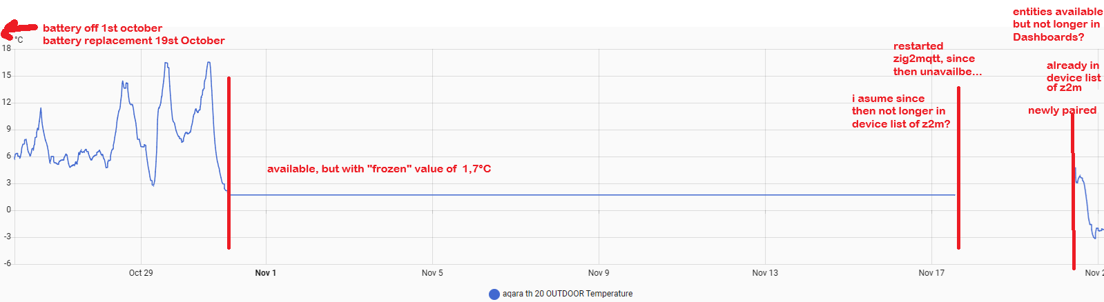

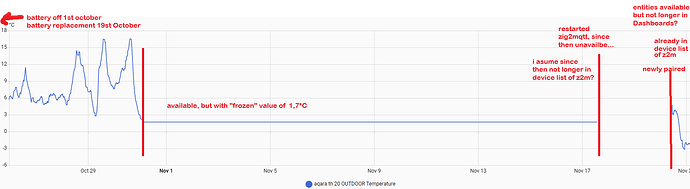

one of the “oldest” and (most important) stopped working after 2 years, i thought about battery. As it is my outdoor sensor and it was raining, i could have been replaced battery earlies after a couple of weeks off time. usually i have to replace batteries and instantly sensors coming back, or additionally i have to push with zigbee2mqtt permit join and pressing paring button on sensor for some seconds… for all sensor this works quite good, sometimes i have to wait a couple of hours beeing available again. same this time. my outdoor sensor came back in z2m, good and stable lqi >150 . after some days sensor was off again. quite strange at it drops from stable 150lqi. i was curious device has some misfunctions over the time (it´s rainsheltered, but exposed to air moisture and outdoor temperatures), but anyhow. so i had redo paring with zig2mqtt, it came back again and since then it worked for some weeks until i was unavailable again? grrr… due to rainy days it took once again at least 2 weeks for taking care of that sensor
but now the strange things happend!
as it was not longer unavailable in hassio overall i realized this sensor (or device) was not longer in my zig2mqtt device list? such things never happend to my 2 years and aprox. 150 zigbee devices?
i had NO udpates in meantime for HASSIO, zigbee etc. (latest update in Sept, but now prob started in end of Oct/begin of Nov…), i had just “restarted” zig2mqtt integration manually (instead of rebooting hole decice as i had done usually)
ok so i tryied first to reboot of my hole raspi system, but this dit not helped either: device still lost in z2m!
so in a dry timesplot, i does an device reapairing as usual and device came back to zigbe2 , stable aprox 150 lqi, nearly 100% battery (and all names of device and all related single entities of that device do have exact the old names, whats good, because is not not the default z2m usually creates it, so it remembers “some how” and had not created “new” device id?) showing states, mosquito shows all sensors (temp, battery etc.) i can access history from entities search in hasio and from mosquito device page.

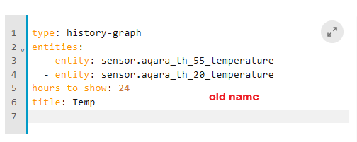

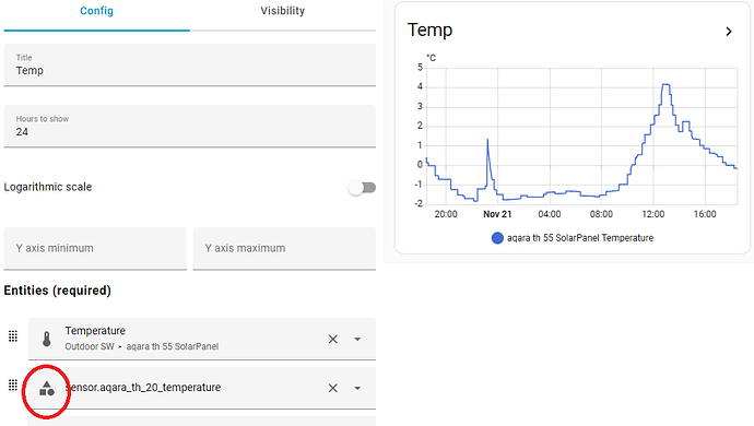

BUT in all dashboards and automations it´s broken! even simple entity cards showing sensor as “Entity not found”
and all integrations and automations etc, what uses that entities showing similar errors…

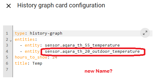

i created new entity card and it shows it well… so i started “replacing” the same entity in cards and it works now (unfortunately this entity i have on nearly all of my dashbards, automations etc.), quite anoying…

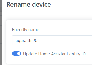

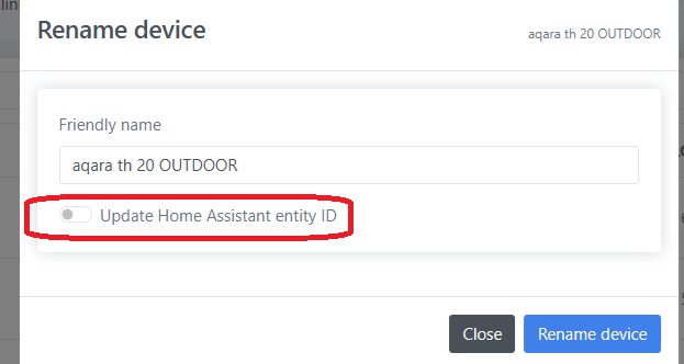

sorry i was wrong, all the newly re-paired sensor entities got new names, according the “friendly name” i had given the device in zigbee2mqtt in the past?
i usually rename my zigbee devices in z2m once with option “update Home Assistant ID”, then rename it twice and add an area to the name, but without updating HA-IDs. seems the re-creation of the missing decive by reapiring used the “remembered” device name and created entities with that name without my interaction…
i could rename all entities manually, but i used zigbee2mqtt to do it for all at once. so i renamed it the “old name” with zigbee2mqtt and updated all entities too, in good hopes it will follow the historical data too.
And it did! :face_exhaling:
