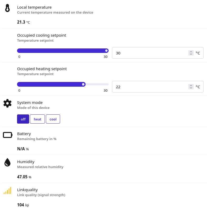

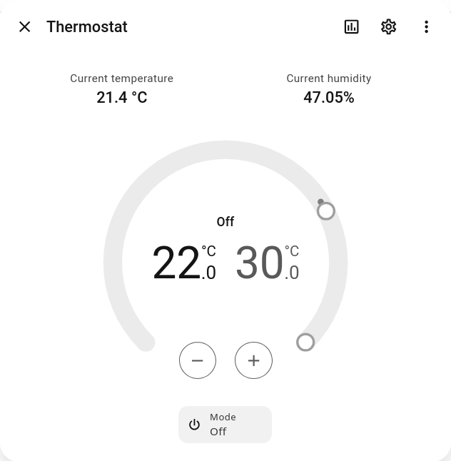

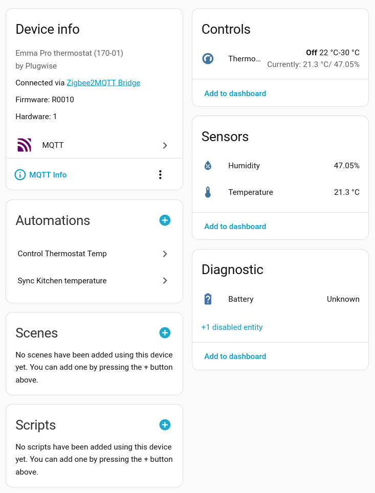

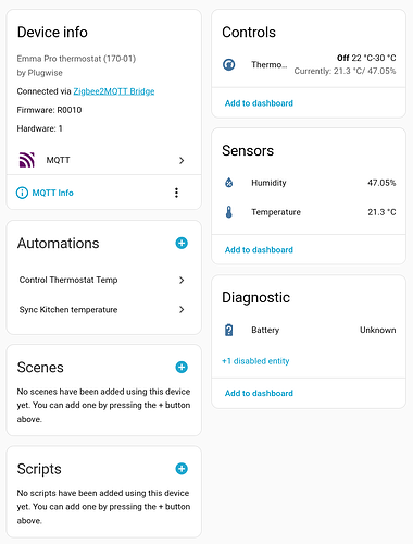

Anyway, I successfully installed mine and configured it via Zigbee2MQTT. I can configure its HVAC mode, lower (heating) and upper (cooling) target temperatures straight from Home Assistant. I haven’t tried publishing messages to MQTT topics, but I won’t be needing that.
This is how it shows up in:
HA Thermostat card:
HA Device Info:
Z2M Device card
Z2M State
