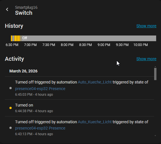

I Dont know why you made an automation to inform you, since you can easily see in History when something changes.
Also:
You can view in history sometimes why the device has been triggered.

  2. Since you dont use that entity you can disable it so you wont have an issue with it. With this you can make sure if HA or something else is turning that on.
    Then i would check in my App (or whatever GUI you have) if that switch/mode turns on on its own. To cross out the source/culprit.
  3. What does History say? Does it maybe become unavailable or so? Do your devices maybe power-cyle and in that case it restores to “on” on default maybe?
