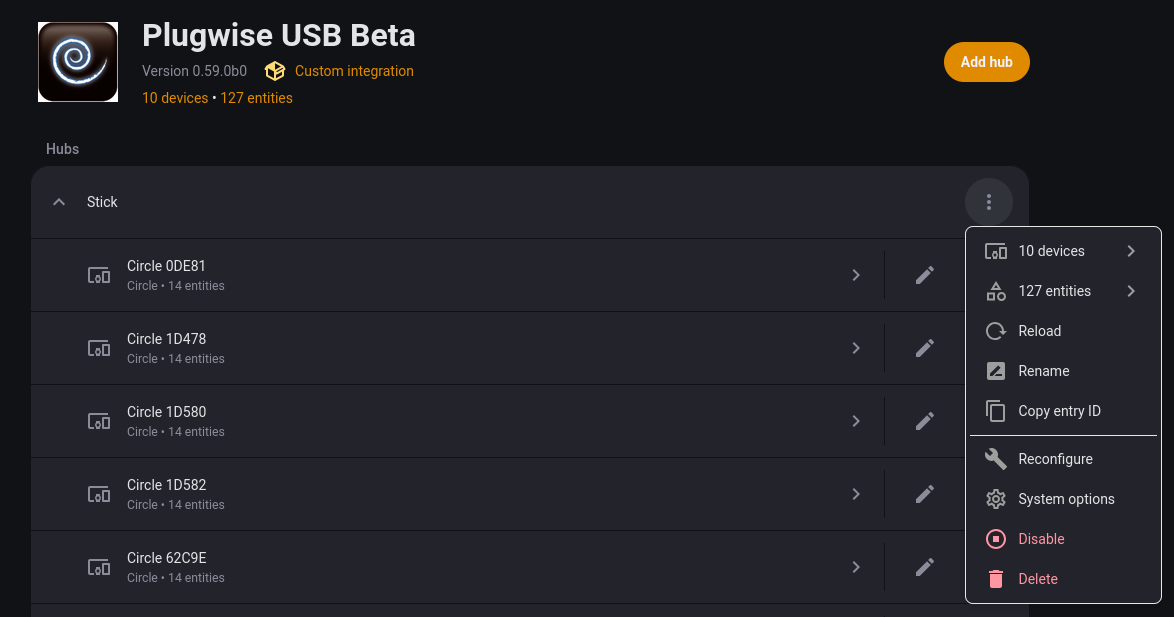

@edwin-2023 Please update to v0.59.0b0 and test :slight_smile:
Great, and very fast. Need to get some work done but will let you know!

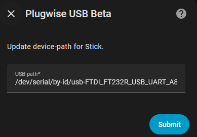

When selecting Reconfigure you will see this window pop up:
You can then manually update the path-string that has been configured in the past.
My plan is to connect the stick via ser2net on a raspberry pi so i guess the path will be: 192.168.2.2:20108 where the ip adres is the pi with the ser2net port number.

Sorry, can’t help you here, I have no experience with this. You will just need to try :slight_smile:
You could try socket://ip:port or tcp://ip:port.
Thnx, not at home until tomorrow. Will try and let you know the result. Raspberry pi 3b+ with 2.5A psu is running zigbee2mqtt and zwave2mqtt each in its own docker-compose container. Ser2net is running straight on os.
This way the proxmox server with haos is running in the concreet basement ans the pi on the first floor to get a decent coverage start.
Plugwise is now the only thing plugged in the server and running via a (to long) usb cable.
OK no problem :slight_smile:
The Integration code will validate the new device-path/url that you enter.
If no connection to the Stick is detected the code will throw an error and you should be able to re-enter a different device-path/url.
Only when the Stick is detected then the configuration will be updated and saved.
I don’t know if the Integration then will reload. If is doesn’t you can reload manually.
Good luck!
It works, and still lighting fast !!
Clicked on reconfigure and filled in: socket://ip_pi:port_ser2net. The integration automatically does a reload and all existing circles reappear and are also controllable.
