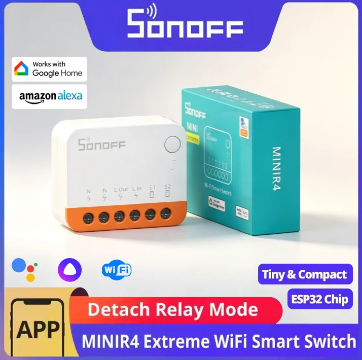

I think something like these Sonoff ones would work but these are mains powered and I want to run off low voltage DC
I am assuming even though this is designed to have a load connected to it that it would work as a remote switch also but the required supply voltage is the problem
You need a relay with dry contact. Something like the Shelly 1 will work for your scenario.
Sonoff mini-d or Shelly 1 can be powered from 12-48 VDC

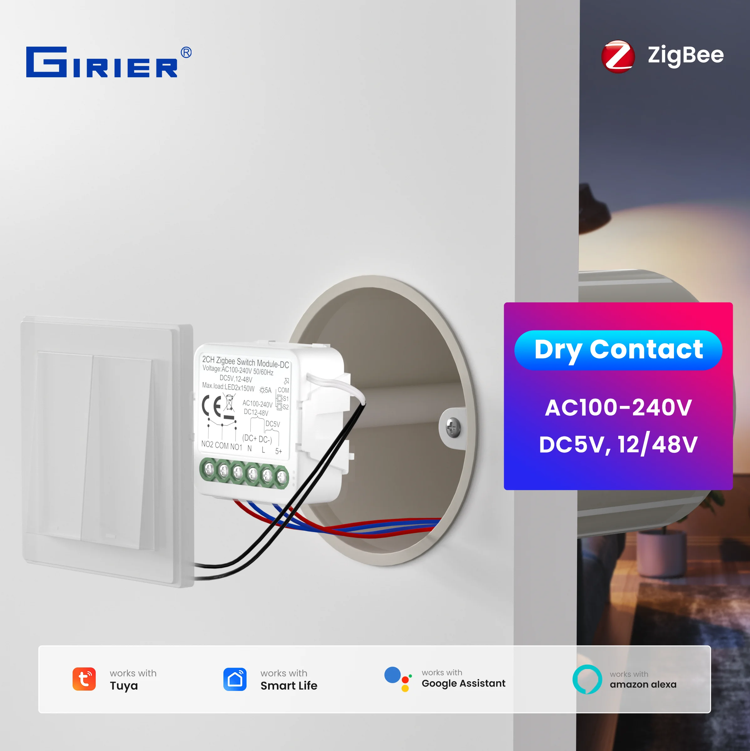

Ok in doing more research based on my understanding now of needing a “dry contact relay” I have found I think an option which also includes my desire to have it run on low voltage DC (so can power via POE) but also ability to be in the Tuya Ecosystem as like to not have to bridge things between technologies where it isn’t needed and have discovered Shelly and Sonoff are their own locked systems (mostly).
If someone is able to confirm my theory I would appreciate it. Many Thanks.

The Arlec ones I recommended also have dry contacts inside their switched relays, and onboard power supplies. Same size as standard wall switch and a drop-in replacement. No POE wiring needed. Don’t over-complicate things and have to pull added cable, especially if it is behind walls filled with insulation like is common in more modern houses in Australia, and the yellow-tongue gets stuck on the noggins. If the slimline aspect is an issue, just replace it with a blank cover and install the new one adjacent in the wall - the wires should stretch. Remember you are paying your sparky by the hour, and the time required to simply swap over a familiar looking switch with another that also looks similar and just move the existing wires to the new unit, compared to reading Chinglish instructions and pulling added power wires is going to quickly sway the financial aspect.
You will find as you research even further that most automation light and power switches have a relay with dry contacts, as it is the cheapest way of switching mains power reliably and in a small package.
You do realise whatever device you connect, behind the wall or not, dry contacts or not, you will still be connecting the mains power to switch it, and the electrical connection work will need to be done by an electrician?

Both devices you have referenced sourced from AliExpress may not have the obligatory RCM certification, confirming your thoughts that no matter how attractive they may be in price, no electrician that is legally required to issue a certificate is going to risk losing his career by installing it.

However in researching what you have stated about the RCM mark etc. which I am aware of from my previous industry background I didn’t think it would apply. In doing a bit more research it appears that given it would be powered by USB or low voltage DC that kind of means it can be utilised (although is in breach technically of ACMA due to the radio side but from a safety compliance perspective I believe I am all good).
Due to the low voltage and not looking to wire the light directly to it there is no contact with mains voltage and therefore no need for Electrician certification etc. It appears the key requirement for insurance and safety regulation is that it is attached to a RCM marked power supply. It is really no different to running a POE network cable for a security camera really (with the exception of the zigbee radio transmitter and ACMA).
If that is really the only issue but looks like it will function I will plan to proceed.
