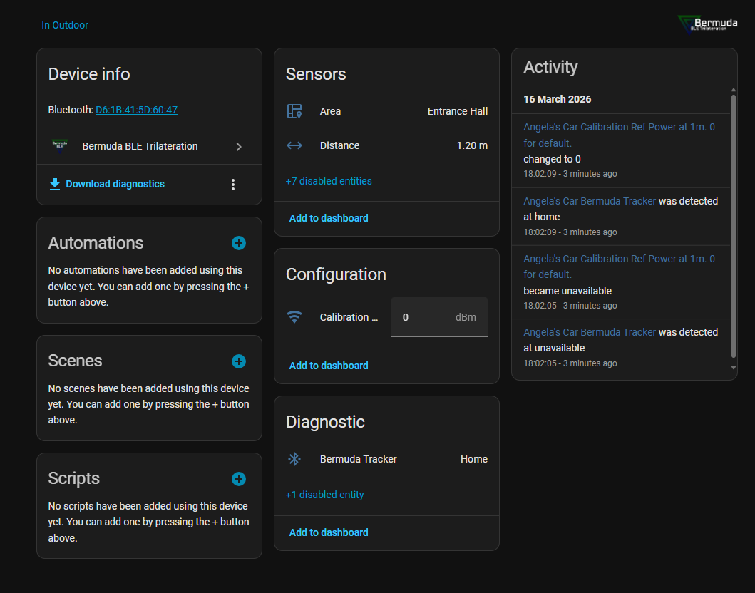

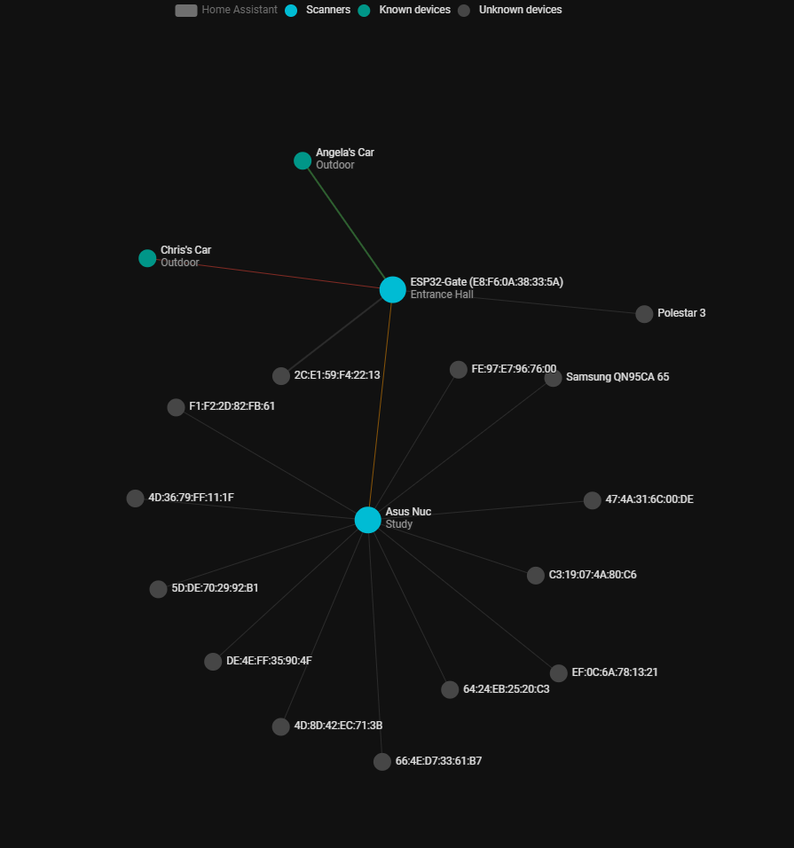

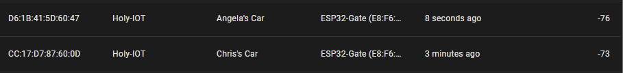

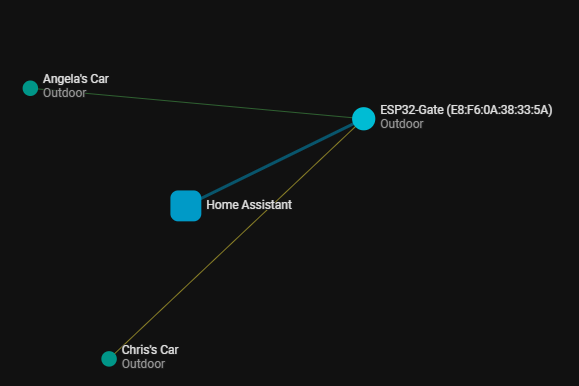

I have set up an ESP32 as a bluetooth proxy that I was going to mount adjacent to the gate. I have also set up two beacons (Angela’s Car and Chris’ Car) to install in family members cars. Home assistant can see these under Bluetooth network visualisation as below

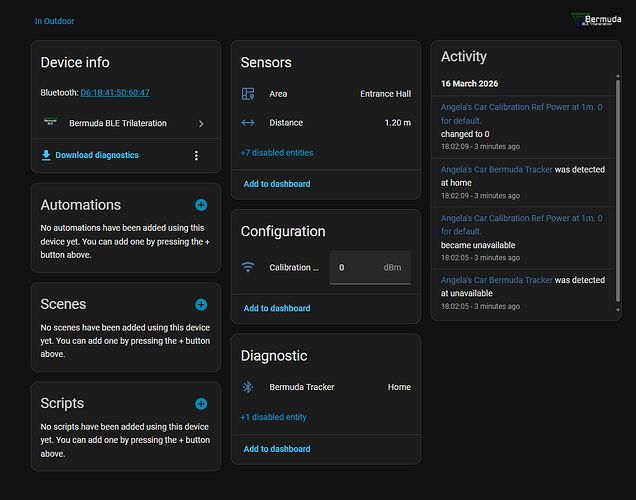

Both beacons are being reported firstly as “At Home” and then several minutes later as “Away”.
I am not sure what I need to do in the setup to be accurately detect their presence and from that, link a routine that operates the gate. I am wondering now if a single proxy is not enough and I need more than one proxy to achieve this?
At the moment a beacon in the same location as the proxy is showing as 1.2 to 1.7m away which is roughly correct but I think I need to calibrate this? Do I need to set a distance of more than say 10m away as being “Away” and anything les “at Home” If so where do I adjust this in Bermuda or in ESP32 Home?

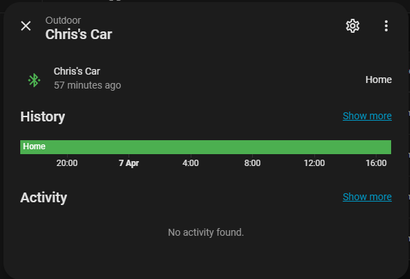

OK so I have installed iBeacon Tracker integration and think I am nearly there but need help configuring “Home” and “Away” and how to use these to trigger an automation that will open the gate.
I’ve got an esp32 flashed to be a bluetooth proxy ESP32-Gate and two BLE tokens Chris’s Car and Angela’s Car these can both be seen in the bluetooth map. (Although Angela’s Car doesn’t show as an iBeacon?)
Both BLE beacons are configured
and settings are configurable
and active

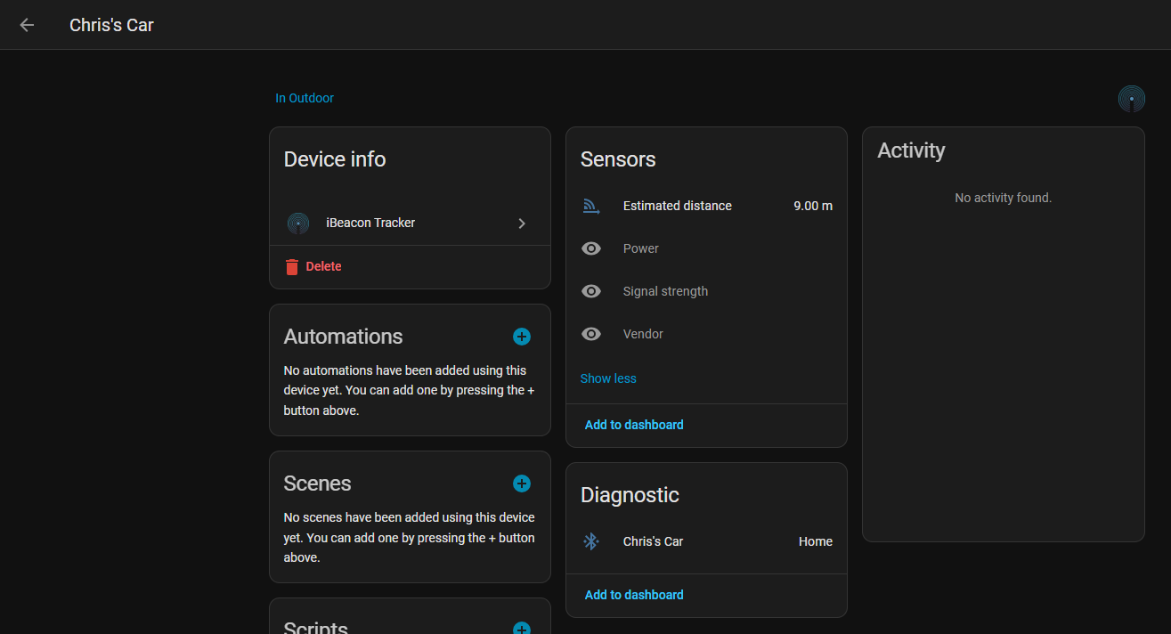

As presence is determined by RSSI strength is this used or is it estimated distance? Where in BLE Tracker or the iBeacon device(s) do I configure a numeric number to dictate Home (less than??) and Away (more than?)

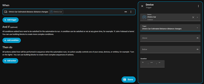

If I select Add automation from Chris’s car iBeacon I get the following
Is this where I enter a distance in the below field?? Should I enter a time period? Should I also add a condition? with the iBeacon approximately 3m from the BT proxy the distance shown is 7.00m what is a safe figure to enter?
