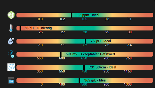

Finally got it working with your help here and xZetsubou Tuya integration and custom:pool-monitor-card.
Thanks a lot!

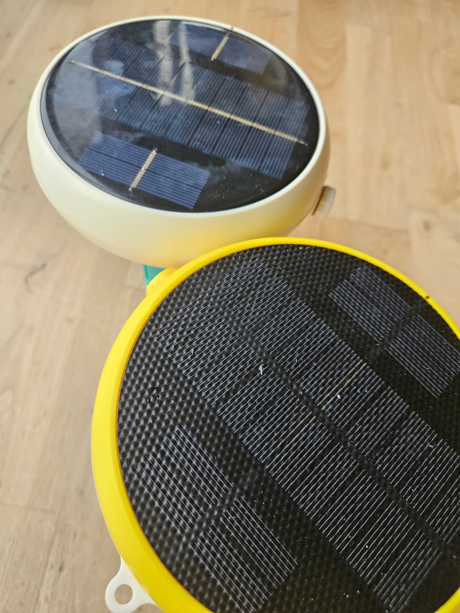

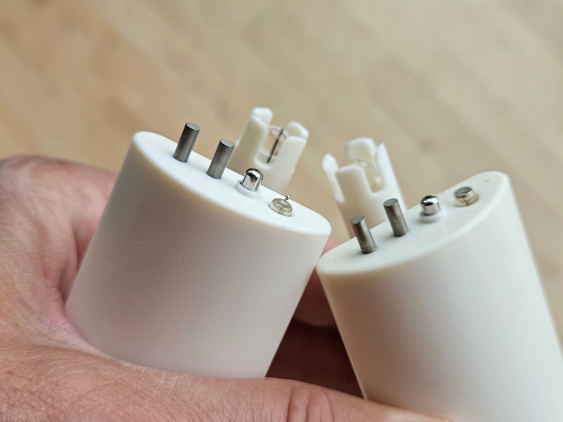

Finally I have got the new “yellow” device. It seems that probes are different / upgraded. So fotovoltaics. Measurements look correct so far.

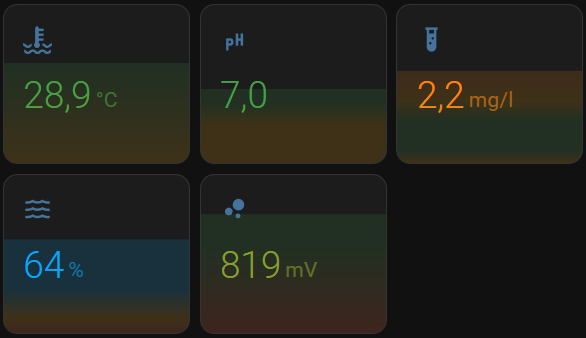

I bought the new version that is the yellow one, but my ORP readings were never high and I never got the chlorine value above 0.1. The other functions worked well. However, the ph stopped working. The chlorine-free doctor is correct, did you check with any other test?
Check your device if it is not flooded. I resealed all I can on my new device as I flooded previous one. I highly recommend to reseal specially the PH probe which can be replaced! I used silicone…
