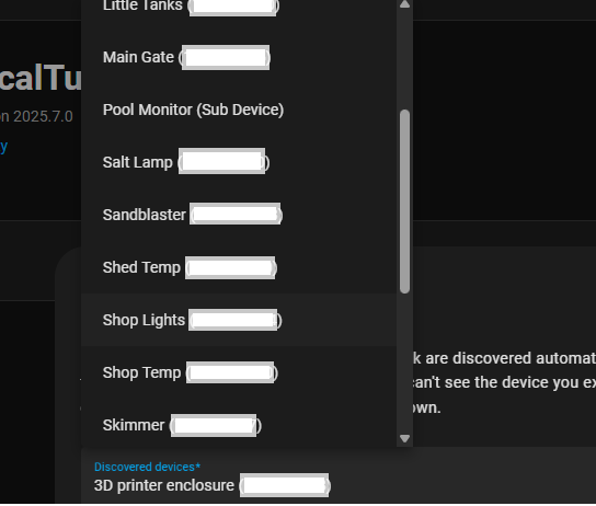

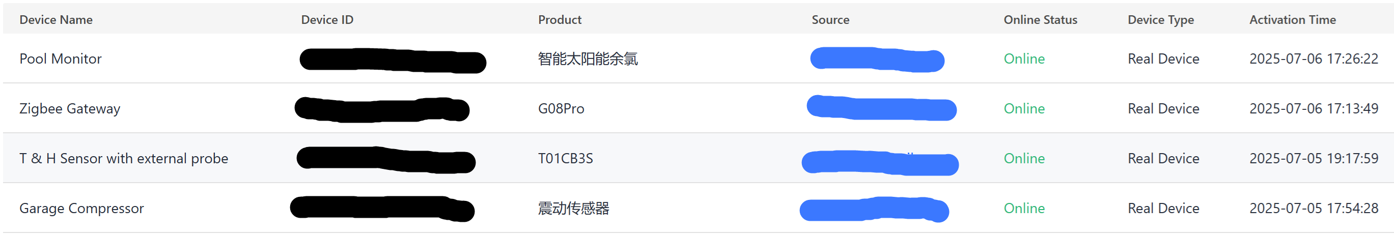

OK, I’m having a heck of a time getting this going - I’ve followed all the instructions, I have this version of Local Tuya installed but when I go to add a device, NOTHING shows up. It just says ā€œadd manuallyā€ - even though in the developer portal, I see all the devices associated with the application.

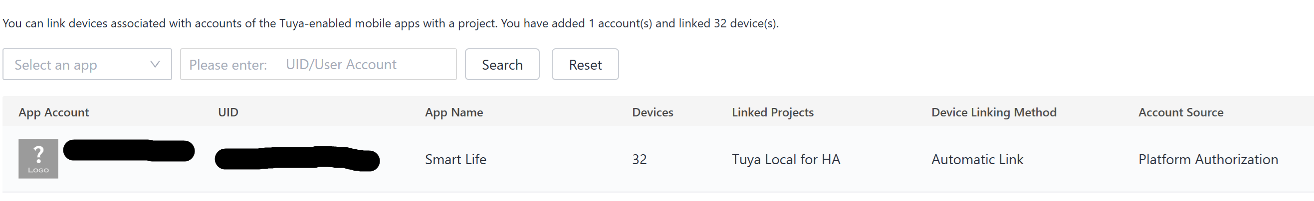

I’ve added the cloud API account (again, followed the instructions) and added that, it seemed to go through properly (localtuya is the userID at the bottom, I wasn’t sure if that was right.) In the developer portal, my devices all show up under the cloud project and everything seems to show up right? I’ve got the SmartLife app linked to the project as well. I’ve got the UID from the App Account page correctly added too.
I can query the devices (in the portal) and even get the local key (I went down an unnecessary rabbit hole on that one turns out) but I was able to add the gateway that I got with the unit manually, but of course it has a local key when I query it - the pool monitor does not have a local key…
I don’t know what I’m doing wrong here - again, I followed the instructions, the integration went through and I’m connected, but when I go to add a device… it just says ā€œadd manuallyā€ and no devices found. From the videos I’ve seen, all my devices should just show up and I should be able to just add them, right?

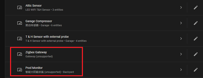

Oh, and the pool monitor and Zigbee gateway both show as ā€œunsupportedā€ of course.

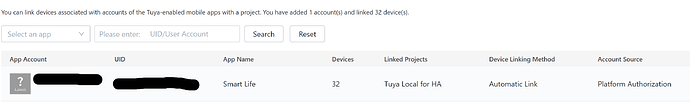

In the developer plattfform; devices show up:
Linked app account:

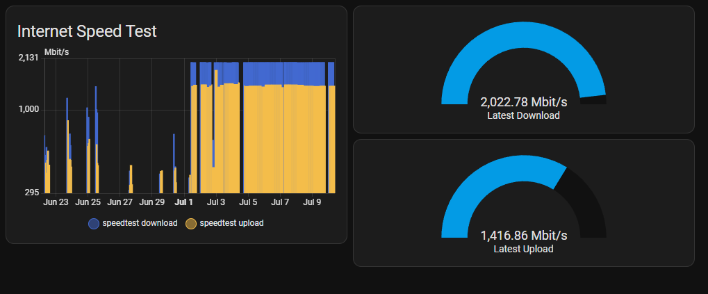

I’m running my HA on an old Gigabyte BRIX machine (i5, 16gb, 1tb) and it runs great… maybe overkill? I’d rather have overkill and it last 10+ years than too short of course. That being said, I have a USB 3.2 g1 ethernet adapter for the 2.5gb connection to the internet so it can run a proper speed test (I have 2gb fiber.) However I have the built-in ethernet (1gb) wide open, so I set it up on my software defined network (SDN) to connect to the same VLAN as my IoT.
Problem is, I don’t want a gateway as I only want traffic to go through the 2.5gb interface (so it will do speedtests and show up with 2gb) and not through the 1gb interface. The GUI won’t let you add a static address without a gateway so the trick is to go in the terminal and manually specify an IP address but simply omit adding a gateway.
Now my speedtest still shows 2+gb AND my devices magically showed up!!

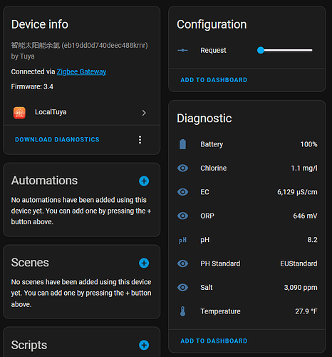

OK, I got it pulled in! However the temperature is showing in Celcius and I need it to be in Farenheit.
Anyone know how to convert it? I tried this bit of code in the template to no avail:
It still shows the value in C but the unit of measurement is F.
