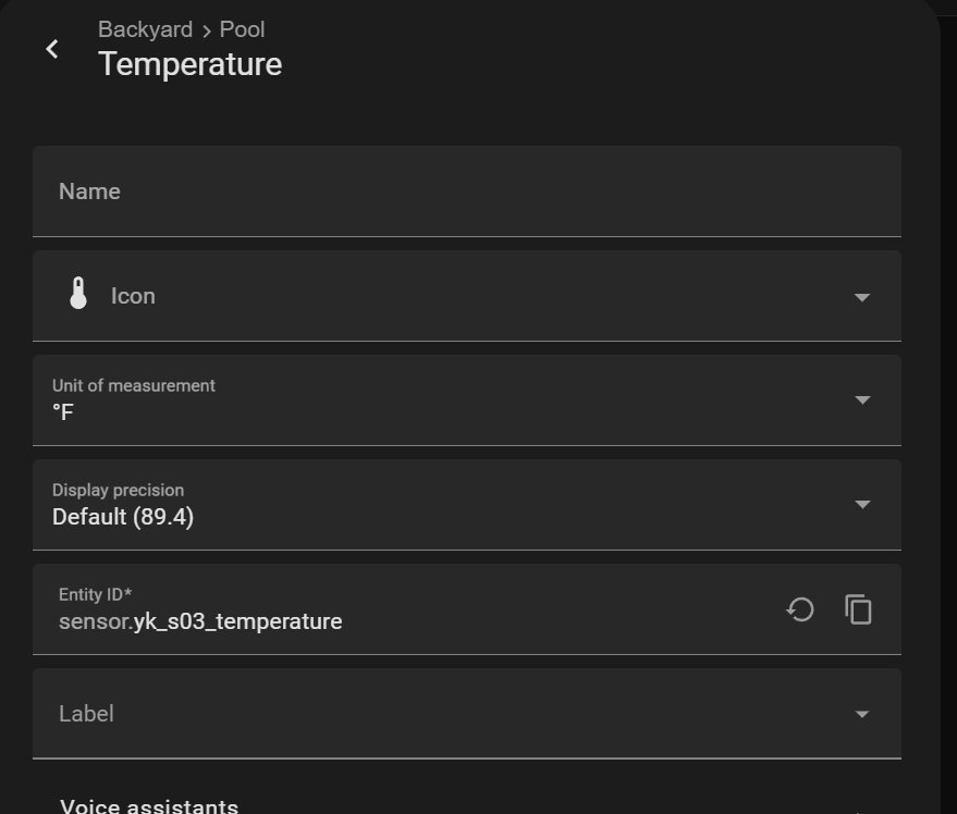

Why not just use the dropdown and set unit of measurement to F. Home assistant will do conversions for you.
I was fiddling with the YAML and didn’t realize you could do that! Thank you! That fixed it without any fancy coding.

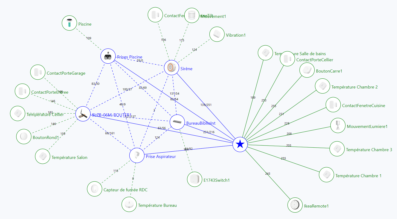

I now get good coverage for my far away sensors, unfortunately some Aqara sensors are loosing the link without notice, even if these are just lying 1m away of the coordinator, but that’s another story.
So, the pool sensor at first didn’t report any values. I thought I’d let it overnight so the Zigbee network arranges it self with all these new devices.
So, this morning I discovered the pool sensor did report some values in the night, but stopped reporting. It’s been 6 hours without any report. While I was writing this text, I just saw the values did update 5 minutes ago. Now waited, no update since 15 minutes.
Here is a graph oh my Zigbee network where I see there should be no signal issue:
