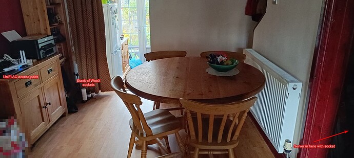

I’ve noticed that the WooX plugs struggle with their Wi-Fi connection and often drop offline so can’t be remotely controlled/monitored. Not overly worried about it but this weekend I happen to have a UniFi AC mesh device for a client. I’m not familiar with this particularly model so decided to configure it at home before installing. I took the opportunity to do some tests.
This is the “lab”! Access point there on the left, stack of sockets on the floor nearby and a server just off to the right. The ones on the floor report good signal (should think so too, they’re 1m away). The server one is poor - UniFi controller reports -73dB which matches poor. Okay so there’s a table, that radiator might not help but the wall is “only” brick. I’ve put my mobile on top of the Wi-Fi socket and it’s got a signal of -57dB. If you’ve ever dabbled in Wi-Fi signals, you know there is a big difference between -57db and -73db.
So kind of backing up my proposal the WooX sockets have a pretty naff Wi-Fi implementation. They’re single channel (MIMO 1x1) but that’s fine. Plus the supplemental question I guess of any recommendations for Wi-Fi sockets with better Wi-Fi?
-30 to -70 is a real optimal range with the latter being the cut off limit for me, so if they are loosing connection when other devices are not then yes its an issue with the hardware and firmware of those sockets.

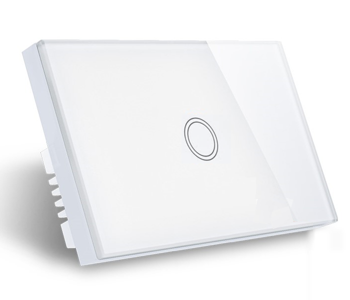

I am currently using these ones:
All of them are the 1 gang with a 2 gang for the kitchen and light next to it in the lounge room with how the wiring is in my home and it only being a 2 wire setup at each point for live and active.
Very nice looking. Unfortunately, I’m in the US and will have to do more research into a locally available solution.
