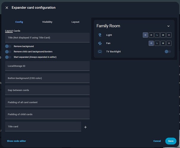

There are various pop dialog windows, e.g.
Some, like the Card Configuration dialog above, can be expanded width-wise by double clicking on the header text, but most cannot.
Is there a setting or where can I modify code to adjust the default width of these various pop windows?

One that I would like to widen is the Helper creation dialog.
I want to make these dialogs wide by default, it is time consuming when I’m making a lot of back and forth edits and an extra click is needed every time to widen those that allow it.
I’m hoping to find a setting or values in ccs/html/etc that I can modify to make dialogs full width by default.
