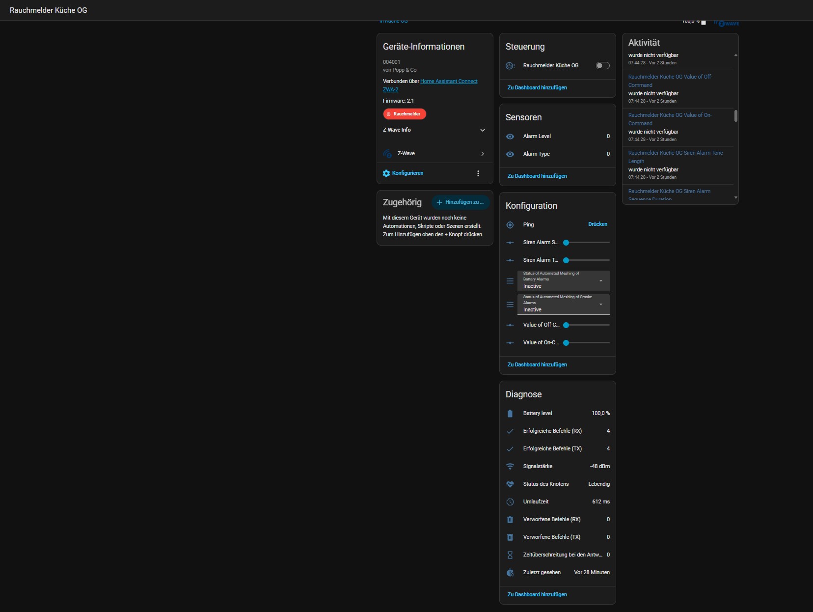

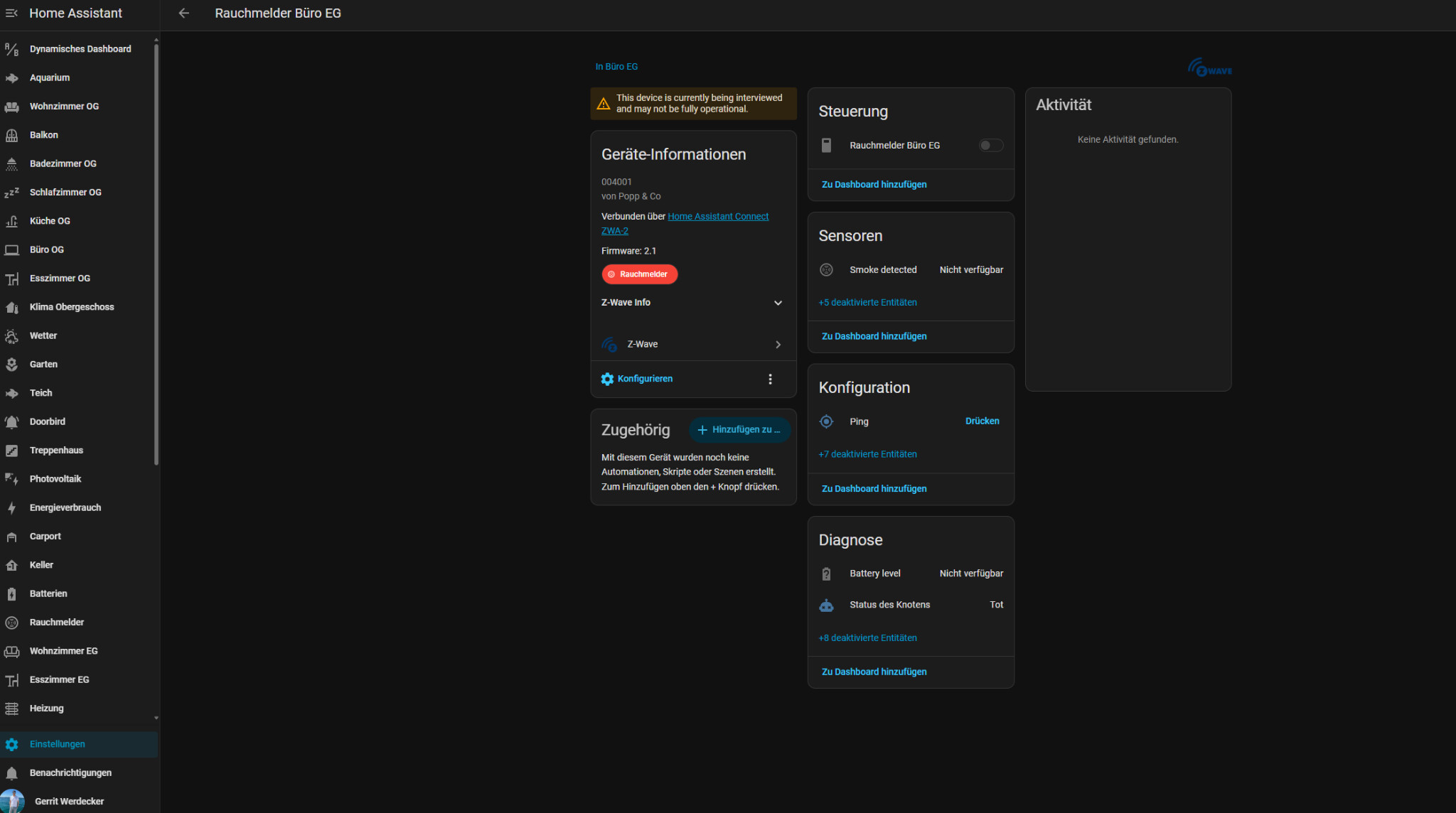

I have multiple POPP 004001 smoke detectors included in my Z-Wave network.
The smoke detectors are periodically marked as Dead/Unavailable by Z-Wave JS, although they usually come back online automatically after some time without any user interaction.
Sometimes they also recover immediately after pressing the test button, but most of the time they recover on their own.
The issue affects multiple POPP smoke detectors, not just a single device.

Actual behavior
The smoke detectors are periodically marked as dead/unavailable.
After several minutes or even hours they become available again without re-inclusion or manual repair.

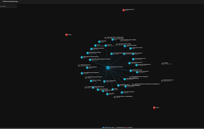

Network information
  • Approximately 46 Z-Wave devices
  • Many mains-powered routing devices:
    • Shelly Wave
    • Shelly Wave Plus
    • Fibaro Roller Shutter
    • Fibaro Switches
    • Devolo Alarm Siren
  • Mesh coverage is good throughout the house.
  • Other battery-powered devices (Fibaro Motion Sensors, Aeotec MultiSensor, etc.) appear to be much more stable.

The Home Assistant Connect ZWA-2 occasionally reports its status as "Jammed" , then shortly afterwards returns to "Ready" .
I am not sure whether this is related.
