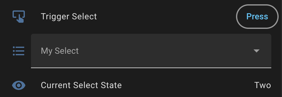

Possible to get a template select to refresh when initialized?
I have a select template where the options (One, Two, Three) and state (Two) are set by a trigger (a button press).
The first time I press the button the select’s state is updated, but the select UI doesn’t show the current state.

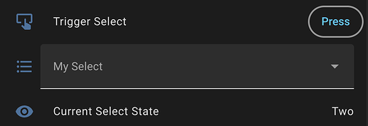

Notice that the button was pressed and the current state is ‘Two’, but the select doesn’t show that state.
Now, once a selection is made in the drop-down, say ‘Three’, then pressing the button will update the UI to show ‘Two’.
Is there a trick to get that select UI to update when first triggered?
Here are the entities:
template:
  - button:
      - name: Trigger Select
        press:
          - event: update_my_select
            event_data:
              options: "{{ ['One', 'Two','Three'] }}"
              state: "{{ 'Two' }}"
  - triggers:
      - trigger: event
        event_type: update_my_select
    select:
      - name: My Select
        options: "{{ trigger.event.data.options }}"
        state: "{{ trigger.event.data.state }}"
        optimistic: true
        select_option:
          - action: system_log.write
              message: Select option '{{ option }}'
    actions:
          message: Triggered
  - sensor:
      - name: Current Select State
        state: "{{ states('select.my_select') }}"
Oh, this was fixed in 2026.3.0b0. As was making select_option no longer required! (Thank you @petro for this, and I was hoping that select_option could be made optional.)
