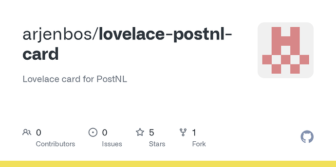

UPDATE June 2024
PostNL is back working thanks to the work by @arjenbos
Check out his Github repository, which contains instructions on how to install the component:
