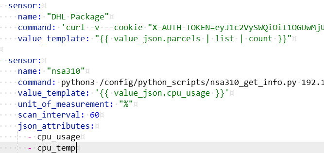

thank you, now I managed to get the sensor but strggling with my already existing sensor in command_line.
dumb question: do you know how I get this right ?
It’s probably a yaml/indentation error. See the docs (Command line - Home Assistant), you’ll probably need to use:
# Example configuration.yaml entry
command_line:
  - sensor:
      command: SENSOR_COMMAND
  - sensor:
      command: SENSOR_COMMAND_2
Try it directly from configuration.yaml first and then include.
remove the “sensor:” from line 8
unfortunately didn’t work
but this was for me the solution:
both solutions unfortunately didn’t work

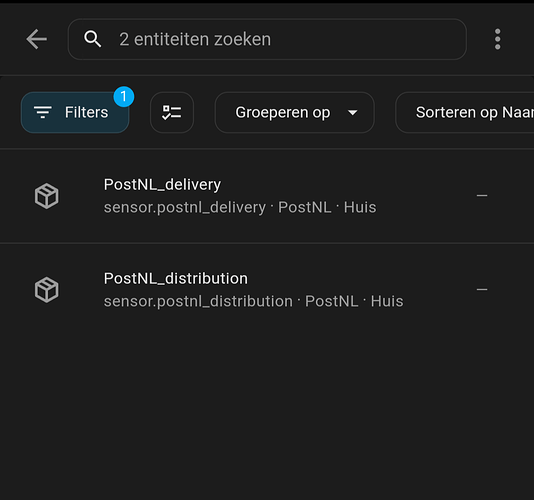

But don’t see the entity for the letters.

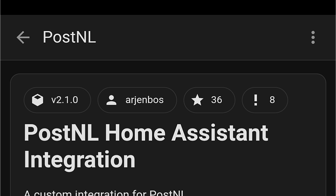

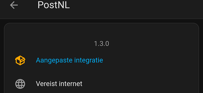

Now wonder if I got right package installed
See as hacs:
So version 2.1.0 is installed?
But at the postnl integration
Here it says 1.3.0
Did Install postnl at hacs with the url.
Why i don’t see letters… Even entity is not there.
Got only 2.
sensor.postnl_letters is not showing up for me too
