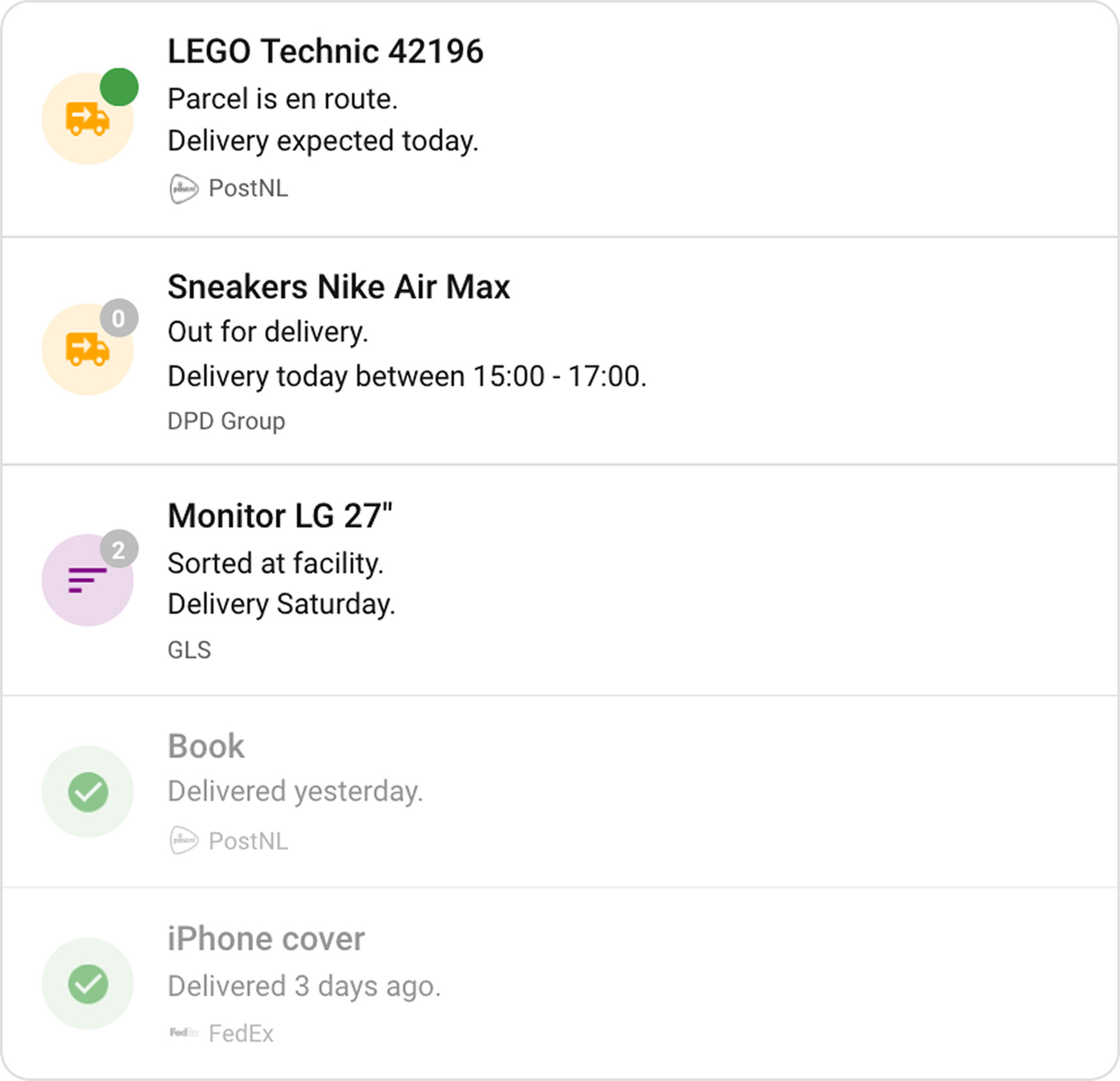

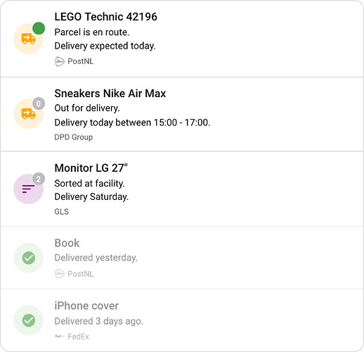

I’ve vibe coded a Lovelace card to track packages: Package Tracker Card. It currently supports both parcel-ha and ha-postnl. Created it for personal use, but it might come in handy for others too.
Wow nice one !
thanks for the contribution!!

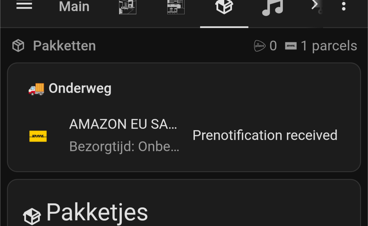

Unfortunately I don’t get the header very clean with this configuration.
Any idea how this is possible?
