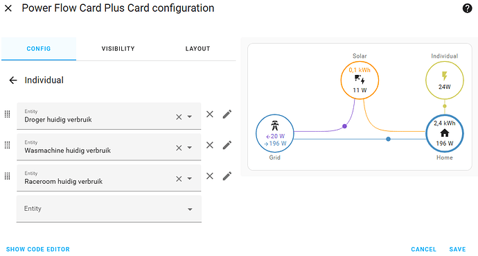

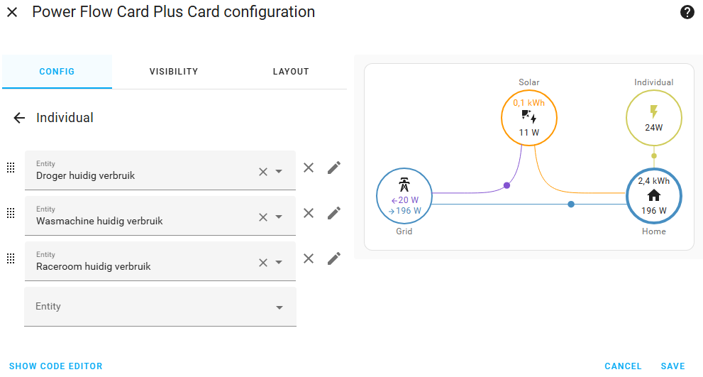

I have added three Individual power sources. But they are all combined in one Individual circle. How can I show them individually?
Have you tried card_mod? This works for me :slight_smile:

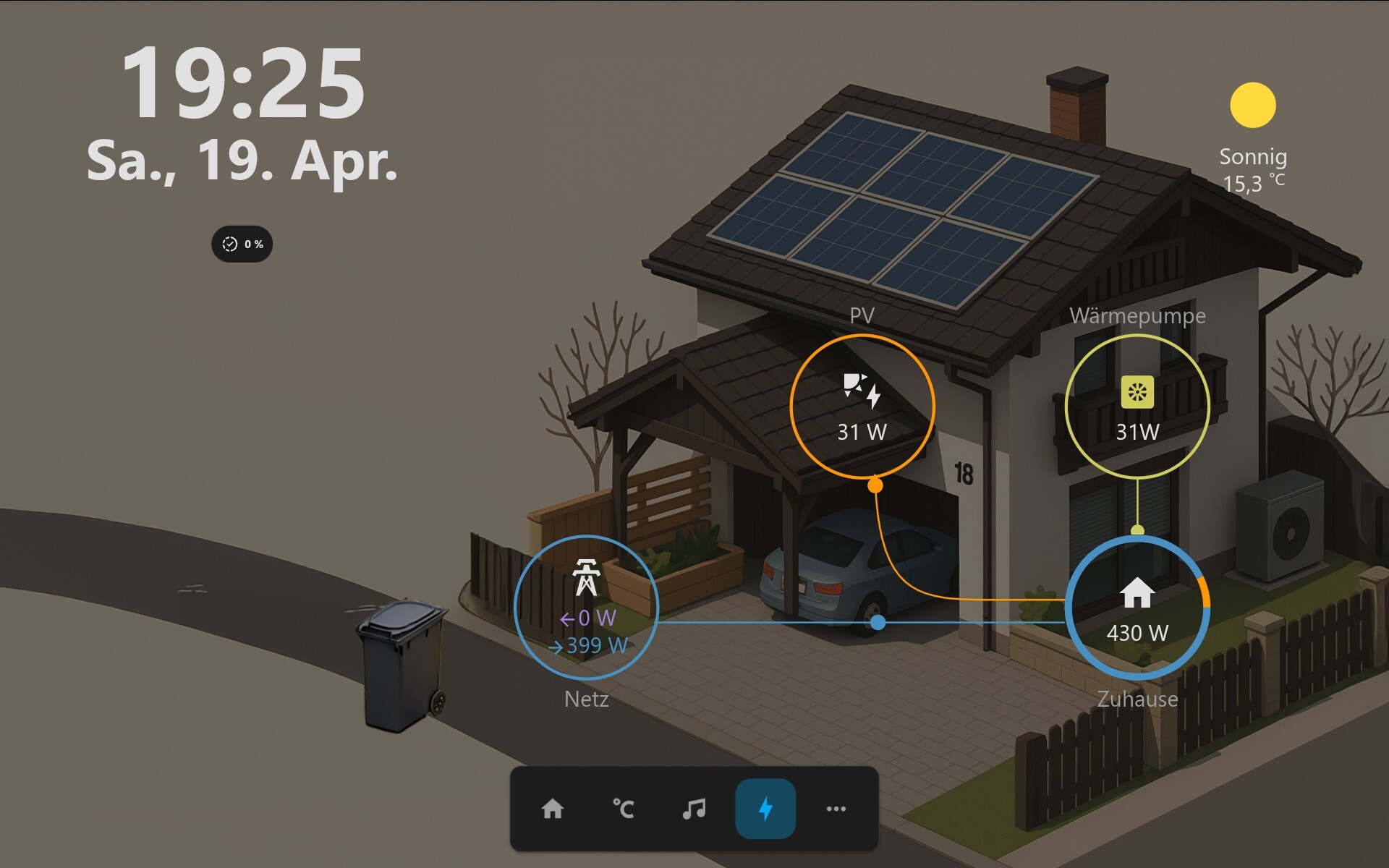

card_mod:
style: |
ha-card {
transform: scale(2.5);
transform-origin: top;
Has anyone successfully repositioned the circles using card_mod? I’d love to place the Solar Circle directly above the roof in my background image, and position the Heatpump Circle accordingly.
