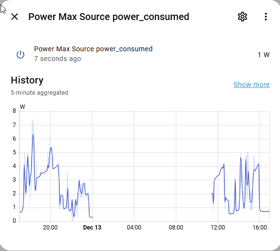

@perosb - latest version 2025.12.1 should detect the scaling of the source sensor, which in my case is kW, but the mimicked sensor does not seem to detect this in my case.
I have uninstalled the integration, and restarted HA, and set it up again, but without any improvement. Any other suggestion, as according to issue#9 this was successfully closed.

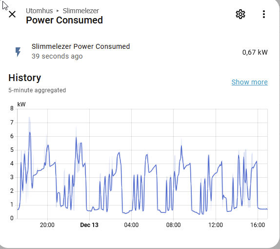

Source sensor, kW:
Mimicked sensor, W:

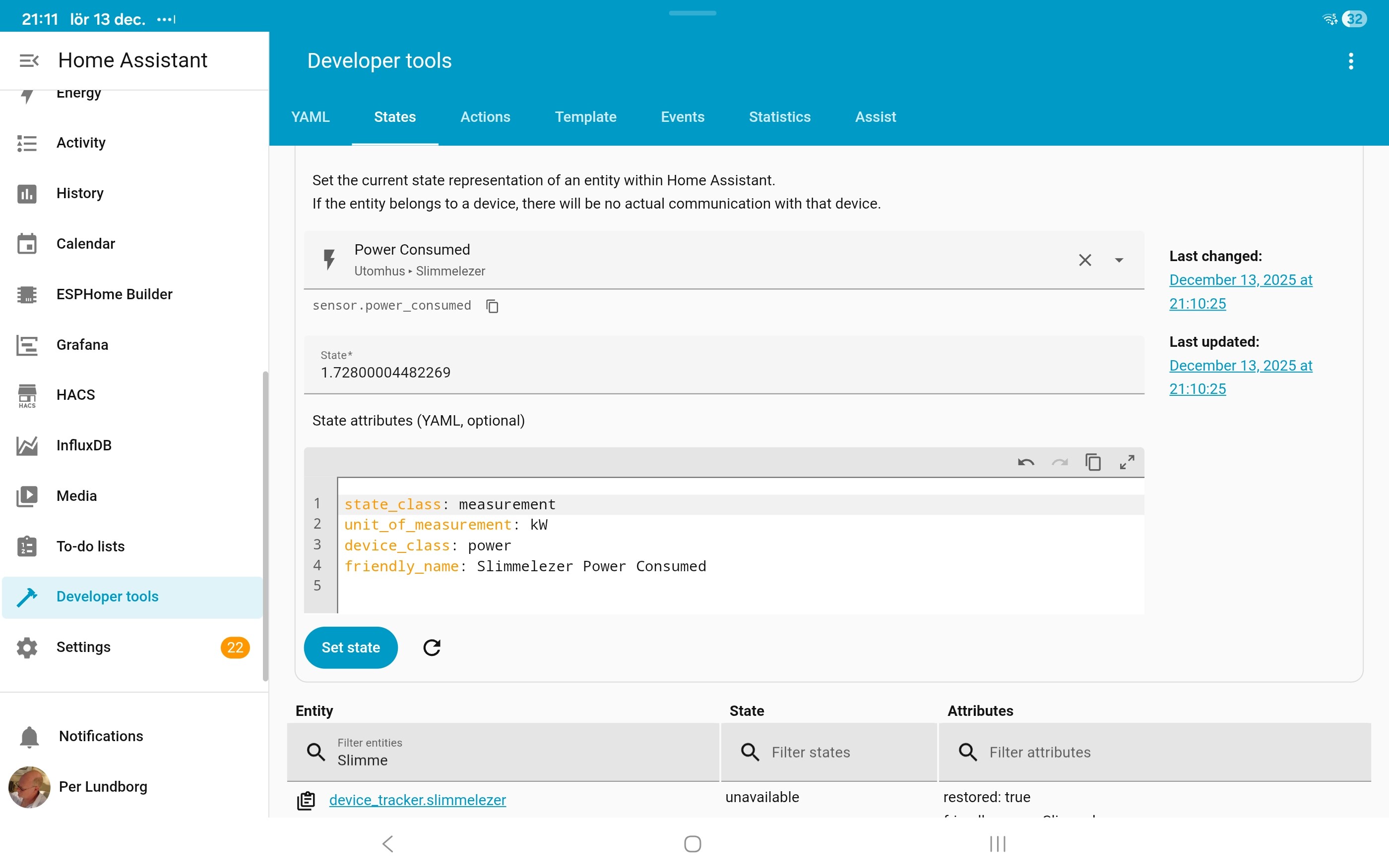

Can you share the attributes of your source sensor?
And also debug log from startup of the integration. It should say something about"Auto detect".
Fyi, you can reconfigure the integration and change the scale factor manually afterwards.
These are the attributes

I have not seen any entry for setting the scaling factory.
My bad, now there is an entry in the settings for a power factor, setting it to 1000 seems to solve the issue.
