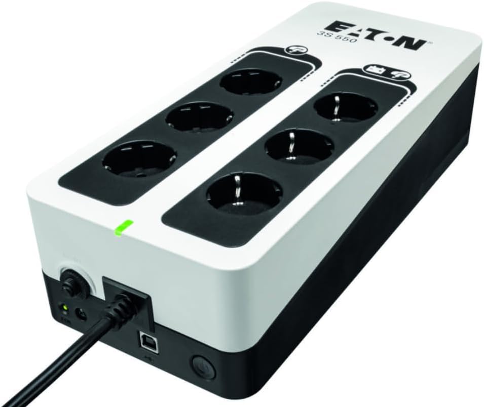

I think we missed the easiest solution to all of this?
Get a cheap UPS and forget about power outages!
edit:
Just re-read your original post and realized — you apparently live in an area where you have power outages that take ages to be fixed?
So I guess my proposed solution wouldn´t work for you, because (depending what you hook up to the UPS) the max. this will run your server is probably an hour or so.
I am not sure how a UPS would solve the problem, even if the outages were shorter.
Since it wouldn’t be sufficient to put the HA server on UPS power, you would also need the pool system on UPS - otherwise when power returns you still need rules to send commands to turn on the pool system - hence you are no better off than letting HA restart and sending the commands when its back online.
HA servers (by itself) are generally low-power, so using (or making ) a decent ups with hours of uptime isn’t too hard. If running on Pi simple 12V 12AH battery will last long time. You don’t have to go “12V → 230V → 5V”, just “12V → 5V” will do. Just one of options is THIS. It’s what i use, together with step-up module to 19V (my Intel nuc wants 19V). It’s even easier if you buy mini PC which runs on 12V
Having “only HA” on UPS can help, since you can create automations in a way that HA knows that power is out and it delays automation until power restores.
Other option is to create “input boolean” helper which automation will set when start, say, Roomba. Then another automation resets it, say, at midnight. By checking this input boolean you’ll know if Roomba has been running today or not.
etc…
An UPS may need some electrical work, as it needs a grounded outlet to work
Which UPS? Most don’t.
Agreed. I didn’t come across one which wouldn’t work without ground. Not that’s a good idea, but it’s not that it wouldn’t work. Honestly, i really don’t see why… ground is for protection only.
True, if you have power outages that last minutes or even hours.
I live in a part of the world, where we had 5 or 6 power outages in the last 25 years.
All except one (which took about 1.5 h) only lasted a max. of 5 seconds.
So I guess you could be unlucky, that the automation would be started exactly in those 5 seconds - but that’s like winning the lottery isn’t it?
But as I said - not a solution if you have a grid that goes for such a long time.
But even under those circumstances it may still make sense to use a UPS, to avoid an uncontrolled stop of the HA server when the power goes?
