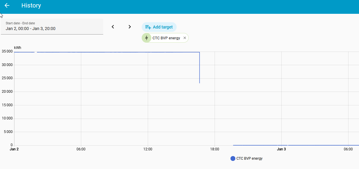

When I replaced the source for my three phase heater, where the target is a PowerCalc group, the group energy as reset to 0.
Initially the group consisted of three separate energy entities, while now my source is three devices (the old entries was made up from an ESP32 solution, now replaced with a Shelly 3-phase reader).
Is there any way that the reset can be un-done, ie by adding a static constant or likewise.

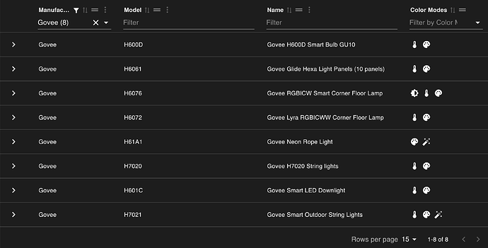

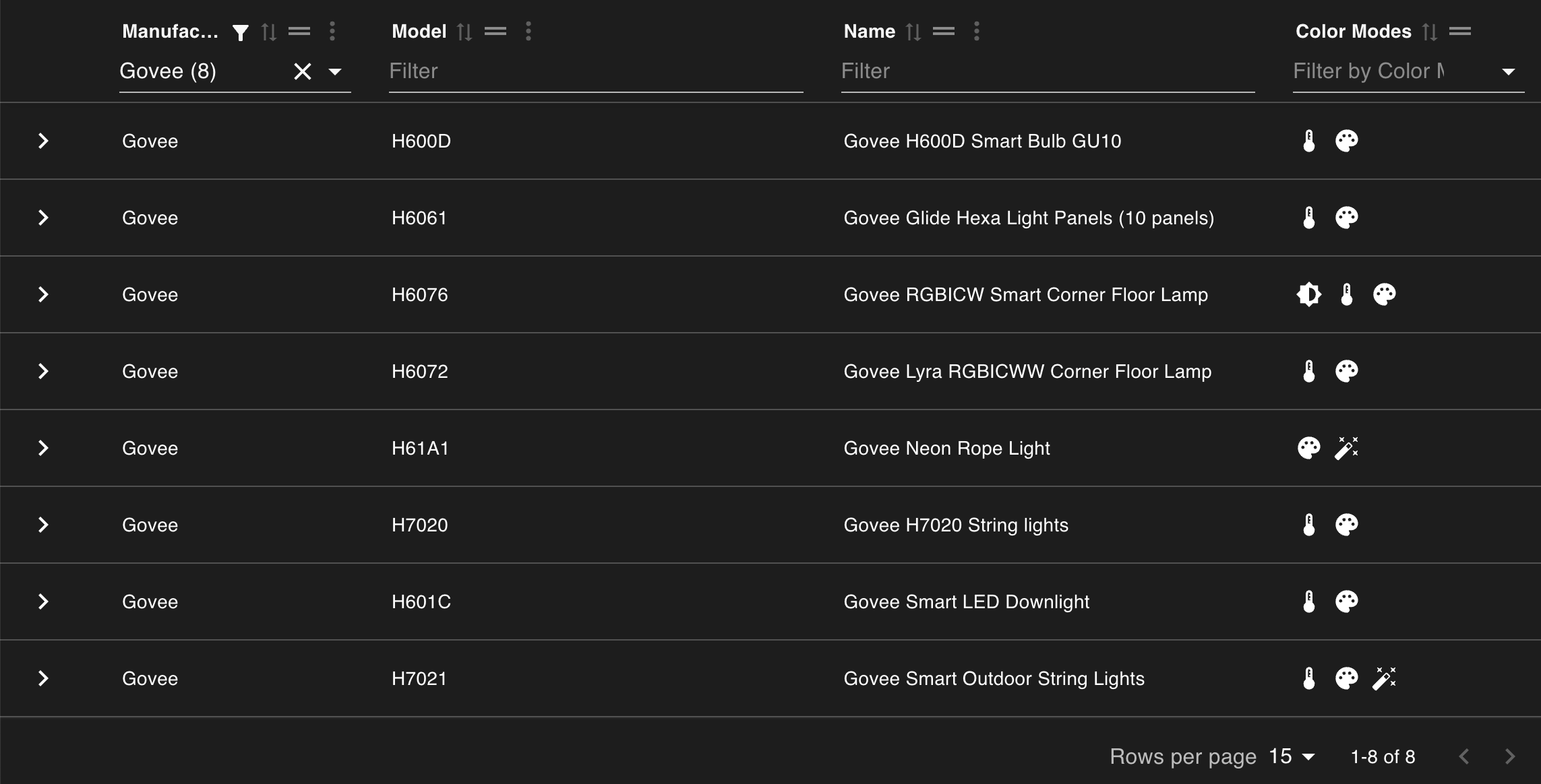

At the moment, only 2 out of the 8 Govee profiles include effect support. These can be recognized by the magic wand icon in the color modes on the Powercalc library website:
So far, there haven’t been any reports from users about Govee power sensors becoming unavailable. That makes me think relatively few users actively use effects, and therefore only a small group would actually be impacted by a missing effect profile.
Ideally, effect measurements should be included for completeness. However, when measuring effects is not feasible for a contributor, I think it’s still very valuable to at least provide measurements for the most commonly used color modes. As long as it’s clearly communicated during setup that effect support is missing, users can make an informed choice to either proceed without effect support or ignore the discovered device.

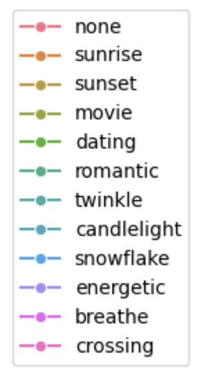

Yes, custom effects will indeed cause the virtual power sensor to become unavailable, simply because Powercalc has no way to estimate the power usage of those effects.
@DevoliaEsp I also noticed that the other two Govee light strip profiles each list 12 effects, which appear to be the default ones. I’m not sure why you’re seeing 306 effects. I’m not a Govee user myself and don’t have much insight into that ecosystem, so I can’t really explain the discrepancy.

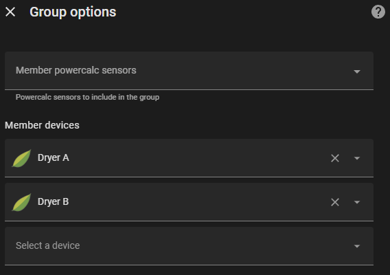

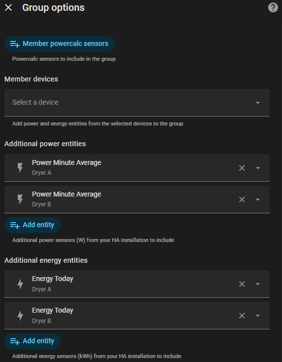

I tried setting up powercalc to group a few emporia panel clamps. My dryer has two legs, A & B. I made a powercalc group:
However, looking at the energy dashboard, the daily energy values for the group are exactly double the values from the individual devices. This has remained the case across multiple other groups and different days. The instant power readings are accurate however.
Is there a different way I should be setting up these groups? Thanks!
I would suggest to first check which actual individual sensors are included in the group. Get Group Entities - Powercalc documentation

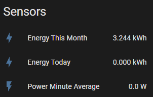

Thank you for pointing me in the right direction! Looks like it was including the monthly sums along with the daily sums. I moved away from including the devices, and am using just the entities instead which seems to have solved the issue.
Glad you got it resolved. You should have a close look in Energy today though, when this is an energy sensor which resets daily this will cause an issue with the powercalc group, as it expects energy sensors which increase indefinitely.
Don’t you have a total energy sensor from the Emporia?
Emporia only exposes daily and monthly energy, along with power. I’ll keep an eye on it. I suspect it should work, since the last few days it was perfectly accurate other than being exactly double which is explained by it summing the daily and monthly. This is only for displaying in the energy dashboard too.
