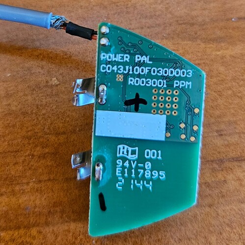

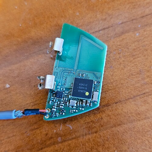

Not a writeup, but here’s the happy snaps I took when I replaced the battery, nRF52840

Many thanks for the clear photos schmttc. The nRF52840 supports Bluetooth Low Energy, Bluetooth mesh, NFC, Thread and Zigbee, so it should be quite easy to adapt to HomeAssistant integration with something like MQTT for data transfer.
USB connection too for firmware updates.
I wonder if the PowerPal developers regret choosing the BLE Protocol with the one session limit which seems to cause so much grief for some, and was possibly the underlying cause for the failure of the rollout of the ESP32/PowerPal Pro project which was abandoned at beta testing stage?
The optical sensor, processor, power supply etc are already matched on the PCB. Maybe we don’t need ESPHome, tortured YAML, and a spare high performance/power guzzling ESP32 after all - just new firmware required to drive it.
