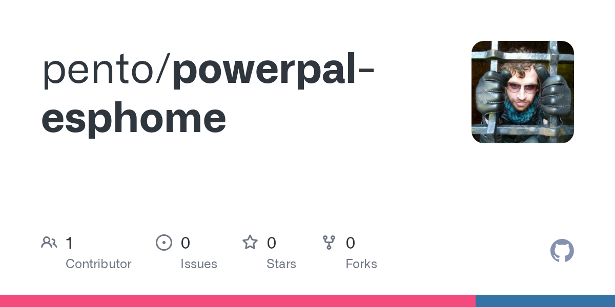

Hey I just spent some time with ChatGPT to throw together a basic integration. I know very little about Home Assistant so any feedback would be appreciated. It requires a BT adapter and directly connects to the device.
Exposes Daily Energy, Power and Total Energy sensors.
I've got it working with live power usage:
It's disabled by default for now, because I don't know what impact it'll have on the Powerpal's battery to have it enabled 24/7. I'm going to leave it running for a few days on my setup and see what happens.

I've just pushed a change to enable the live power updates by default, it can still be disabled by defining live_power: false in the ESPHome device config.

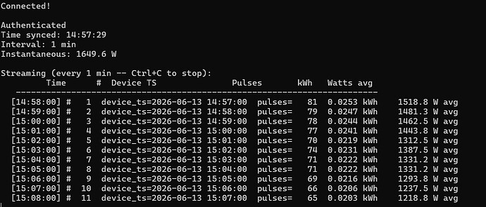

with some help from my friend Claude managed to reverse engineer the powerpal app and have it running linux now. all local. should have a native one to run within HomeAssistant using appdaemon plugin in the next day or two.
