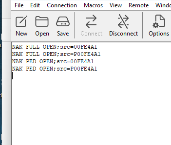

Hi, it does not work for me. When I send commands to the motor always I receive NAK, but as I see on your output you reveice NAK FULL OPEN… (not only NAK)
can you try to resset the wifi module? (press P button 5 seconds and press R button once, the blue led will flash).
After this, can you sniff the TX pin on wifi module without connecting to the motor, I mean, sniff tx and power up the wifi module.
Thanks!
